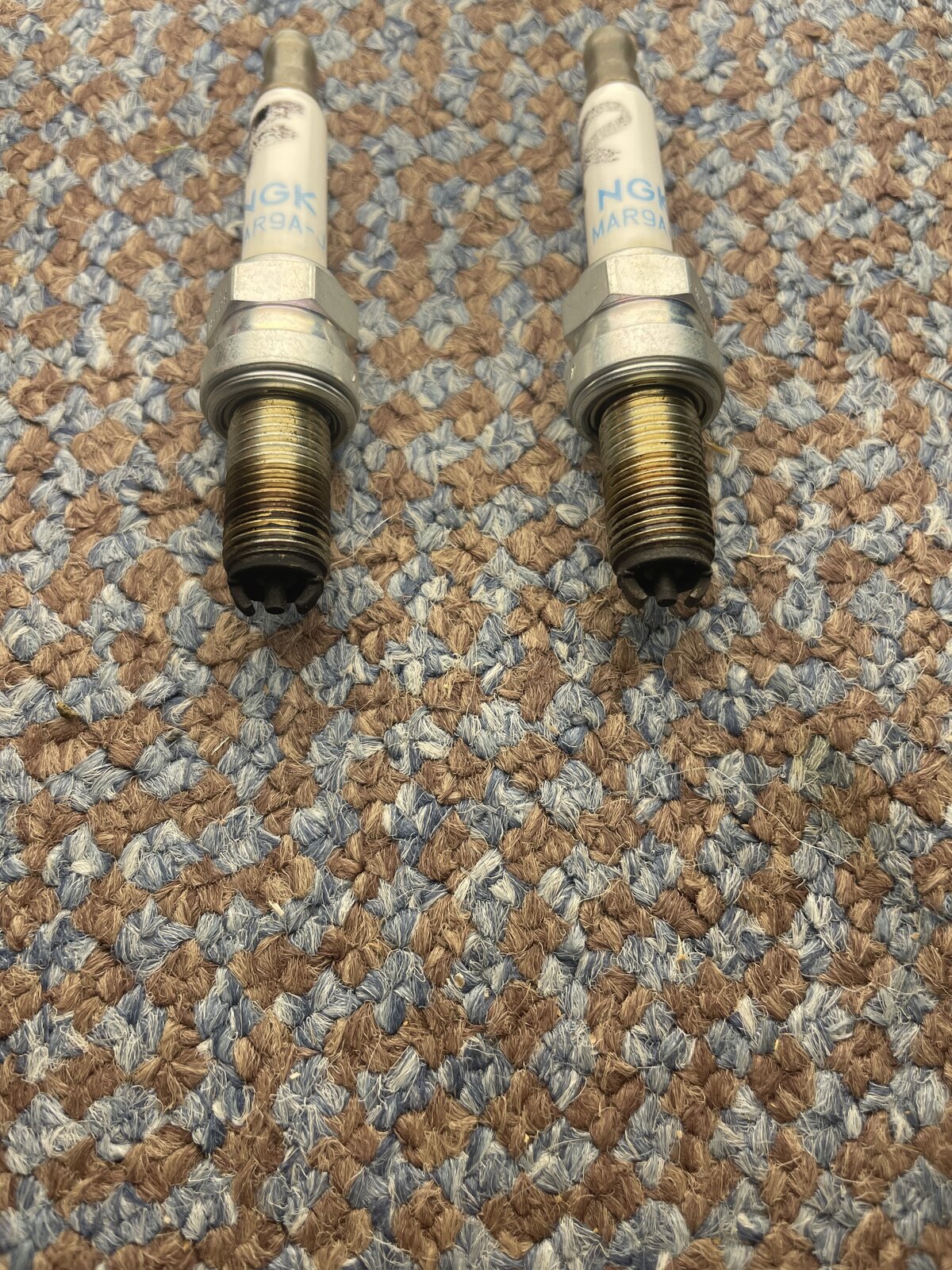

  5. Hi all,
    Turns out the front was firing.
    Rear plug (vertical cylinder) swapped out and she fired straight up.
    Swapped both anyway and I’ve pictured below, how do these look?
    Front cylinder on left, rear cylinder on right.
    Still in the process of putting the bike back together.
  6. @Lindsay McConnell Coincidentally, it was the same on my 899, the V cylinder prevented it starting. Replaced that plug and all fired up nicely but I had an intermittent misfire when riding, so I changed the H cylinder plug.
    Pleased it's going again, must be a relief.

  8. they look a little dirty. carbonated rather than oily it's likely it needs a good thrash to clean them out. Especially if you let it idle with a richer mixture. Could just be me but the gaps look large. But I have no idea what they spec is for Duc's - just comparing my old smoker days
  9. On my 899, the old plugs had a gap of about 0.95mm after 9500 miles. New ones were about 0.6 to 0.7mm if that helps.
