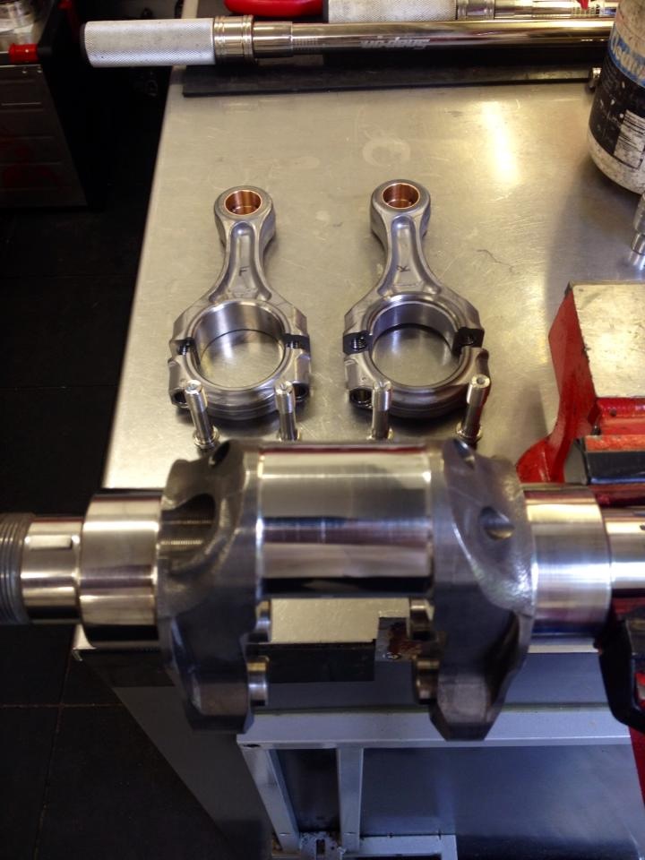

  12. Crank assembly happening today - if I lived near MR I would surely be the biggest pain the ass ever! Just love this stuff. It's great that a UK company can work wonders in engineering and also harness and develop modern developments in electronics. We should be proud of this and whilst MR like to keep a low profile, I for one am proud to be British, proud a British firm and mastermind is behind this project and by eck they deserve the praise!
