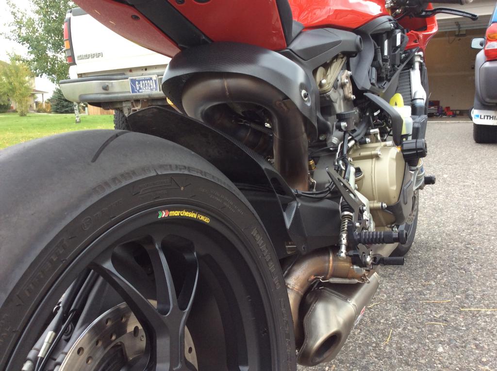

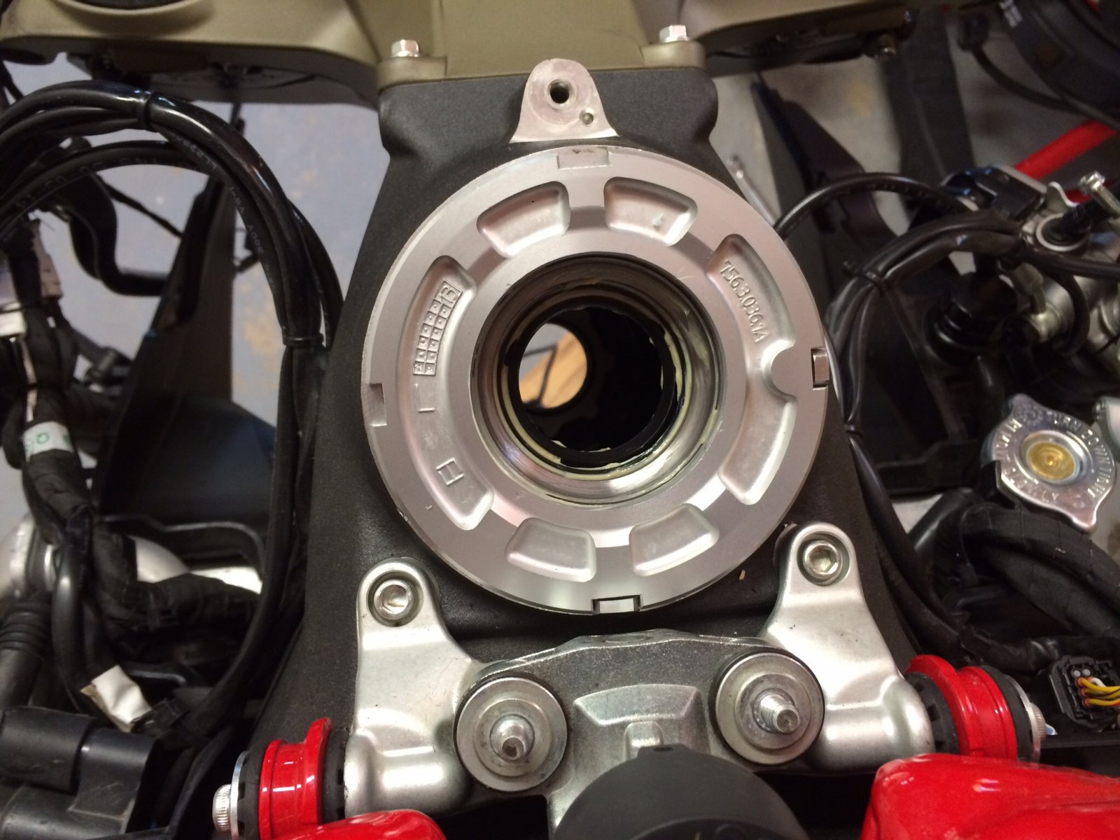

  6. Winter & house purchase completed, couple months ago I installed the 24deg steering bushing inserts, which moves the front wheel rear wards approx 12mm then went to try out the bike only to melt and shirt out the + battery cable against the front STTK header, which killed the bike, lost 5 weeks at the dealer ending needing new chipped ignition switch, no blown fuses cost me $1200 labour & parts. The STTK header bends to the left within 25mm of the starter relay. Since then I have made a temporary fix by re routing the cable until I relocate relay battery & cables.
    Bike steers even quicker with no in stability, well worth the work

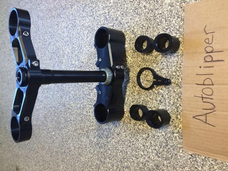

    Next replace triple clamps, picked up these used never installed Roby Moto's
  7. Nice to see pictures of this as I got the dealer to do mine during the service. I was tempted to have a go myself but no idea what I'm doing and didn't want to practice on the Panigale whilst in it's guarantee still.
  8. It's fairly straight forward their is a Raised L on each insert which obviously needs to be on the left side of the bike, however I made the mistake of inserting the lower bush 180 out had to remove and install correctly, nothing like doing the same job twice. PS I also double confirmed afterwards correct install with digital vernier, hole is offset around 1mm from center

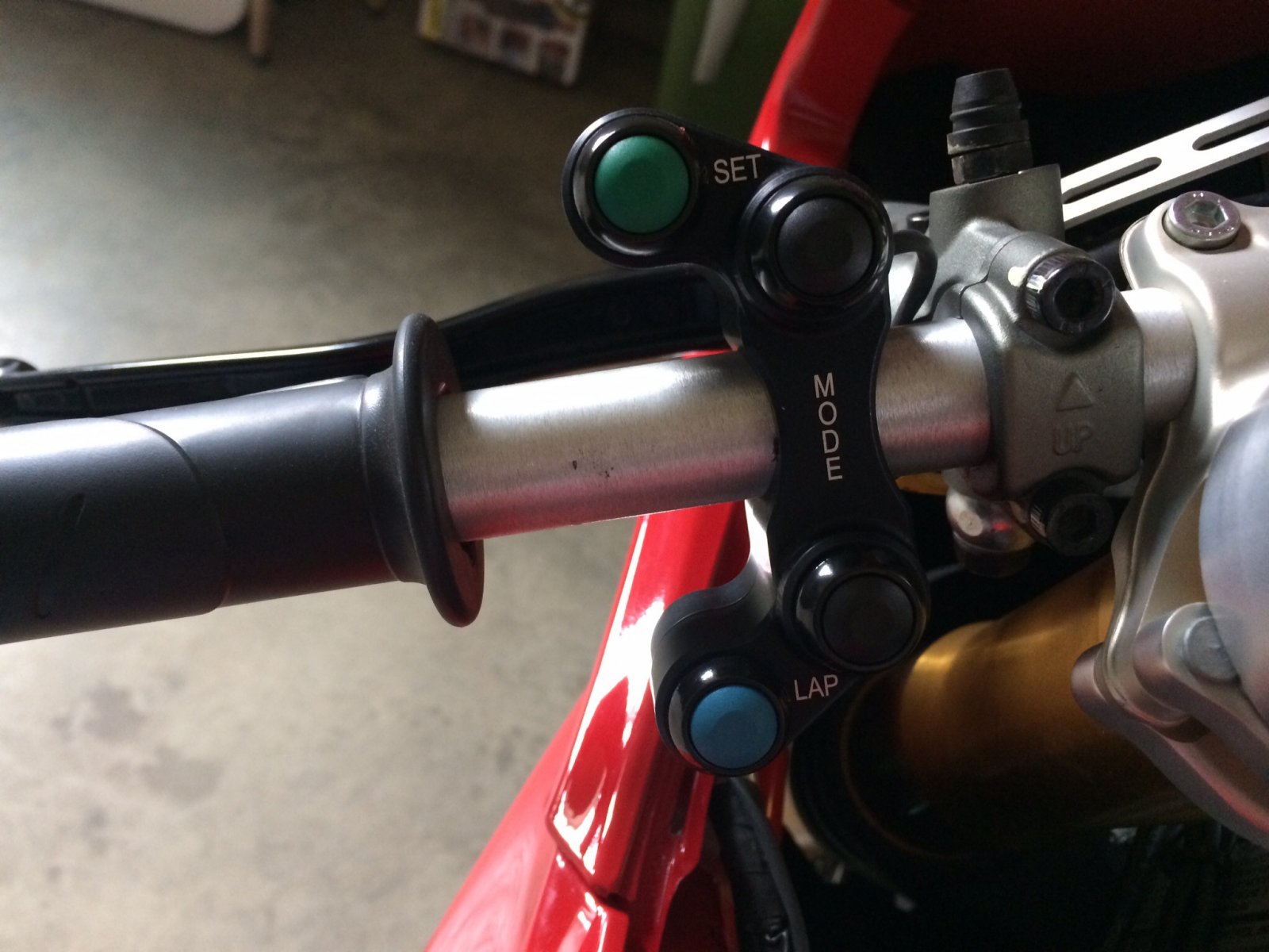

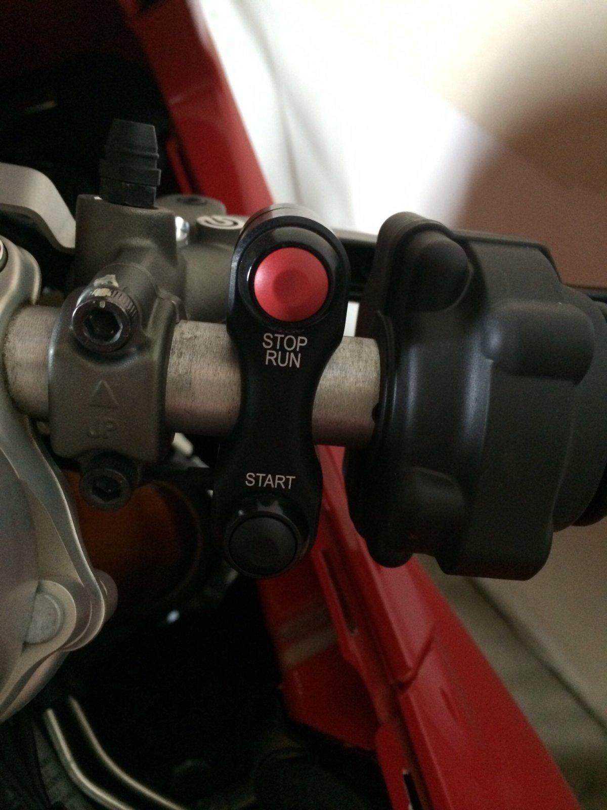

  9. BDS race switches installed, no control of headlight or horn, so I removed the horn, headlight is on fixed low beam, but you can flash the high beam with the set button
