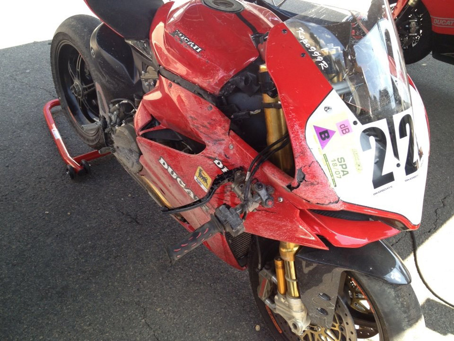

  1. well guys , the weather was astounding! i was less as i lowsided her at Combes ! i guess it was meant to be.. i think rider error as i got pritty close to the inside kerb and the front lost it as we both slid into the Kitty litter... damage is : punctured tank, right side clip on broken, head fairing gone, and the usal scratches ... other side is perfect! :) well, i m no litter virgin anymore and i Always knew it could ( so would ) happen. it got me thinking... is guess we'll end up with the front settings as they were and a stiffer spring... i mnot sure the change was a win and this event did little to improve on condifdance... :) i' ll post some pics soon... i'm fine apart from a bruised finger a bit stiff... now i know wht we carry leathers and a helmet... :)

  6. tx lads , as glid says , it goes with the territory! the bike will be back in top shape will focus on getting her riding again as too many days planned and paid for.. I will get her all nice again this winter... grtz

  8. LOL , very accurate way of describing the experience... :) was big a dent in the day ... especially when i saw fuel dripping from the tank as i realised it was punctured... oouchhh... picked up a set of plastic racing fairing to conclete the season with... found an adress to fix the tank, ilmberger happen to have some racing fairing L/R/top having in stock... so she should be ok by the end of september.. again it was my mistake, clipping the cerb by 10 cm too short... lessons are that i'll go back to the previous setup , stiffening up the suspension, hightening of the damping ( in and out ) to slow her down. Strengthen the rear spring and drop the pivot at - 4... this should calm her down a bit... ultra flickable is good but a bit less flickable and more steady is better... :) .. the impact of setup is huge as i had done a 2:52 without realising it. Now had the pro pipe which is defenatly and improvement and thought to have done well below 2:50.; only to find out that i did do 2:53/54.... so not good. she felt much more nervous.. the pipe is a big improvement. it carries the Moto Rapido setup they had at Knockhill when they won.. the throttle is super mooth and even though it pulls very hard, it does not kick like the uncontrolable mule any more. It's all designed to make yards now... Luc dropped his time another 2 seconds quit easily.. tx to Steve Moore for a top job...pics show a nice start to a fab day, an unscaved left, and some destruction in the right.. got it on gopro so i'll humiliate and give myself some lashes soon ... :) thanks for your sympathy ...
