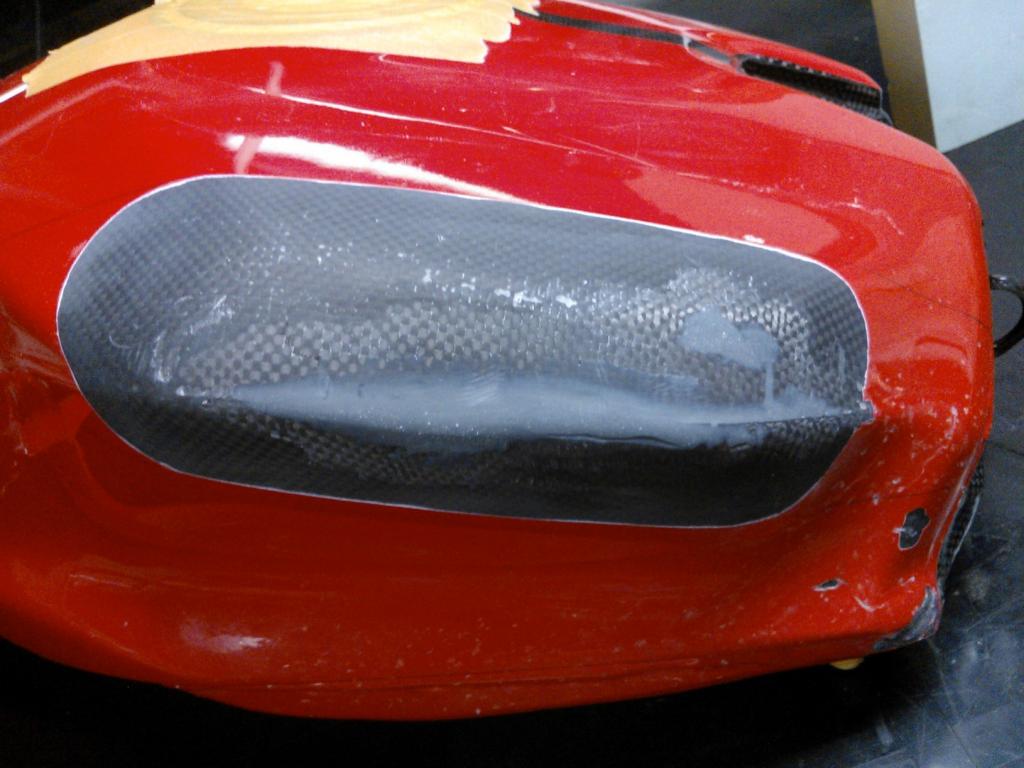

    the tank is in for repairs and a new set of L+R+head fairing is already in ... should be off to the painter in a week or so...

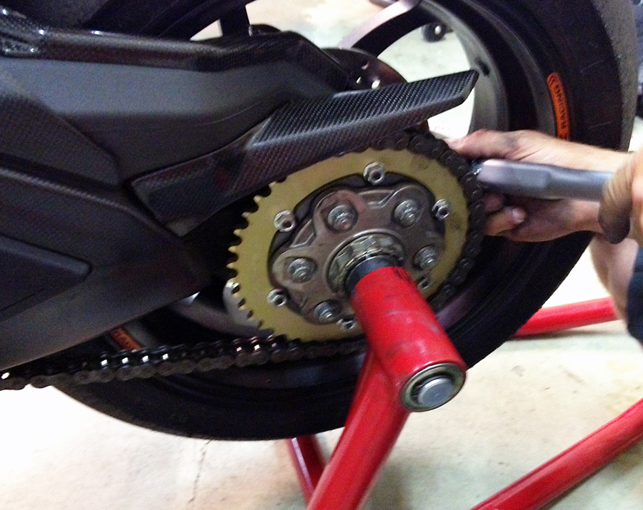

    the bike ran great but then we decided to change the rear sprocket to take it to 42 teeth...
    Man man man , what a change this made.. bye bye dip and welcome the strongest pull i experienced yet... the bike was trandformed. even after loosing 20kg, i'm still at 95kg all dressed so the bike has t o pull some weight... whereas there always some wait for the kick to come, this now is immediate.. there is no more lagging , just an insane pull all the way up to sixth.. even at spa i never hit sixth as it took too long... now at the end of the straight in LM, i went from 256 max to 279 (DDA) or 20kph . the bike now jumps out of corners and hang on the throttle everywhere... the only stop now being the ridicously long throttle ...
    it also combines beautifully with the engine braking as it rolls of ever so nicely
    at 200 euro's these must be the very best money spend to change you bike completely and a definiate recommendation for people doing spirited trackdays. ffor racers, they prob already carry this ...

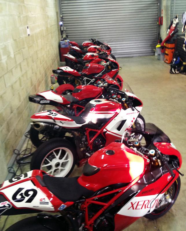

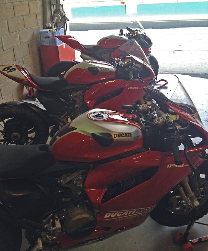

    the 3 R's..
    whoops, make that 6 R's ( 3 x1199 and 1x1098 and 2x999 as rainbikes + 999S) full garage
    the nica 42

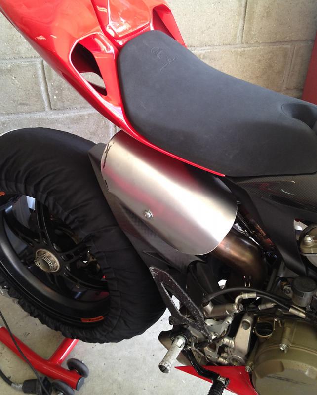

    and as i hadn't put the heatshield back on and the wrap smoked ferociously, we improvised by cutting a piece of stainless steel sheet and making a heatshield on the spot ... and it worked damn fine.... could ride without getting hot... now that is what i call assistance...

  17. is that sprocket 520 or 525 and does it sit on its own carrier or will it fit the renthal one?
  18. it's a 525 (for longivity) sitting on its own carrier .. the 42 needs no longer chain..

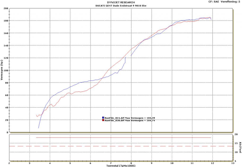

  19. so just got the dyno done from the PRO pipe in comp to the EVO pipe... it shows what the pipe is set to do : being stonger midrange and it def is. the diff between 6.4 and 10k can be feslt is and is pritty lineair .. thoh , the dip below 6 is equally stongly present, but idea is not to ride it there, so it is def an improvement.
    it also is in SAE mode so 185 bhp at the back wheel is not too bad ...
    next week we get the cam timing done and curious what that will.. give ... as far as engine and bhp is concerned : we're reaching the end of where to go. :) the bikes got 2300 km , so timing to do this is optimal.

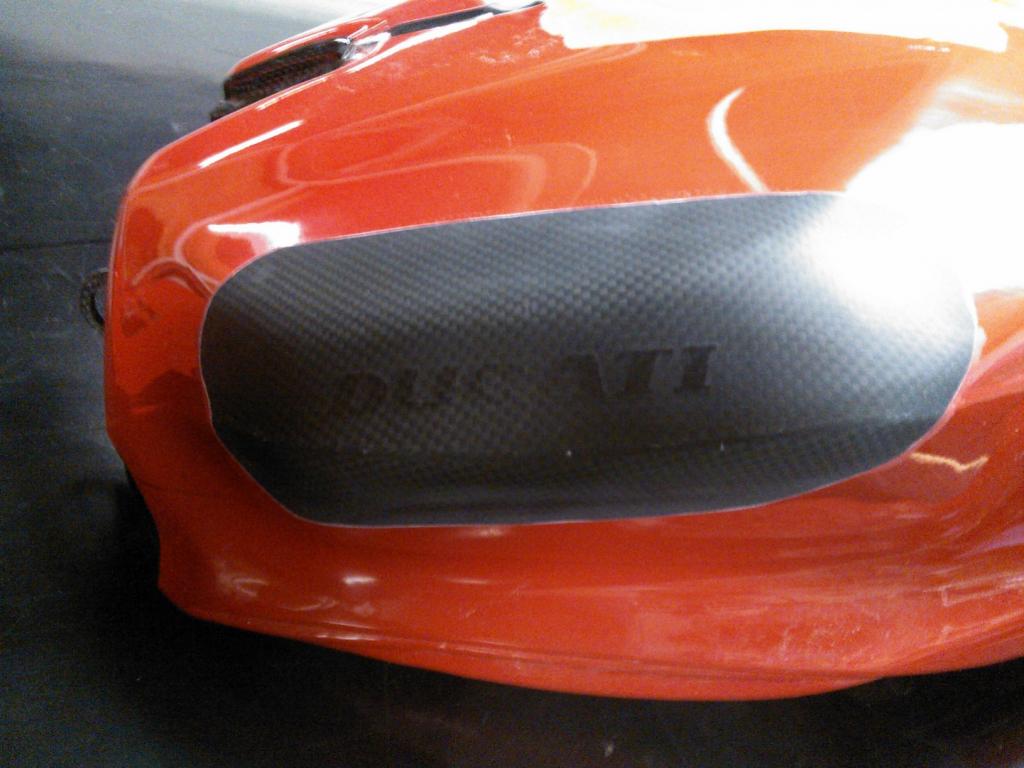

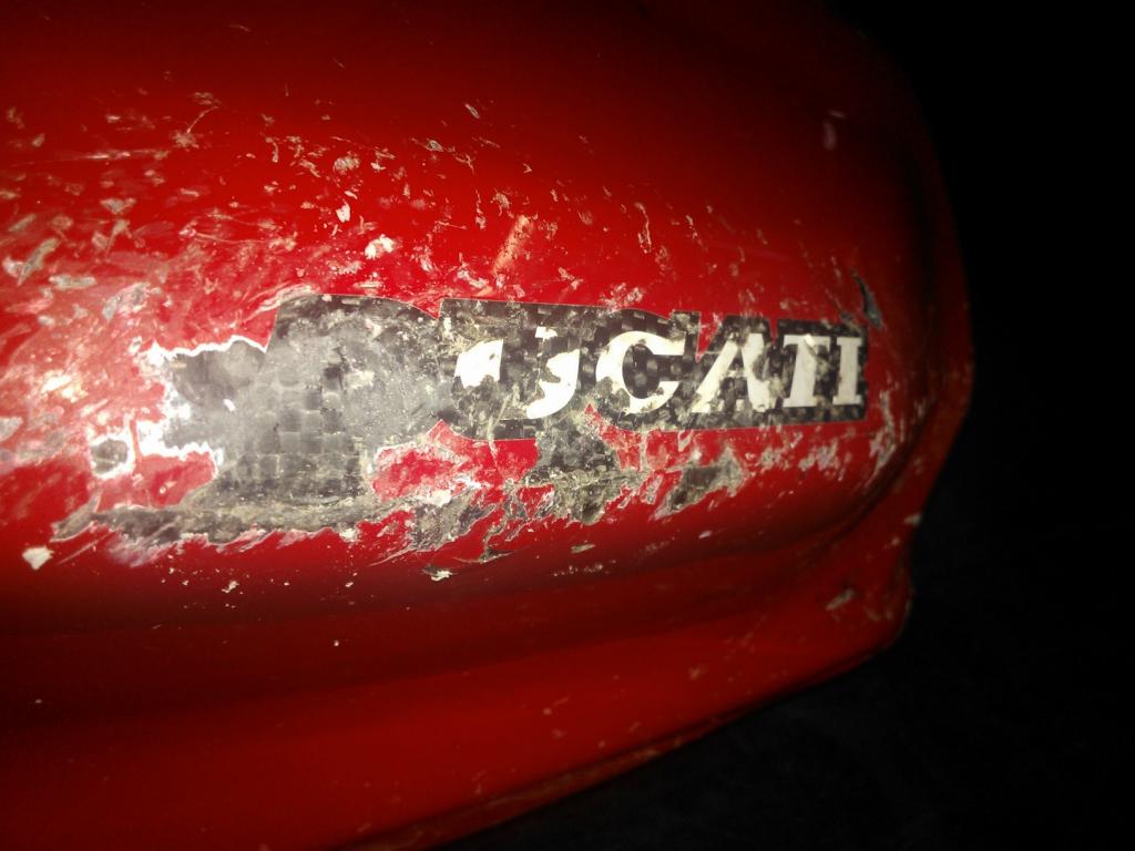

    got news that the fuel tank was repaired and ready to go to the painters.
