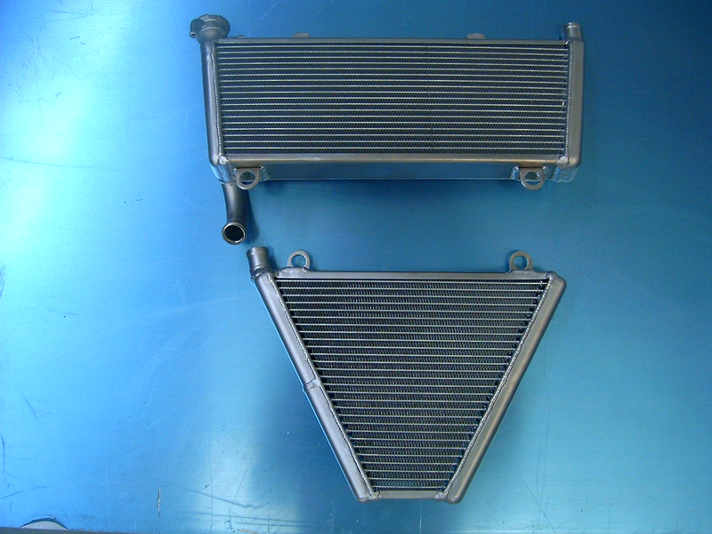

    Something decided this week is the change of radiator to make sure that all those horsies are not lost because the bike runs temps above 92°C some days have given 104’s which seems way too high..
    We’re opting for a better core unit on top and bottom. The Febur with the Oil cooler will be for sale shortly.

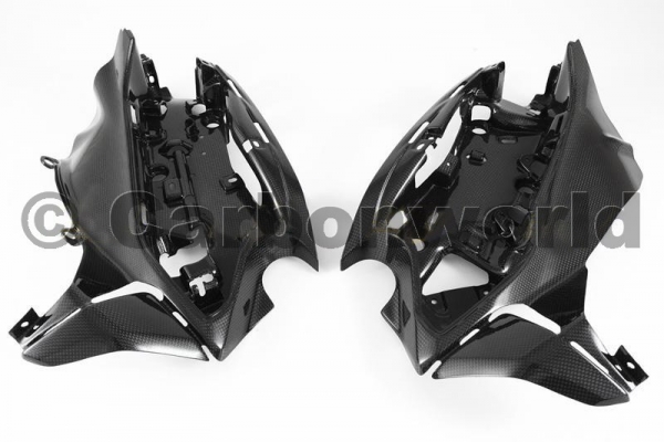

    the only major bit - apart from the subframe - i found this week and is on it's way : the sideboards holding the electronics.. not only lighter bur def much prittier..

  13. ^^ Hey Kope - great pics and informative write up. I definitely need you to mail me details on rad - my bike runs too hot in Dubai - can try it on my R and then if it works swap it over to the superfanny!
  14. I ll mail you tomorrow !
