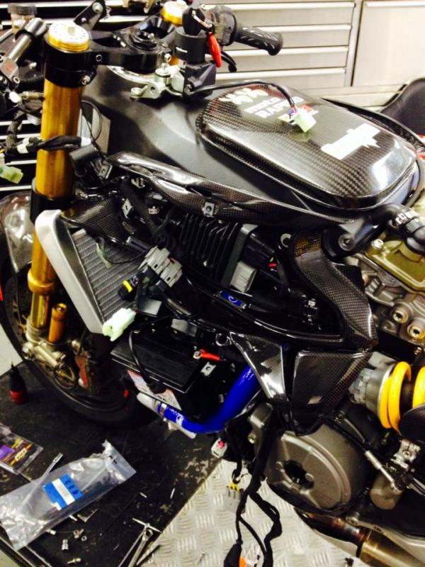

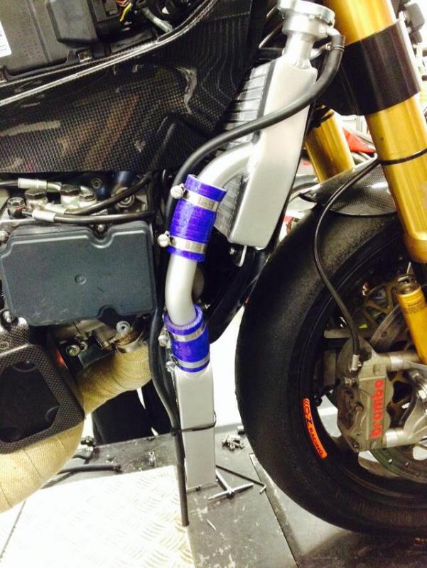

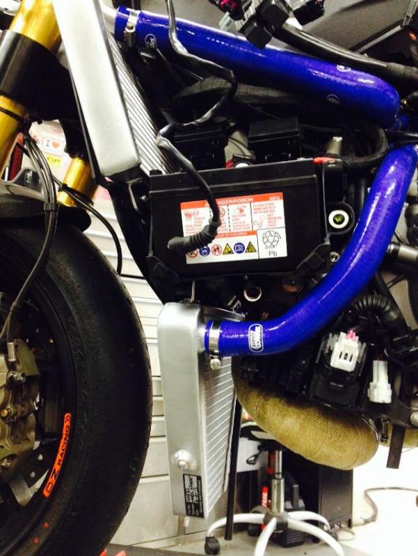

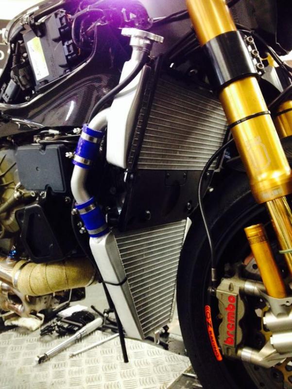

  7. MR jan 2014 _ 9.jpg MR jan 2014 _ 10.jpg MR jan 2014 _ 11.jpg MR jan 2014 _ 9.jpg MR jan 2014 _ 13.jpg
    bit of a problem with the radiator i bought in italy ... didn't fit properly to suit the SBK pipe, especially tubing and exhaust. grrr.. so had to take the plunge and fitted the one MR uses.. not the full faced RS one but this one will do nicely .. the blue looks the part as ever.. :)
    i'm strolling in the halway as Steve is laying the last hand on the mapping ... like a doctor doing a delivery ... but much more complicated... i'm stressed out... :)
