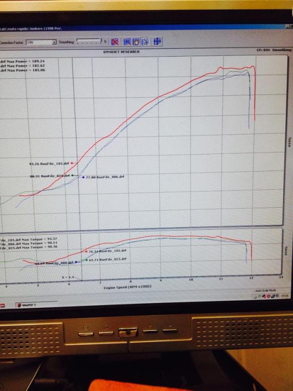

  5. what het fuzz was all about : DYNO CHART...
    what het fuzz was all about : DYNO CHART... :)
    the blue and green line is Lucs and my bike carrying a DP PRO pipe, sstk ecu and mapped and timing of the ignition done so pritty optimised at 183 on this dyno.
    the red is the mine after he got the full treatment... :) makes me smile every time i see it..

    Nice beefy torque curve you have there. The grunt must be awesome. You might need to velcroe yourself to the seat.
  8. Change gear at 11700 and straight back to max torq. Max power max torque x 6 equals big arms or superglue on the seat, velcro wont hold that baby back ;-)

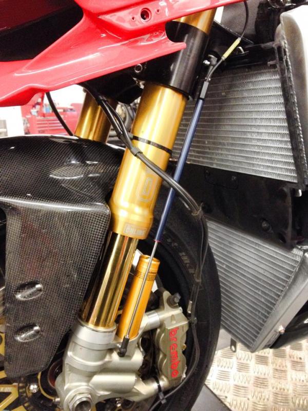

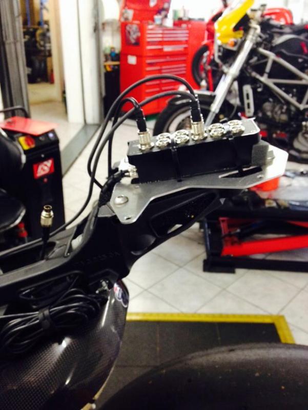

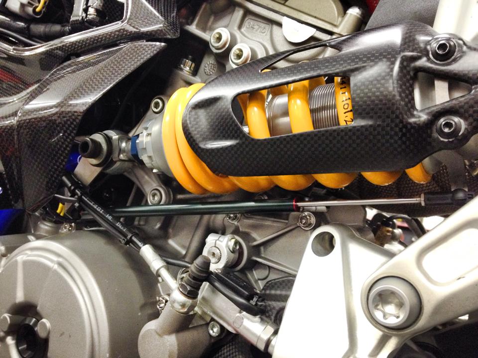

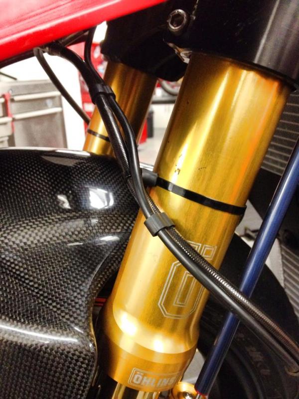

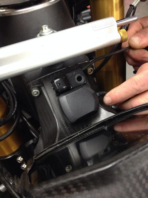

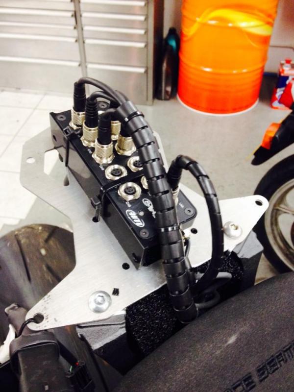

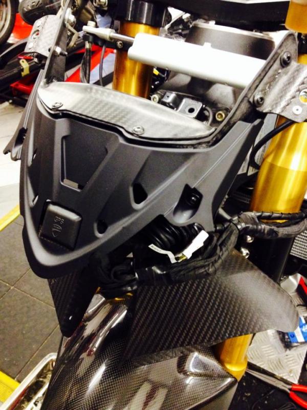

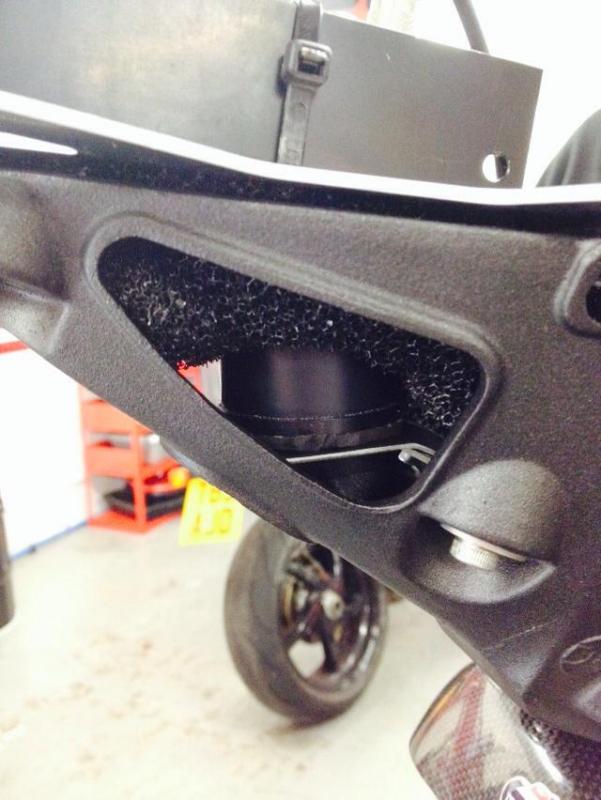

  13. AIM data logging kit got finished today and properly set up and calibrated... it's here that one can really see the level of expertise these things require... it's kit not really intended by the manufacturer to go on the bike.. so the attention to detail to get this all done properly it takes set the few apart from many... FB chat is one fine medium to see things as they develop and let me tell you i had the most wonderful time seeing the advancement and pics coming in.

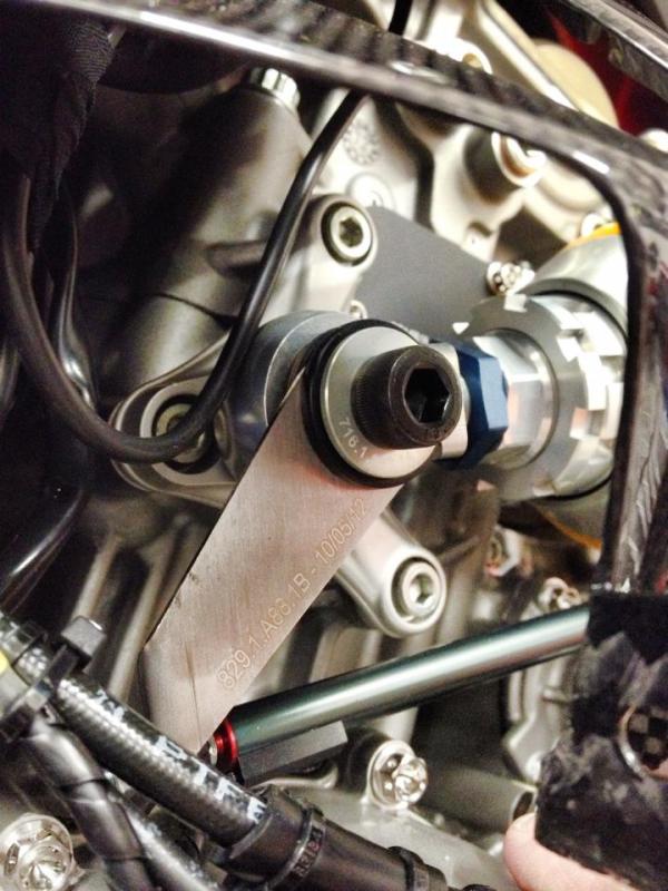

  16. Hi Bro ... its a lot more complicated than it looks.. as the bike does not intend to carry this stuff... small things to appreciate : the bolt holding the reas shock was strengthened as the original one will bend if you put the suspension sensor bracket on.. ! If it was conveiniant to put het logger on the back , it does ad weight to the rear. A good thing as putting it on the front will overweigh an already overloaded front. Remember that the major development last year on the factory bikes is to put less weight on that front. that's why the put the Magnetti system now in front of the bars. :)
    glid, yes and no... i think you would be correct if you'd say : "it s not JUST abbout mechanics anymore". But from what i see, the level a mechanics now has to achieve to do this kind of stuff has never been so high. And on top of that, the same goes for ubnderstanding the electronics of it which are mega complicated. the more il eran and see what needs to be done , the more convinced i am of the rarity of knowledge of peope like Steve or John Hackett. I know some very good people at 80 to 150 km from where i live. But im now very sure that those 450 km one way to Winchester were the wisest i ever did. :) . Setup coming next !

  18. Yeah I did notice all the stuff going on the back and it made me wonder where it will go on my SL as the rear sub frame is tiny and likely not have the space.....
  19. Steve Will fix it .. Corse SSTK kit Will fit more easily .. :)
  20. Kope, how much does all that cabling weigh? It looks heavy...
