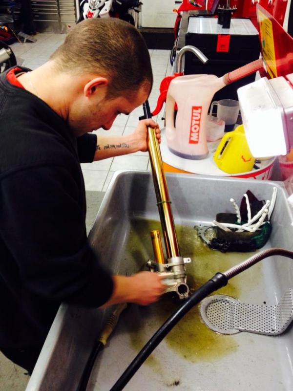

    Then when the forks came out I was pretty gutted to hear that first of all the level of the oil was 148/155 – so not even – and that the numbers I had gotten were with the springs in.. so not only were all readings not right, the difference was so huge that Steve could only decide it was a very very bad setup. One that had as major contribution to dive under braking only to go somewhere where there was no room left for any suspending to be done. So sloppy under braking and rock hard mid corner.
    Add the lack of rebound damping with the one side not done and it’s the recipy for losing it mid corner.. Now does that ring a bell? Yep indeed. Losing the front at SPA. What would finally be a 8K mistake. Not to be added the tendency to lean backward when getting of the brakes because of the P settings without adding a stiffer spring. Now I think of it that combo makes for a rocking chair. Because setting it to P will stiffen it up in the end. But it will not be as stiff till 45 % of the travel and will start way and way softer. On a spring that is meant for street riding. And is 5KG lighter than the same shock in aftermarket delivery.
