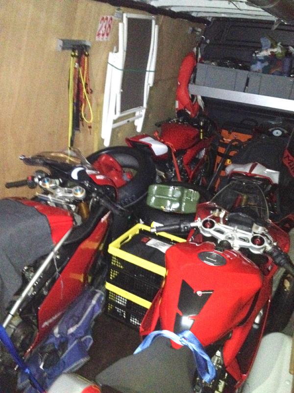

  18. SO guys ! here we go ! 2014 season got rolling... had to shake off a bout of the worst flew since i can remember.. but finally it was time to pack up for Spain ... Barcelona next monday and tuesday and Valencia next thursday and friday...
    i feel e bit weary and anxious as i'll have to tame that beast now... and there's so much to do and learn on many issues...
    still confident that the bike is now set up ... the more i think of it the less i can comprehend that i could hold the pace with a bike so badly set up... and the unknown risks i was taking... grrrr....
    but that's all gone now , stocked up on tires and wheels so no holding us back now... weather seems it s going to be optimal... :)
    taking the 999 as a reserve bike and then 2 bikes of friends.. it's the first time the Sprinter is fully loaded. Happy how it worked out ...
  19. Hope it all goes well for you. It'll be like starting again and learning the bike all over. Hope its everything you want/ expect and more.
