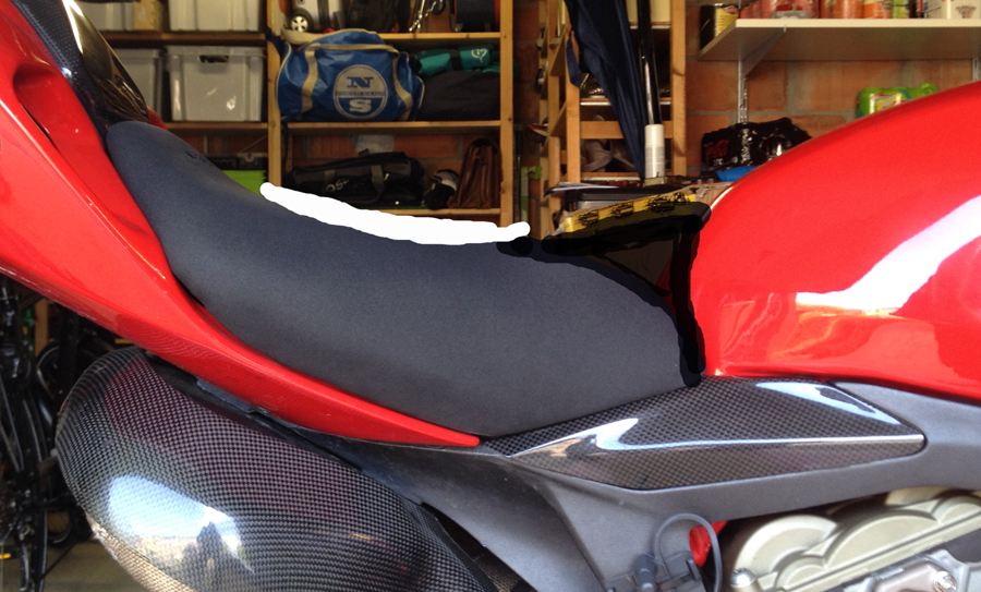

    now how to do this :
    i asked Luca from Race seat if he can make me a seat like this. I also lowered the bars by a bit to pull lowered bars.jpg me lower . and i will resort back to using the DP race seat which is lower than the one that is on now..

  17. ^^ Koen - am I seeing this correct - in the seat photo - where you have coloured in the black by tank - that is the shape of the seat you want? If so, I would not advise this - when you brake (which you are now doing even harder from your improved rider skills) you will not have anything other than your arms to take the braking forces and you may end up with arm pump (trust me you don't want this - I am having to have an operation to get rid of!!). Yes, you will also use legs to grip tank, but with that proposed seat you won't have anything to anchor yourself with.:Wacky:
    If anything, you want to go the other way and think about the tank becoming more square where the tank meets seat (look at wsbk fireblade as example). The magic triangle of foot peg, handle bar and seat should be looked at as a whole and you should do what you feel is right - think of Foggy, Colin Edwards and Troy Bayliss - three totally different riders and positions on bike; modern day dudes - Marquez v Rossi (albeit Rossi has changed his style but I think this is more to do with utilising the electronics).
    If you look at the taller riders when they are going down the straights they are putting their bums up on the rear seat cowl and so standing up on the pegs (so get on that squat rack :Smuggrin:); and then looking at getting more bent over the tank, could simply be down to flexibility in your thoracic back and losing some puppy pounds from the front, so take up Yoga and yoghurt - this with the squat rack work and you'll be hidden behind that screen in no time :Happy:.

  19. Having a Panigale too, I have to agree that the tank shape where you want to grip with your knees is rubbish until you are hanging off! It's too narrow and there is nothing to grip onto. Once you are leant off the bike, it becomes a good shape/interlock with footpeg, knee into underneath tank, race seat sides and tank edge gives a good solid lock - but when braking without hanging off it's a disaster! Hence, move ass sideways, then brake with your inner thigh against the tank and then lean off with shoulder. I tried some stompgrip but that didn't help much either as it is not in a good position. The tank on the 848 and the Desmo are both better to lock into with your inner thigh, the Pani is so narrow. But allows you to really climb all over the bike (as it's tiny), so I bet it would be great on track once you are used to it (mine is a road bike).
    I actually cut down the front of my race seat foam a bit to reduce the height of the front of the seat by about 3/4 of an inch. Much improved position, and better lock on the tank. I just took some of the foam off with a dremel, put a slightly thinner lighter foam on top, and then glued/stapled the top sheet of the race seat back down. More comfy/grippy and better shape. Wish I could get one of the seats off the RS, they are much better - but they don't sell those anywhere and they are a different fastening to stock.
  20. Chamb, i picked up a stock slppery seat cheap to get back lower. Perhaps the slippery will allow me to move more easily from left to right. being heavy, having that weight lower down can't hurt.. i carry more than enough weight in the torso that there amply left to change COG.. :)
