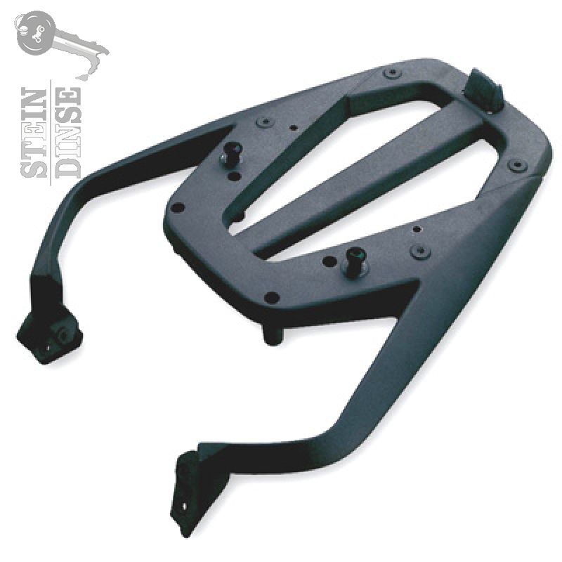

  1. whoops cant get a avatar up but managed that. This is what my dealer sent me as too whats required and its minus the support legs. You can see its quite different from the previous Top Plate. Will wait to seee what Meds comes up with.

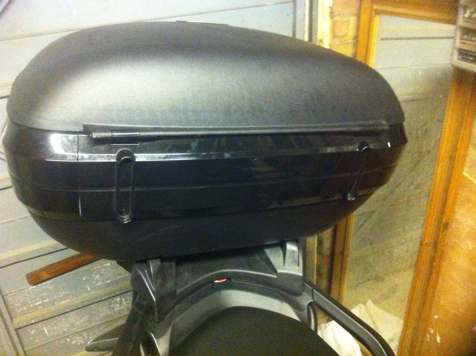

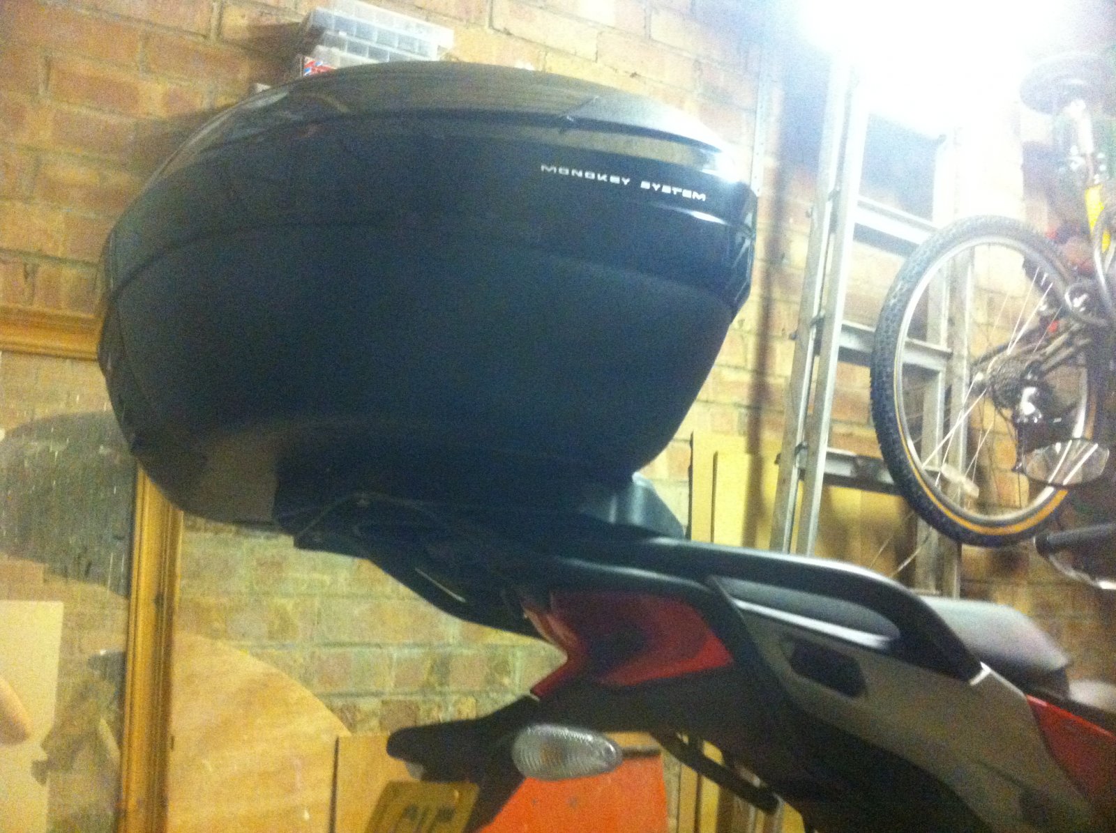

  8. From a large box of bits from my dealer, I made a list of all the parts needed for a single bike for my dealer so he could order up a single set for other customers. I then took the unused bits back. I think I kept a copy. You might be the guinea pig to test out my list writing skills. I think it's correct. I'll have a look for it. In the meantime here's some pics of the arrangement on my bike. It's a substantial kit, and rock solid unlike the bouncy kit I had many years ago on a Yamaha. There are 3 rubber plates and the whole lot sandwiches the tail and has struts going underneath the tail.
