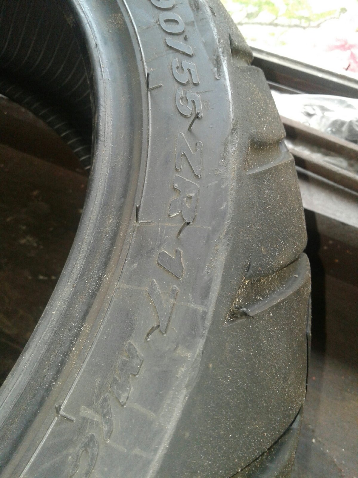

  4. I'm on my third Scorpion II (the second picked up a large flint 5,000 miles on) I haven't had a pillion on or ridden it particularly hard (due to appalling road conditions) and note that after just a few hundred miles I'm getting the tell tale marks on the edge of the tyre! Define "chunky"? a bit over 13 stone?

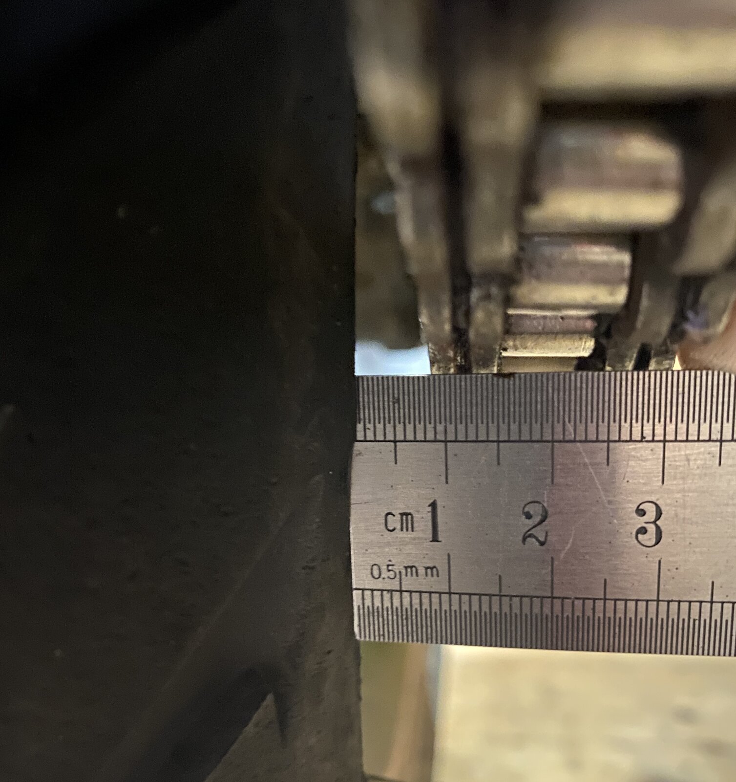

    Found this thread whilst looking for another topic & thought I would measure the gap between my tyre & chain after I adjusted my chain, the middle rivet of the chain is exactly on the line of the gauge, but my finger barely fits between tyre & chain, luckily no marks om tyre.
    Here is what I found:
  7. I know that 195/55 should be a profile common across manufacturers but from what people have posted, some tyre carcasses give less clearance between the tyre and the chain. I have more of a concern on the clearance between the tyre and my Arrow silencer, that is less than the thickness of my index finger. Andy

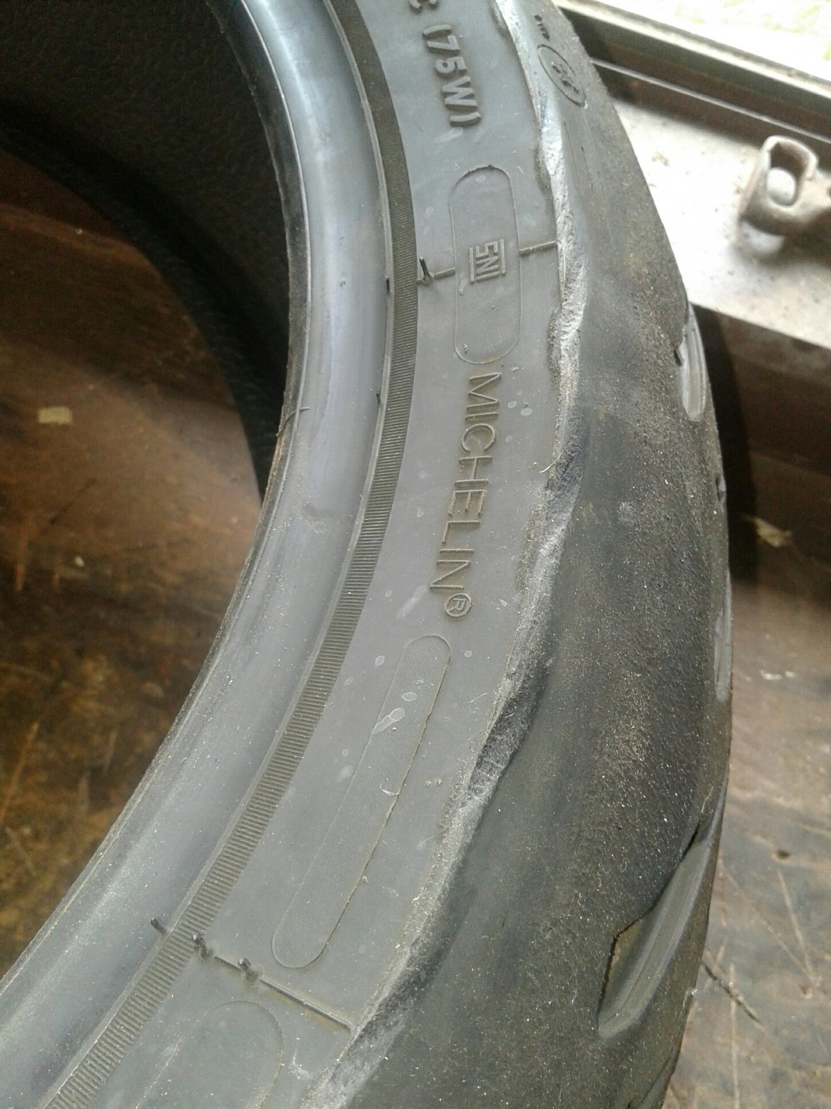

  8. My previous 1200S 2017 when fitted with Road 5’s had chunks missing, even though the chain was within spec I thought it was the chain catching the slightly wider tyre, no issues on OEM tyres on my PP but wanted to change to Road 5’s next so need to find out what’s going on too
  9. Never had that issue with any tyre on my MTS including Road 3,4,5 Pirelli Angel and Scorpions

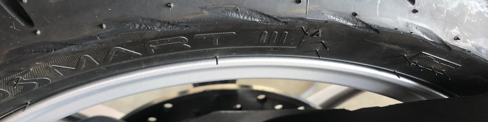

  11. Have this issue across multiple Road5s, Not on OEM Scorpions though. Quite honestly it doesn't bother me, it's very slight and that part of the tyre is a sort of sharp ridge with plenty of 'meat'.
  12. yup ... have same wear on a Dunlop Roadsmart III on my 1260s.
