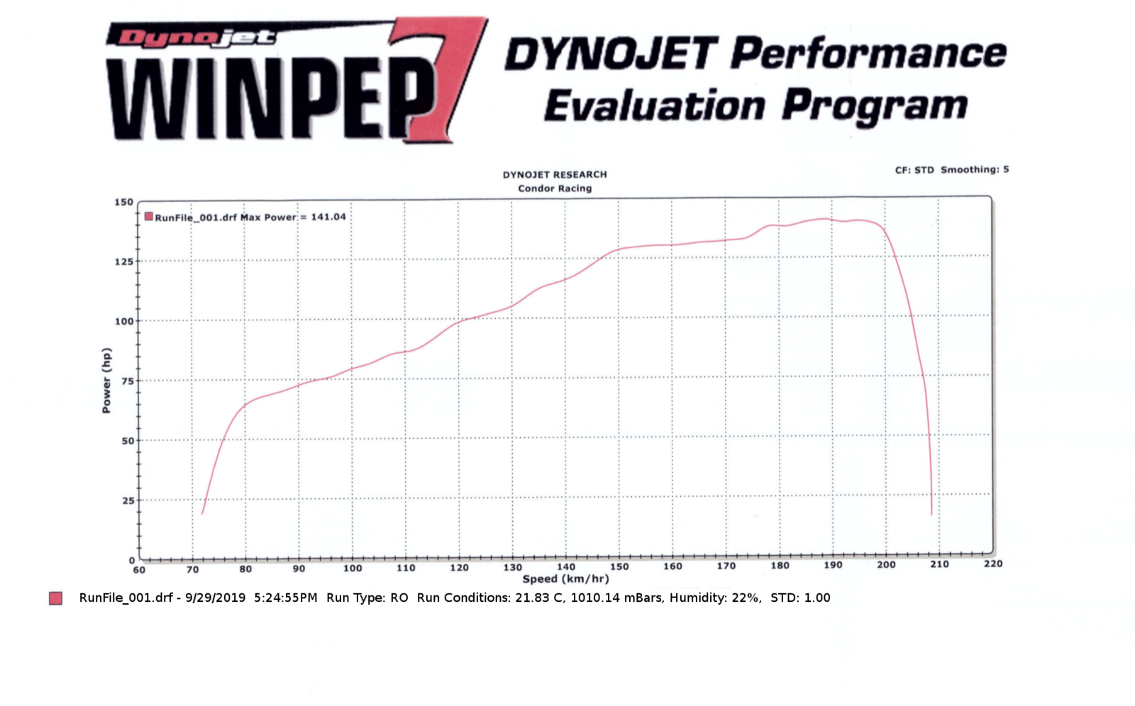

  8. 160 RWHP is 20 RWHP more than a stock 1260!
    Not a snowball's chance in hell.
    I'm not trying to be condescending or anything of the sort but In the absence of a Before & After Dyno chart, any gains did not happen.
    Here's my stock 1260 Dyno chart using the "Happy" STD smoothing which overstates RWHP by about 2~3 HP.
    SAE smoothing should have been used.
    Most important, notice the smooth shape of the line and the absence of major dips. That's what you want.
    This is stock and Ducati has done an amazing job improving the fuelling over the 1200 which had a notorious dip.
    Every Dyno chart published has shown that installing a Full Termi has added next to no improvement in peak HP.
    Moreover, these same charts has shown a decrease in peak torque.
    The best you can achieve with a full Termi is slightly improving mid-range HP without any change in peak HP at best and giving-up some at worst.
    What you're getting for all that money is sound.
    Weight savings...ROFLOL as if you're going to notice a few pounds off the lowest part of the CoG.
    All said, there's no rational other than "whatever makes you feel good". That's the bottom line.

  16. No it’s not. Probably only 5% max at top but midrange may give much bigger gains.
  17. For the 1260, zero peak HP gains and very little mid-range improvements.
    For the 1200, there's some mid-range gains to pick-up as you're eliminating the dip and smoothing the curve.
    One this note, most of the improvement can be had with an ECU flash alone.
    I'm not knocking the Termi or any other mod. But it's definitely a vanity purchase.
