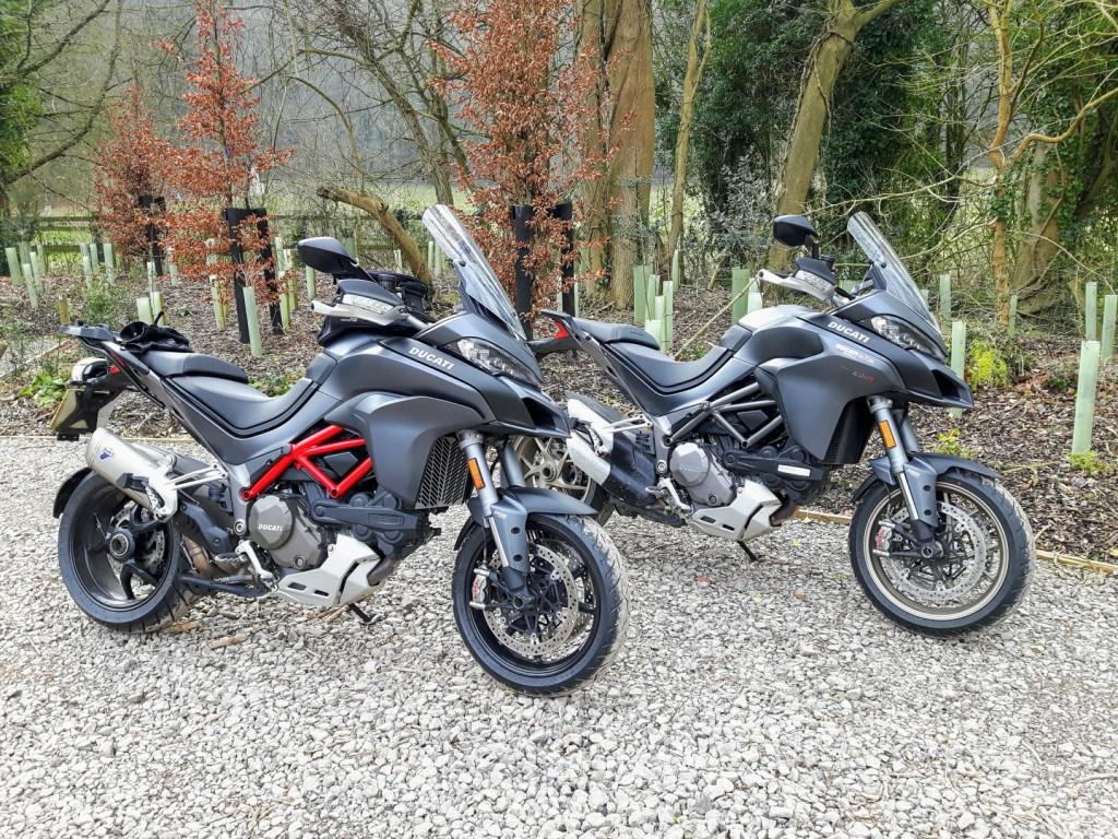

  16. I test rode Snells 1260 demo bike yesterday. I actually rode it too much and took it back later than planned :blush: but it gave me a good idea of how it behaves.
    Firstly, I couldn't tell the swingarm was longer as it handled exactly like my 1200 DVT as far as I could tell. Maybe Dovie or Valentino would be able to find a difference on a track, but not in our road based world. IMHO there's no need to worry about 'slow handling' on that score.
    Secondly, that engine is a peach. It is what the DVT should have delivered first time round. The 1200 DVT was a good idea, smooth low down but spoilt by too soft a throttle response and bogging-down at those low revs when the throttle is opened quickly. The 1260 solves that issue and pulls like train from low revs to high without any delay. A bit like the original 1200 and twin-spark did but with added smoothness.
    Thirdly, the heated grips get hot! Snells said that the supplier of the throttle and handlebar electrics has changed, so that probably explains the improvement on the grips at least. Unfortunately they said they didn't think the new heated grips would be compatible with the 1200 DVT due to the change, but they weren't 100% sure so there might be hope for cold finger sufferers.
    The Touring throttle map is back to being usable and practical. In fact it was so good round the back roads I didn't bother to go into Sport mode at all. I'll save that treat for next time.
    I've read criticism of the water-pump cover, but those people are more aesthetically sensitive than me. It isn't pretty but it presumably is there to do a job and I didn't find it offensive. Your results may vary.
    Cons: The grey bike and grey frame make the bike look rather ordinary. I rode with Pilot Paul on his 2017 grey DVT with a red frame and that is a far more attractive colour scheme.
    The other negative is the price-to-change from a 2015 DVT. With a lot of 2015 bikes now on the market it would cost around £8-9k to change, and whilst the 1260 is definitely an improved model, it is not £9k better, so I'll be keeping mine for now.
