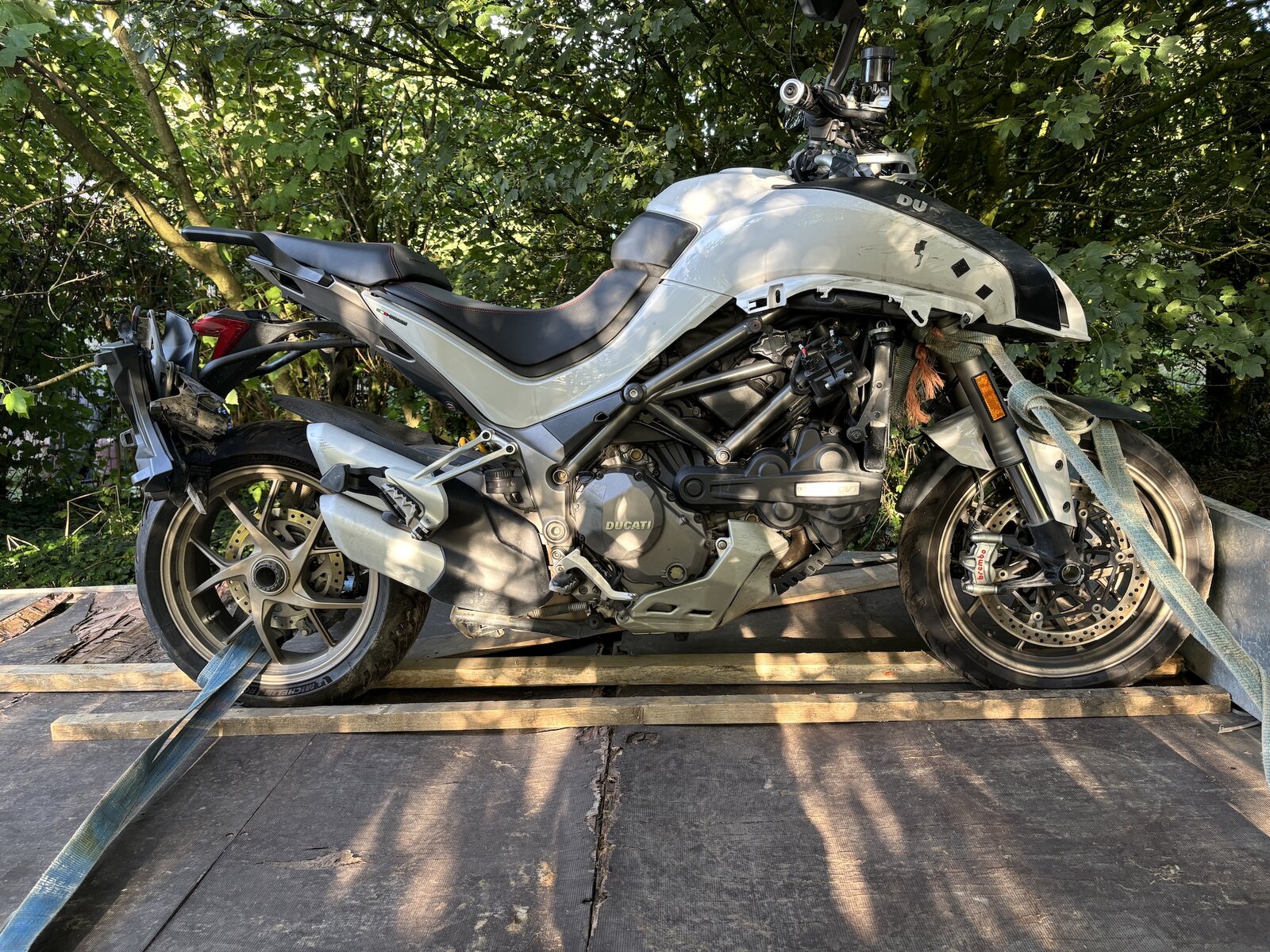

    Today I went to Cheltenham and picked up the salvaged bike.
    Bumpkin is a misnomer, he's infact a true gentleman. It was a pleasure to meet him.
    It's been a long day so I'll post more in due course.Thank you Charlie.

  4. Thank you Andy, very pleased to meet you and your son. Sad to see the bike go but she'll live on, albeit as a donor. I think we're both happy with the outcome/arrangement. I now have garage space for the new chapter in my Multistrada journey :grinning:

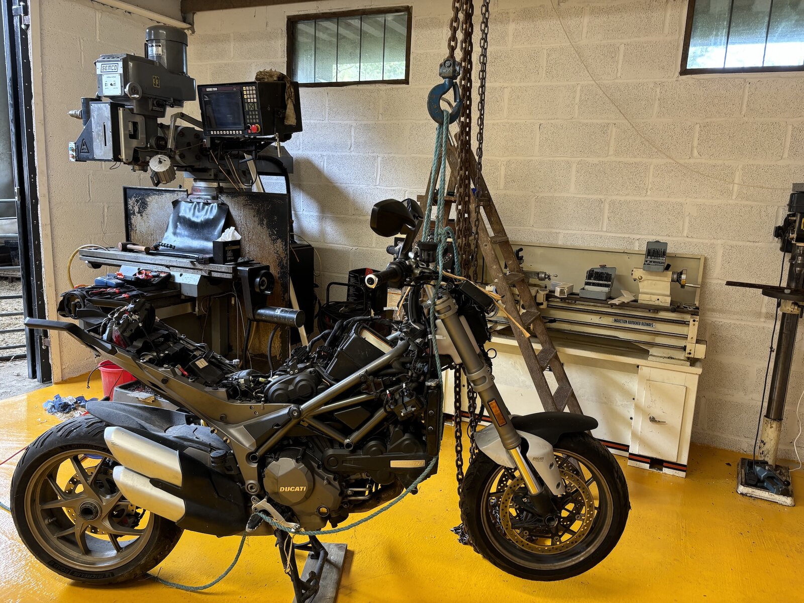

  5. Today we charged the battery, reconnected the lcd screen and headlights and fired it up.
    I want to assess whether there are unforeseen problems with the engine before stripping the whole thing down.
    So far we've found the radiator has been pushed back onto the fan, the oil filter has been dented and is weeping, and there is a warning light 'on' on the dash (we could do with an OBDstar). Early days but all looking good.
  6. Glad to hear that it fired up OK, that's great news. The damage to the bodywork on the right side possibly pushed the rad back, didn't notice that though the support bracket on the side of the rad did seem bent.
    OBDStar is a useful tool. You might find that the warning light is just down to the battery being below threshold level. It powered the tracker for over a month. Having said that the bike has experienced trauma with wiring connectors ripped out and, from what I saw, the aux socket lead shorted at the time of the accident. Though that should have just blown the 10A fuse under the seat.
    Good luck with it all.
  7. All the fuses were good. The key is not talking to the ignition switch unless it is held against the panel. The oil cooler is leaking. The (full) fuel tank had jumped out of its mountings. I think you were lucky not to have come to more harm.
  8. It's so nice seeing the bike get a second life rather than chopped up and recycled.
  9. The frame will be scrapped along with the broken bits , the rest will be stored and used in due course.
    The front wheel is 2mm out of true and the LH disc 8mm out. Both can be straightened.
    Next job check out the forks.
  10. Thanks for the progress update :upyeah:Quite how both mirrors survived intact I can't understand...
    Guess my groin must have dislodged the tank. There was no brusing to support that theory though. Maybe the weight of the fuel and momentum... that's probably what you're implying. I had only filled up some 20km before the prang. You got that lovely French premo petrol thrown into the bargain :D
  11. Just a thought on the error light on the dash. I removed the Healtech exhaust valve eliminator module and reconnected the connector under the seat before you collected the bike. However, the valve is still wired in the open position. The valve hasn't been actuated in about 20,000 miles so may well be seized anyway.
  12. That can be easily checked, I can swap the Healtech from my bike to this one.
  13. Worth a try. Not sure if the error light persists for a while without a reset. The bike did that with the rear speed sensor error. Took a few ignition cycles with riding in between before going out.
