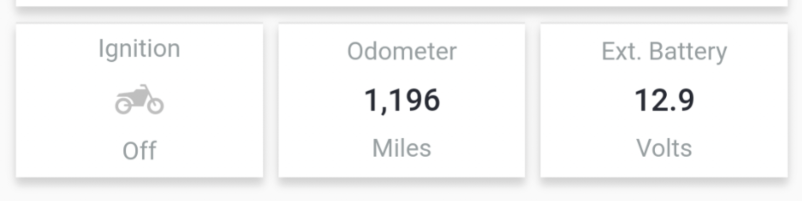

  8. My experience using lithium batteries has only been positive (;)). Had one on 2 bikes now. Both with lead acid drained quite a bit in a short space of time yet my lithium ones barely budge. I just checked my current levels and its at 12.9V after a month of no running. Yet, my lead acid one would be down to about 11V after 2-3 weeks if I didn't have it on charge.
    Maybe I've not been using them enough to have any negative experiences.
  9. Thanks for your experience with them, what brand did you go for/ been using?
  10. Shido both times. No complaints. They are much more recoverable too should the worst happen and they do drain significantly.
    Current battery state and not been on for 4 weeks. Has a tracker installed too which likes to use some juice. Not been on charge at all over this period.
