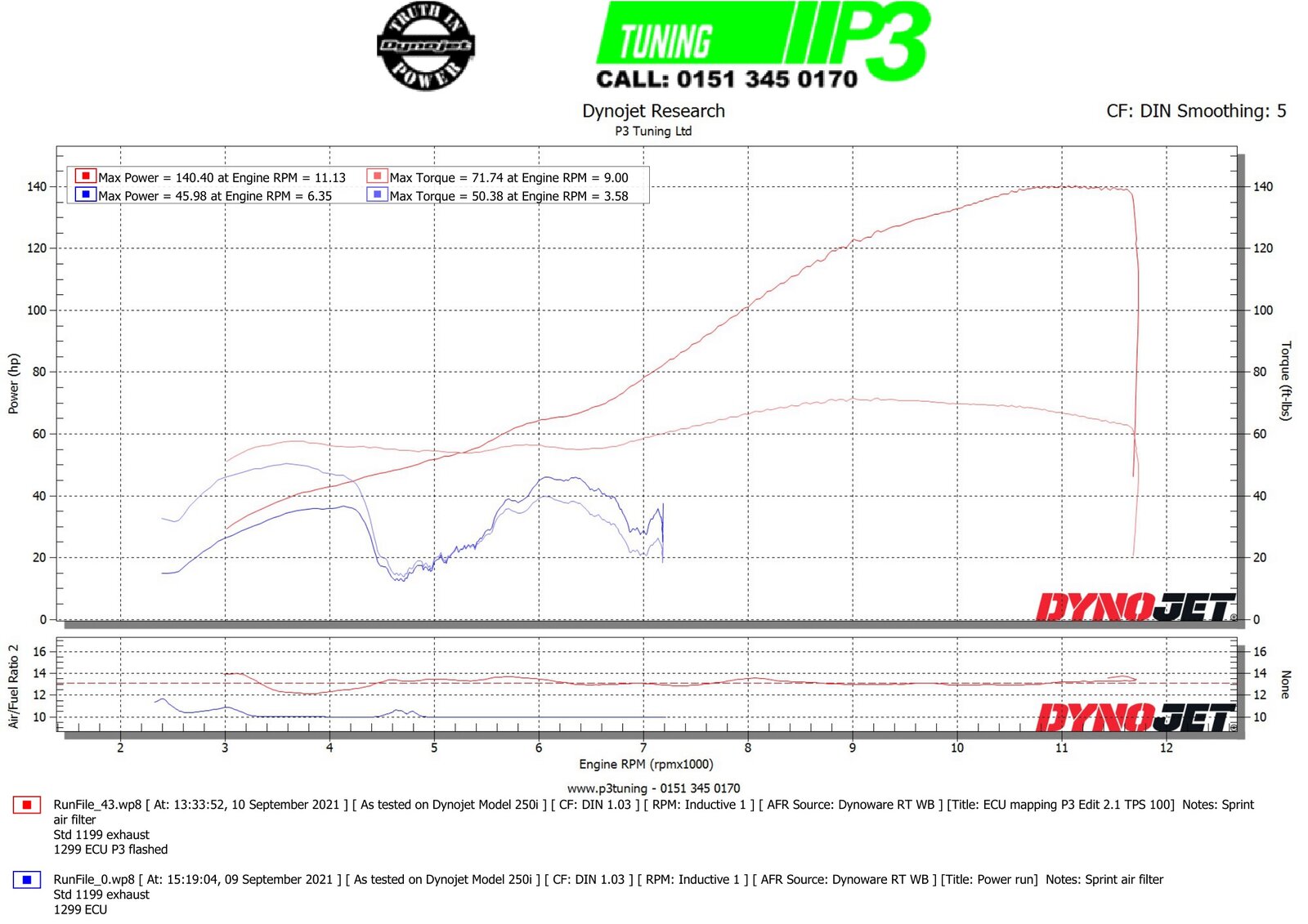

  2. Got round to having the 1299 ecu re mapped last week and hats off to P3 Tuning in Liverpool. Bike now runs better then it did even before I started dicking around with it. The std shifter was binned off as it already showed signs of wear. One of the two micro switches had disappeared and was a bit of a mess. Replaced with a Translogic unit and worked straight away. Both upsifts and downshifts butterly smooth.
    140 bhp at the back wheel and a nice smooth enough curve. P3 have dyno’d a few Tri Options bikes and were getting 144 bhp on their dyno with the Akra’s so not too bad.
    Note how badly the 1299 ecu ran before tuning. 40 odd bhp! :joy:
