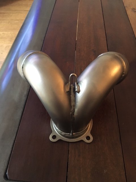

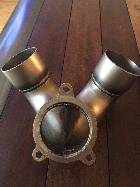

  4. Sorry for the delay had to see if i could ifnd it.
    Is this what youre after?
  5. Don't think that's right. That looks like a Y piece for a set of the newer front exit carbon termi end cans. The good news is they're worth a fortune! That is if you're selling!

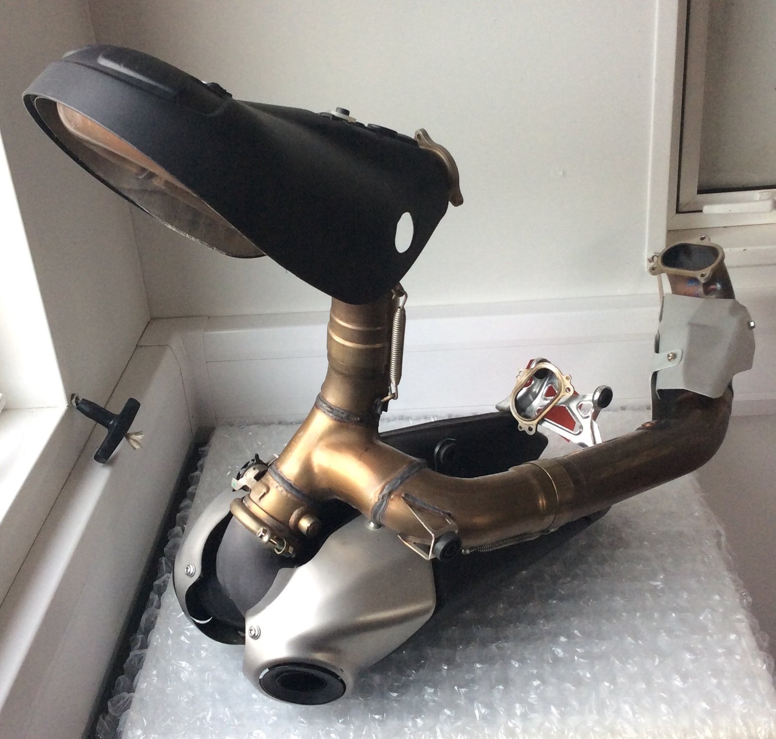

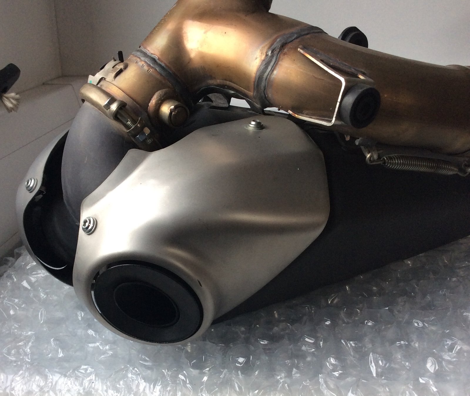

  6. This is what a full system looks like
  7. The Y piece on the standard cans are part of the exhausts the headers join the cans at a flange which is held together with a clamp.
  8. Oh oK thanks, sorry for the confusion then @Gp80
    Its not much use to me now so yeh if anyone wants it feel free to PM
  9. The plot thickens then, so trying to find the correct piece may be tricky, and I expect there a small fortune from ducati !!
    So I'd ideally try and find a full 1299 system by the looks of it
