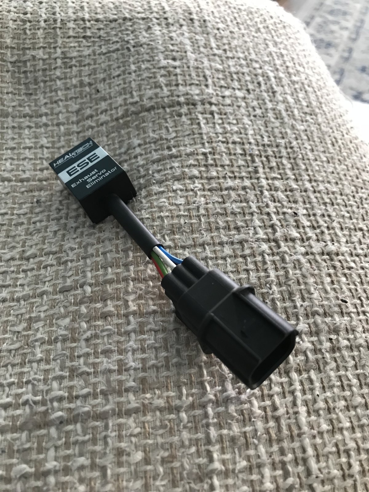

  10. Silly question.. I bought the HT eliminator but where does it plug in? It’s the exact same socket as the one that came with my 1299 exhaust servo but that won’t match the stock connector on the 959! Driving me crazy!
  11. I presume where the exhaust servo motor plugs in to
  12. My thoughts exactly but it’s a different plug head arrangement. Driving me bonkers! I think HT may have sent me the wrong bit of tech, could you ping me a pic of your eliminator just to confirm I’m not going mad?!
  13. I haven't ordered mine yet as doing the swap in a few weeks time, sounds like you have the wrong connector

  14. This is the one that doesn’t seem to fit where the original servo plugged in
  15. Eliminator

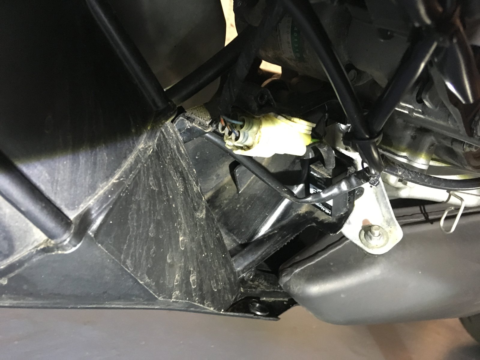

  16. Mine just plugged into where the service was and is next to the left side fairing engine the lower rad cowling
  17. Thanks, did your eliminator look like the one in my photo? I’m convinced that they’ve sent me the wrong one!
  18. Was taking the fairings off anyway so our lucky!
  19. Yup, turns out that the supplier sent me the wrong one .... pheeewww thought i was going crazy
