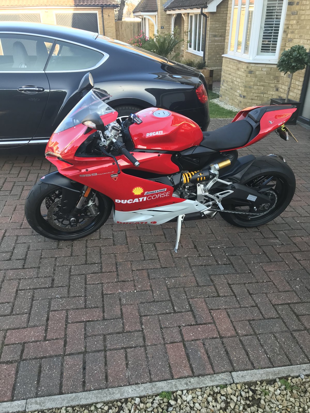

  1. IMG_6999.JPG Sooooo much better

  8. Mine’s done, could only get white lower fairings so they’ll do for now....

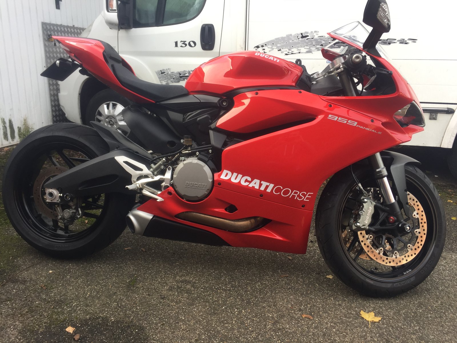

  11. 9E3D2762-9803-43F1-9BD2-B2836DB6EF9B.jpeg You need this mod now:upyeah:
  12. I’m in the process of doing this now - depends on how cheaply you can get a 1299 Exhaust and lower fairing for.
    I watched Ebay for a month and eventually picked up a full 1299 system with every fitting for £100 delivered which was an incredible bargain. Most go for more than that but hang on for a good deal if you aren’t in a hurry. As mentioned in lots of posts you only really need the underbelly silencers and the y connector pipe - but although I have seen plenty of silencers come up the y pipe is difficult to get hold of.
    I couldn’t find any used fairing lowers in decent condition so ordered them new - the 959 specific akropovic underbelly version cost £320 but I had to shop around for that price.
    I’m going to see if the 1299 exhaust servo can be used on the 959 - most people just disconnect the servo and remove it as it’s only there for noise reduction, but i’m keen to keep noise levels down so I’m not restricted in the tracks I can use.
    I don’t live far from Cadwell so once it’s all fitting I’m going to nip up on a track day and get them to test it for me with and without servo connected and go from there.
    As stock the 959 tests at 98db static but the 1299 is quite a bit louder so here’s hoping........
    If you disconnect the servo and remove it then you need to budget another £40 for an exhaust servo eliminator to get rid the warning that may come up on the dash.
