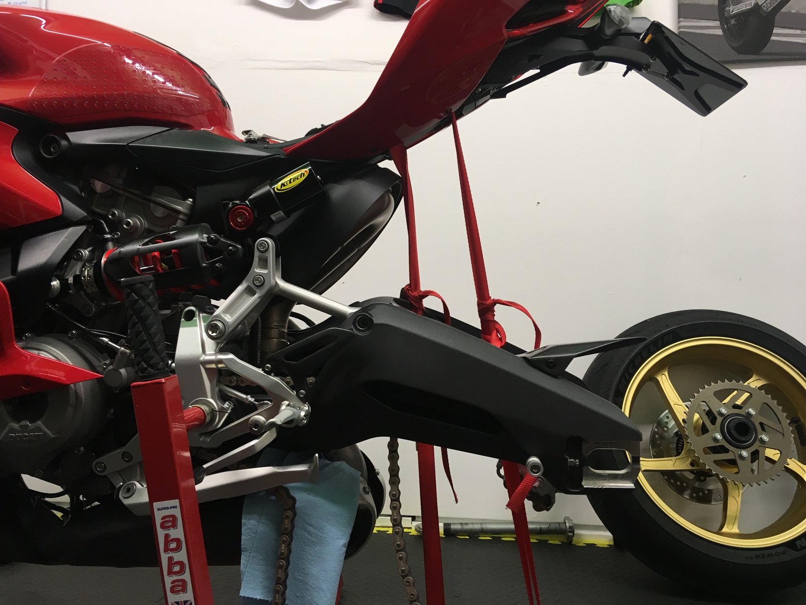

  8. Ok. Thanks for input guys. Bit the bullet yesterday and purchased a very low mile 1299s. What a bike.
