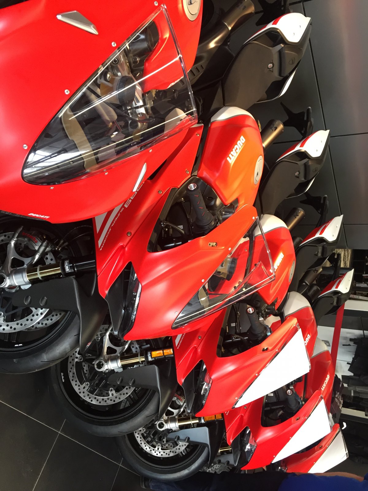

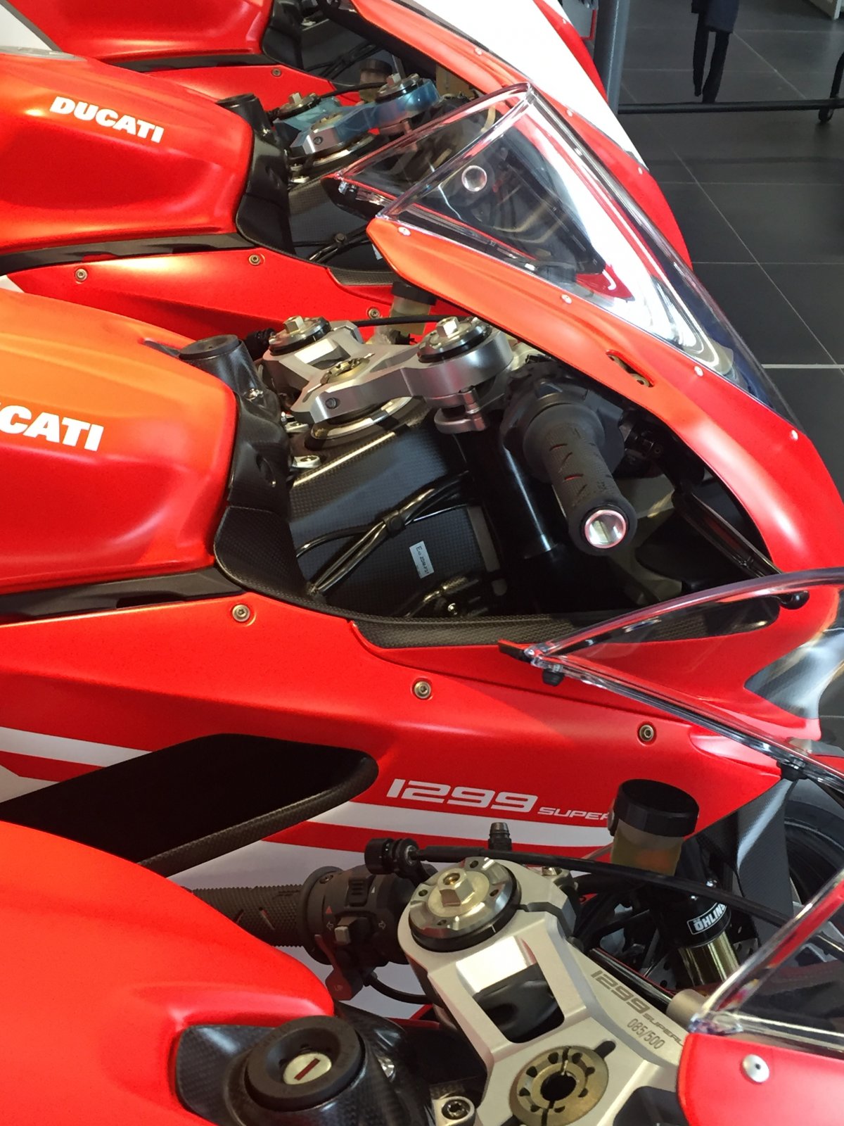

  5. IMG_2246.JPG IMG_2247.JPG IMG_2248.JPG IMG_2244.JPG Ducati Glasgow last weekend....
  6. Good to hear. Don't know if Will had his out or let someone have a go...

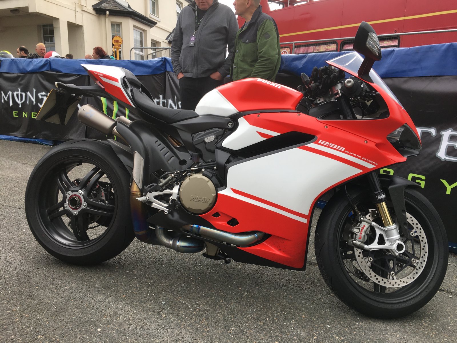

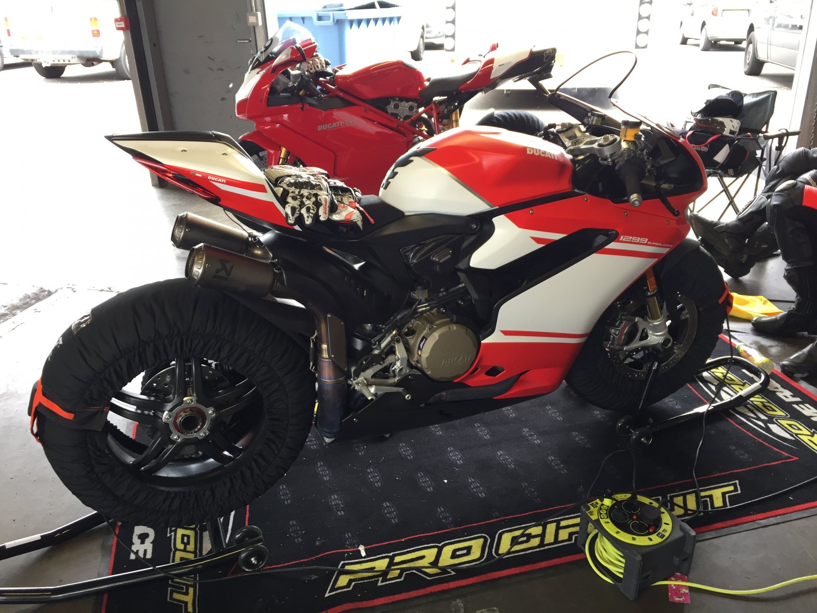

  7. Donington. Tuesday.
