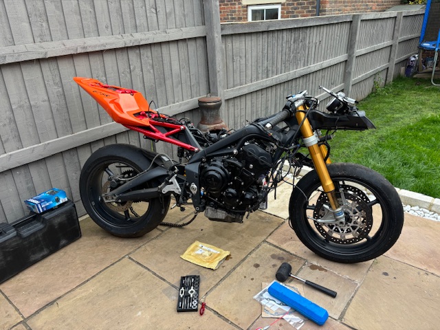

  7. I’ve got one in the garage, halfway through putting it back together! My mate high sided it at Jerez, and fair to say caused some ‘damage’!

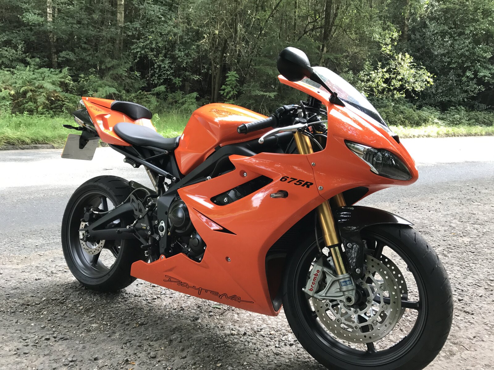

  9. Jeepers, what's that tail off? Dont remember too many orange 675's?
  10. No, it was painted orange by someone prior to my mate buying it. He bought it basically mint with 2500 miles on it. He then bought a set of white fairings and tank for trackdays and promptly crashed it with the white bodywork on.
    I’ve also owned the bike, it sort of gets passed between us! I used it for commuting for a while so my 848 could stay pretty
  11. No fan of orange bikes but its still a very good looking bike after all these years.
