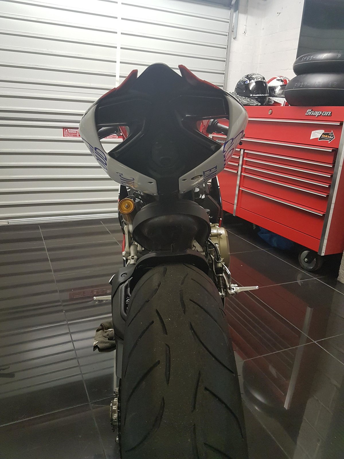

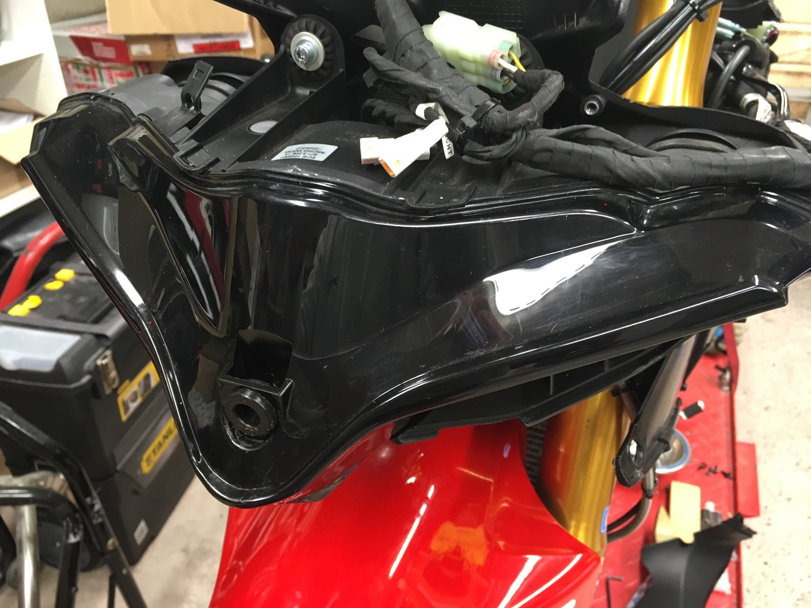

  1. Can anybody tell me what this is just fitting the race fairing and the ducati light blank dosnt have any lugs to bolt it to ?
  2. Used them this weekend. Great tyre equally as good as Dunlop KR maybe better on the wear.
  3. is it a 1199 light unit rather than the 1299 version?

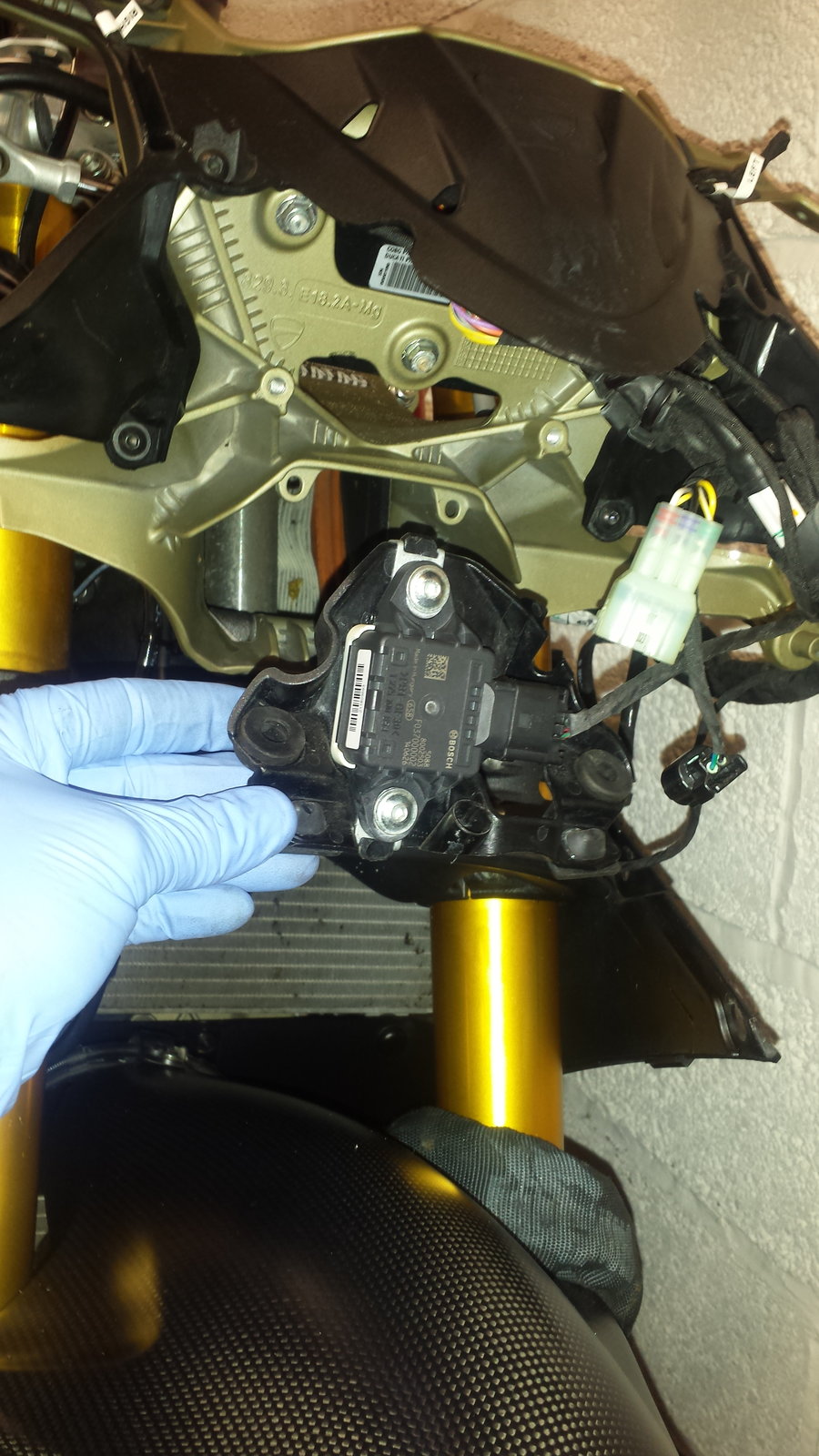

    also there is a small plastic IMU( that part in your hand) holder that should use 2 8mm bolts on the sides and a single plastic pin that pushes into the light unit rubber grommet.
  4. Yes thers a bracket missing out the kit pre owner has found it and going to deliver it cheers tho matey
  5. My local dealer is struggling to identify the precise parts need for the highlight blank on my MY2012 base model 1199. I understand that there is no need for dummy light plugs etc on this model because they aren't LED - is this correct? Also, sounds like I will need a bracket for the IMU referred to above. Anything else?

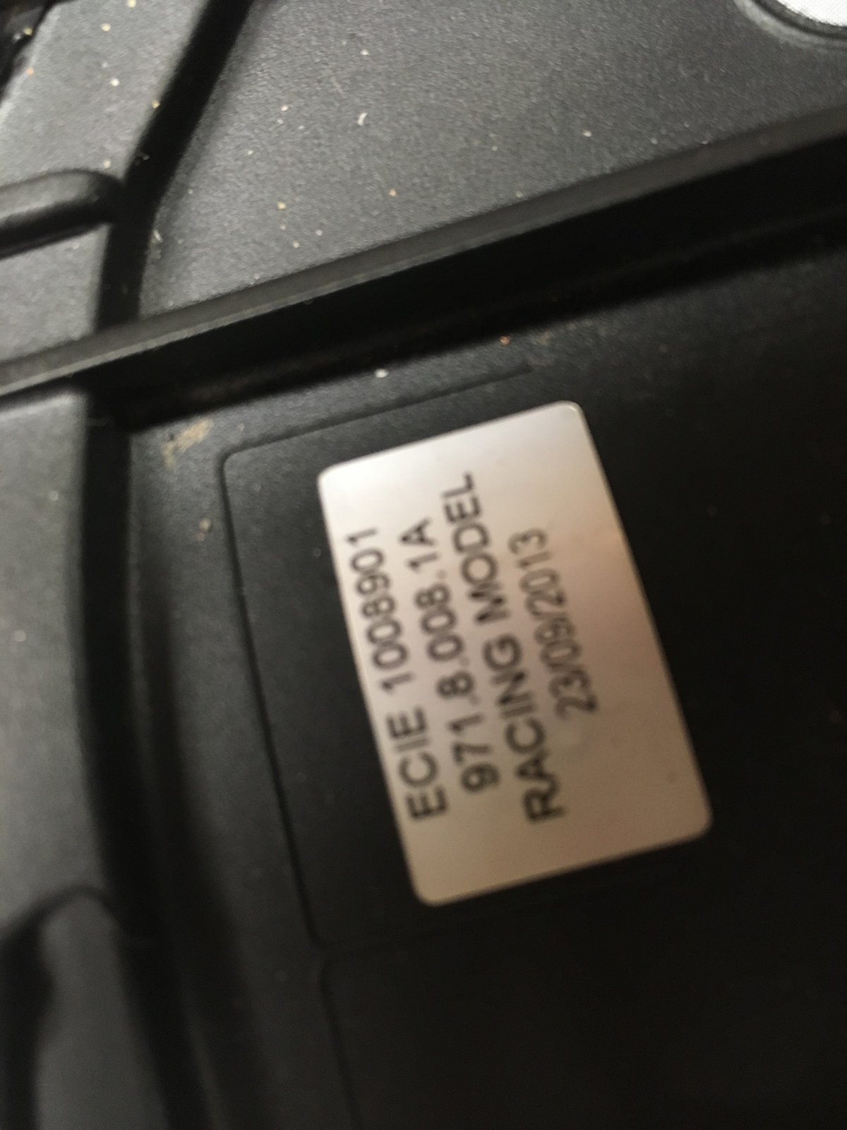

  6. 361FE5F9-F94C-47CB-9962-808A337FC00D.jpeg 7E0B2C8E-9976-4960-A92C-F04E17C892C9.jpeg The
    I think the part number has been updated but your dealer should be able to track it down from the pic
  7. I don’t recall fitting dummy plugs & there are no warning lights or error codes. I also don’t recall an IMU bracket. Might be wrong, don’t think the 1199 has an IMU, it’s not that smart. Think the IMU came with later models?
  8. No IMU on the 1199

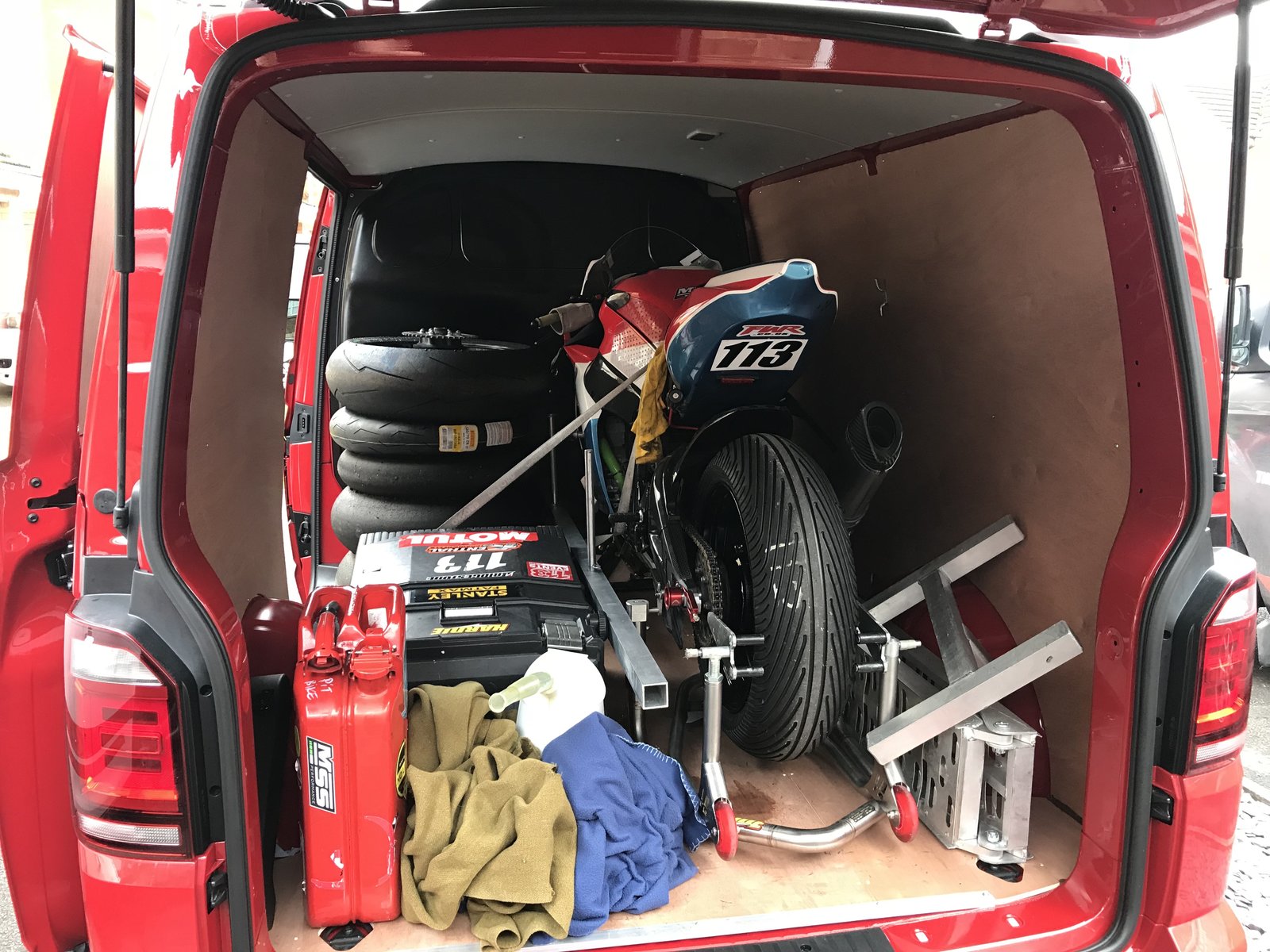

    I've just loaded up now ready to head up there tomorrow for a bit of probably very wet set up as just had a full new Ktech suspension set fitted to my bike IMG_1771.JPG
  16. So these are wet weather tyres then? ;)

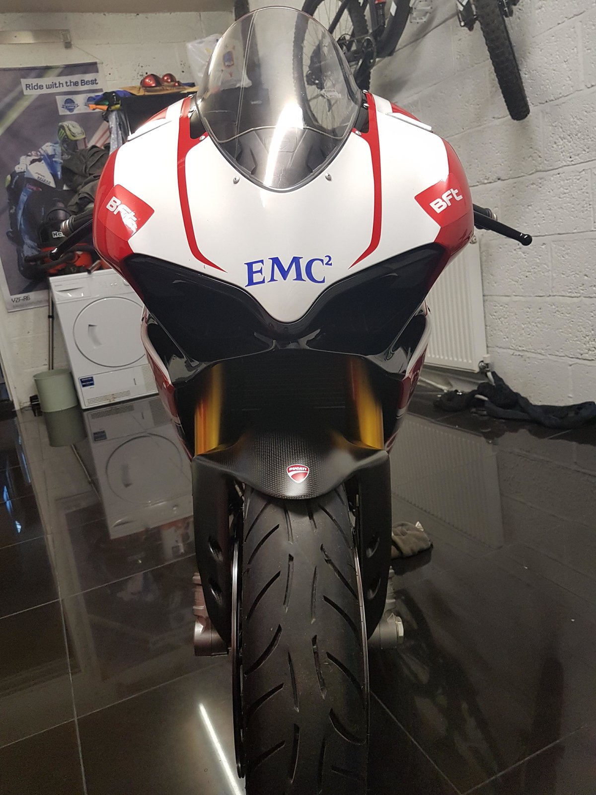

  17. Track fairings on
