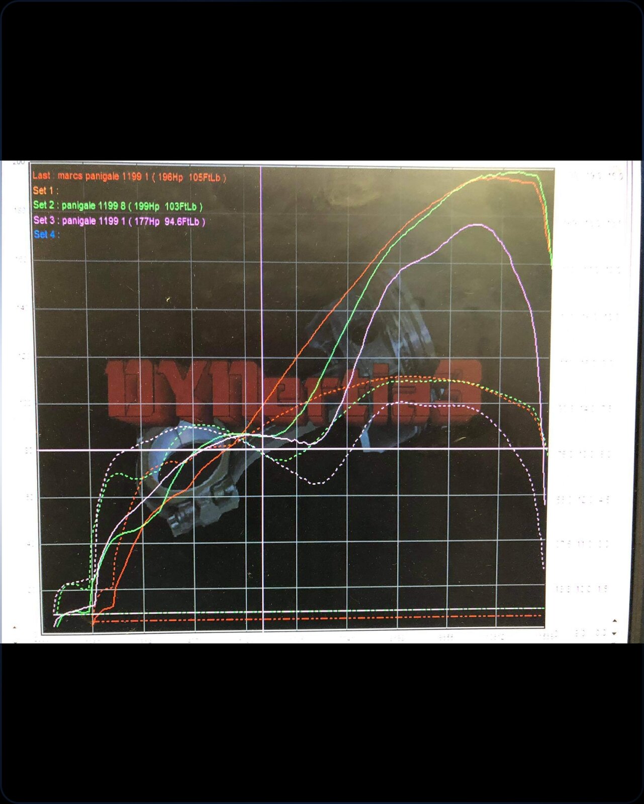

  10. I know it's not a 1299 but it's a remap and race cans on an 1199. Bottom end is better and less jerky. I would assume a 1299 could get much better mid range, but this is like riding a big 2 stroke.
    Wheelie control can't cope, but it is much more controllable I would certainly get a good remap on a Panigale. Pink and green lines are mine, red is a remapped and blueprinted 1999. All runs on same dyno and same day so mostly comparable.

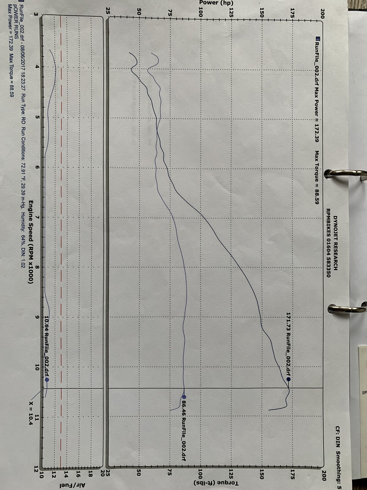

    Have you both fitted the RBE? The numbers you have achieved are impressive. My 1199 has a Moto Rapido SSTK 13 pro ecu program, Full Reparto Corse Termi system with the sprint filter and the Dyno charts (dated 2017) are reading 172 max BHP and 86 torques!

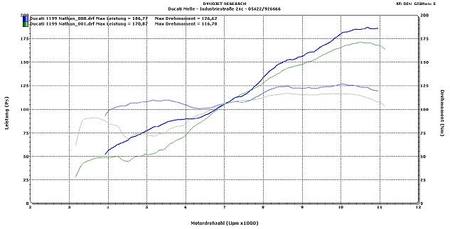

    my 1199s has a set of Carrillo rods fitted and nothing else internally, a Sprint filter, and standard ECU mapping ( no Up map) with this set up and my RBE and Termi Evo3 SStk system fitted I pulled 171 at the back wheel. ( different run to the one selected in the attachment)
    after changing over to the under seat D170 system, and re-zeroing the RBE map, it pulled 186 RWHP.
    the dyno is my Ducati dealer Dynojet system so have no issues with the numbers given so far.
    I was also looking at the SSTK 13 Moto Rapido mapping and what it could give me etc..
    My dealer was also very pleasantly surprised on the gains from the longer manifold system compared to the underslung version, and I wanted to make a base measurement with the termi cans fitted to the D170 manifolds as I have a set of longer SPF cans to fit to try and reduce noise issues on track days
