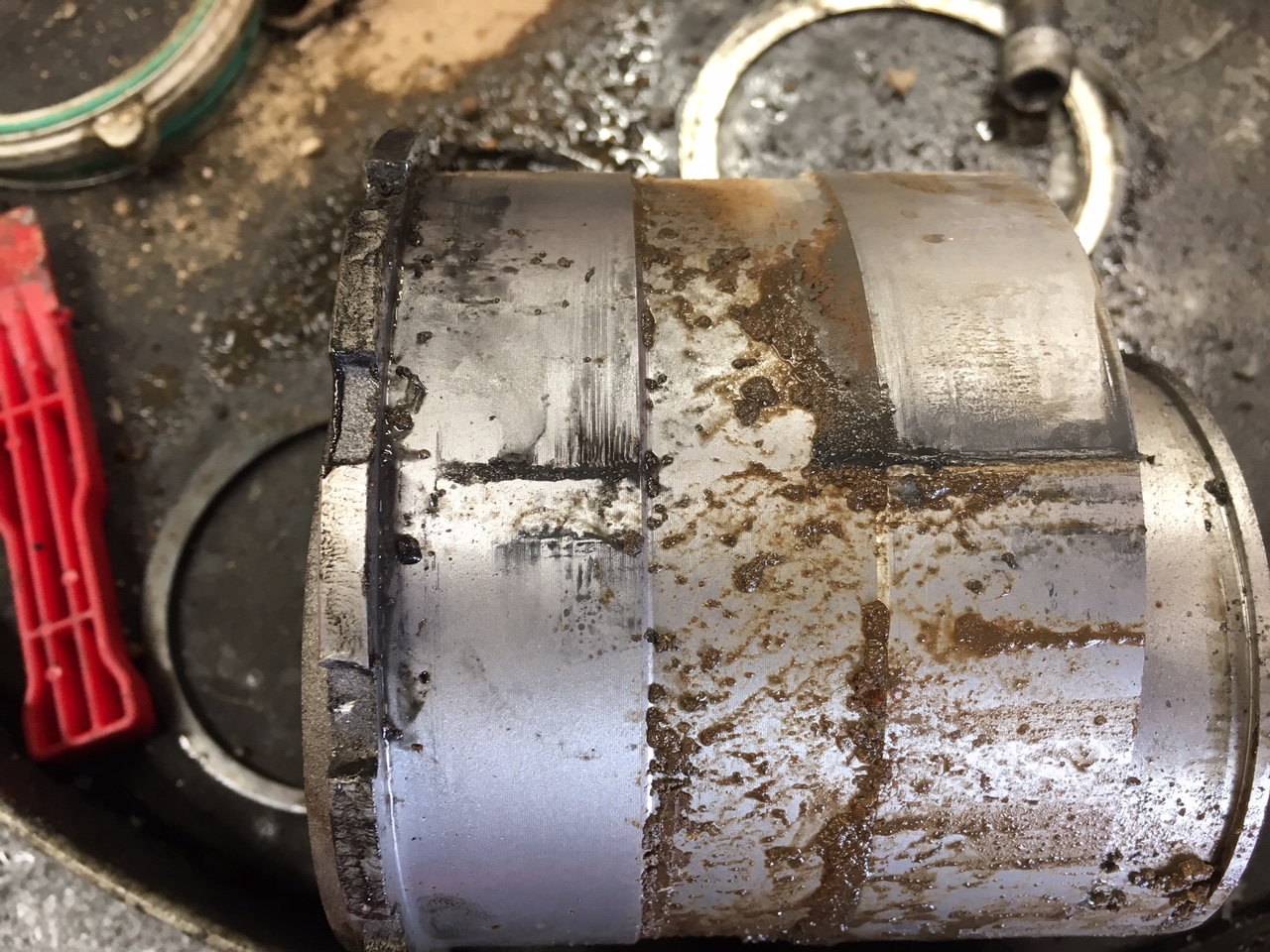

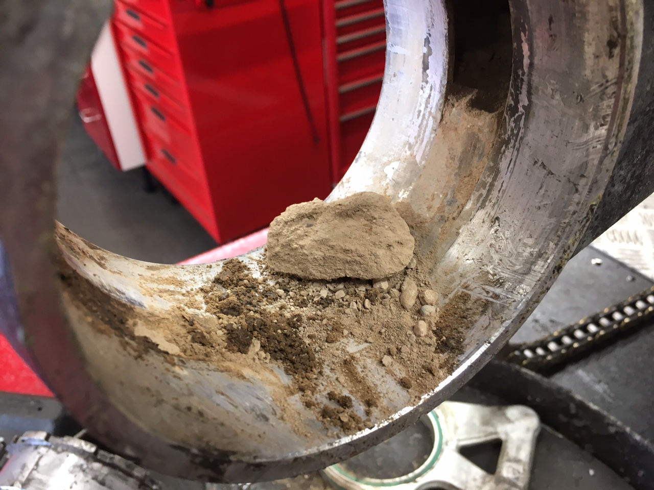

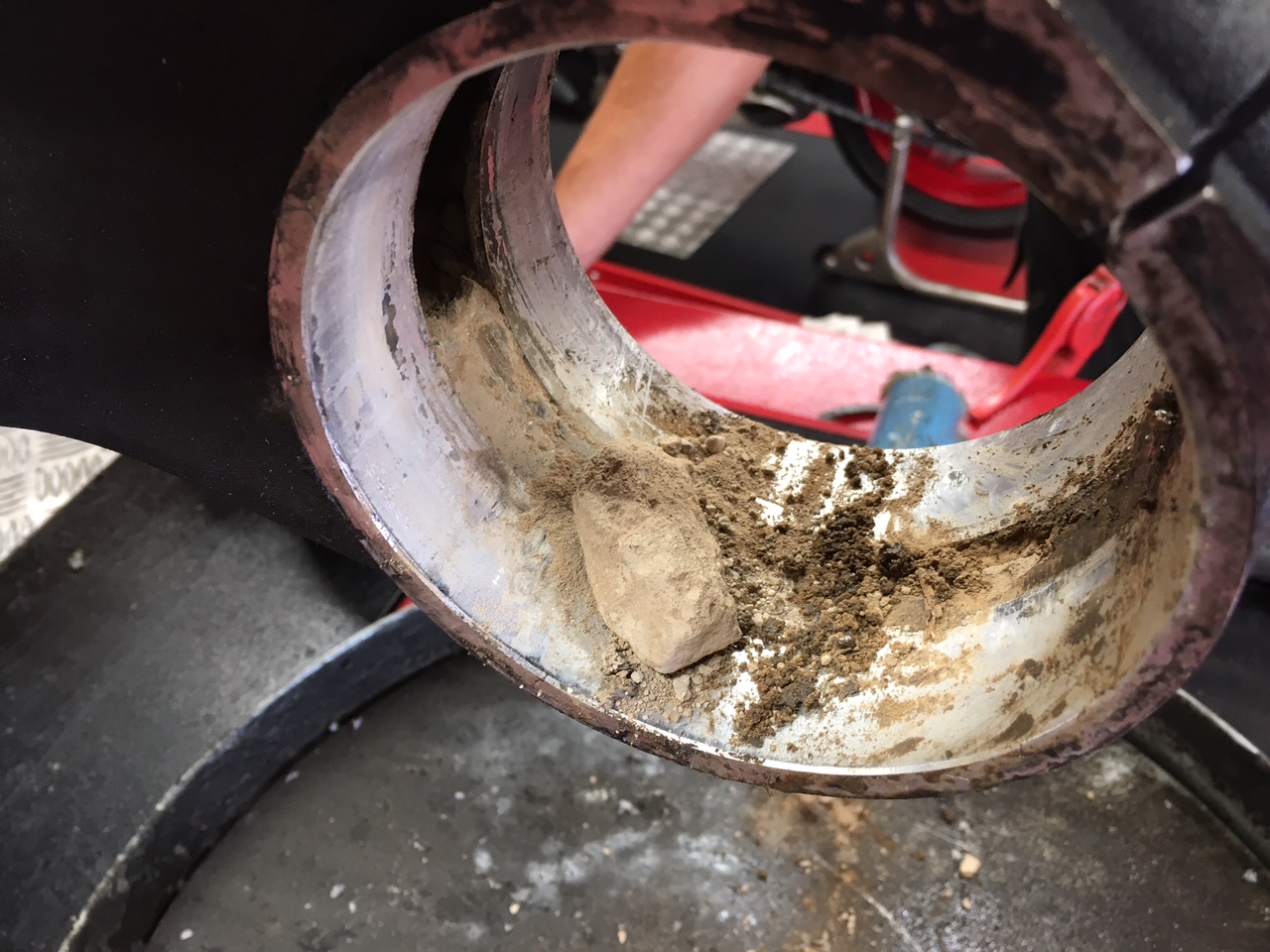

  18. Don't just assume the 15k is a valve inspect and new belts. It's a much bigger job.... Valve inspect is a small part of it. We're in there checking within a hour or so and it's done back up with new belts in around three most of the time.
    The most overlooked is the rear hub service. It should be stripped, cleaned and greased up as well as the bearings. In a perfect world it's a hours job. Nothings ever perfect though. The hub in the pictures is todays task... it's took a good hour and a half to get the bastard out and that's pretty normal.
    Add in the parts, belts, plugs, oil and filter, air filter, usually coolant, brake fluids etc. Time to fit them, rebuild the bike and do the chassis, electrics and diagnostics and the standard hours of 6.6 don't even come close. I allow a day and a half for the job and that's tight.
    £800 is about the going rate, depending upon the labour rate. £150 of that will go to the VAT man. £300 or so on parts. It is a lot of money, but it's about the most hard earned we get. I'd take 4 oil services any day for around the same return.
    Don't get me wrong. I'm all for owners looking after their bikes. I'm happy to help them, but if you put the bike into a service centre then understand it's a lot of work, especially if done properly.
