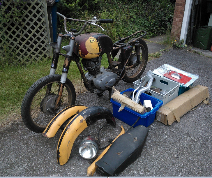

  1. Got it at home now. I think I'll put it loosely together first, and check against the parts book to see what's missing or not usable. Then need to decide what form of restoration to do.
  2. A very wise decision. If you start on a full restoration you should do it out of love, because your unlikely to make your money back on what you'll spend if you ever sell it.
