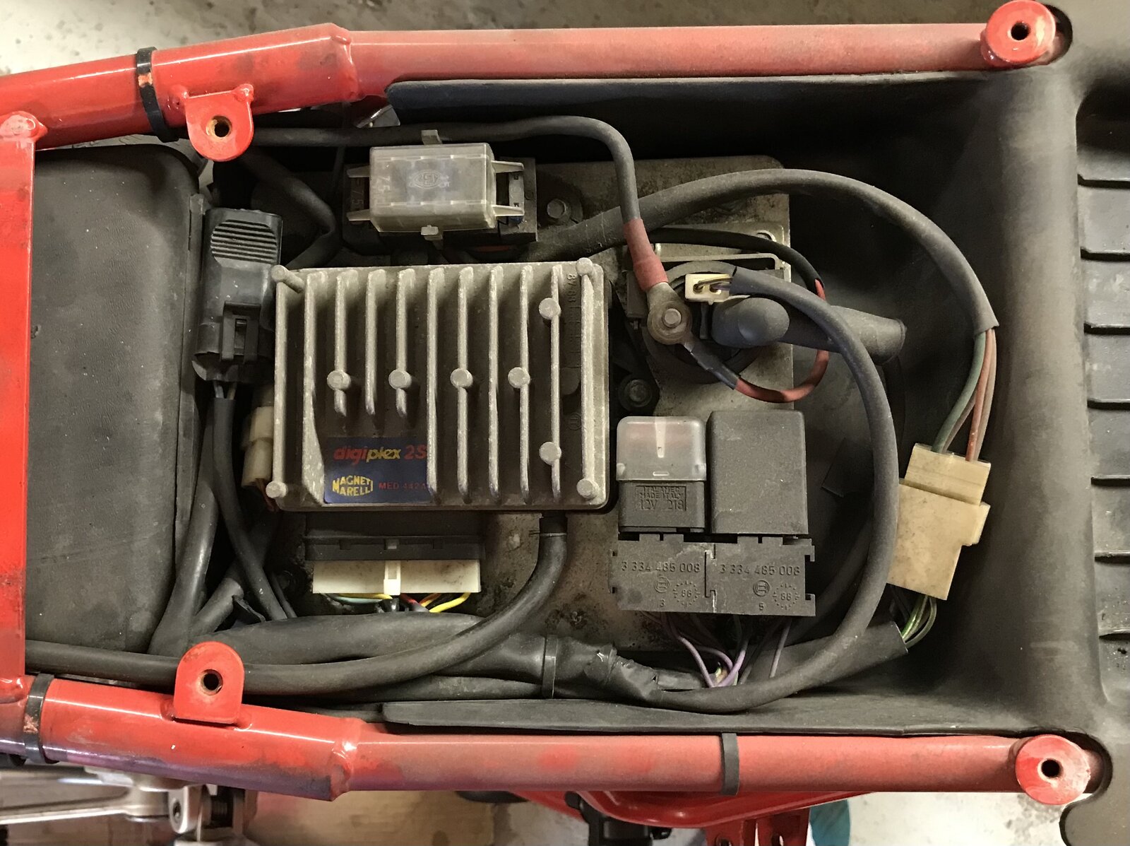

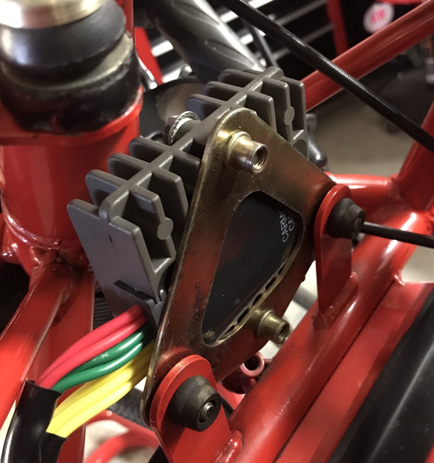

  1. In the meantime, I started putting things back together, where it won’t interfere with exhaust valves access.

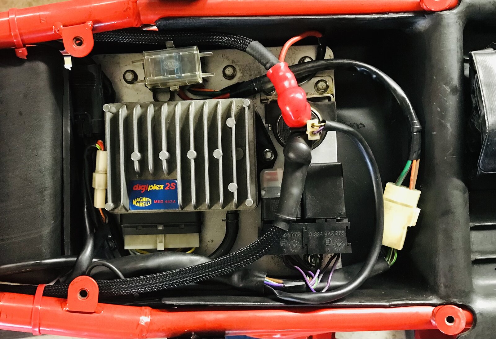

    Brand new MOSFET r/r: 4D7BD670-2EE2-4E9A-8FD1-85968AEB9E05.jpeg

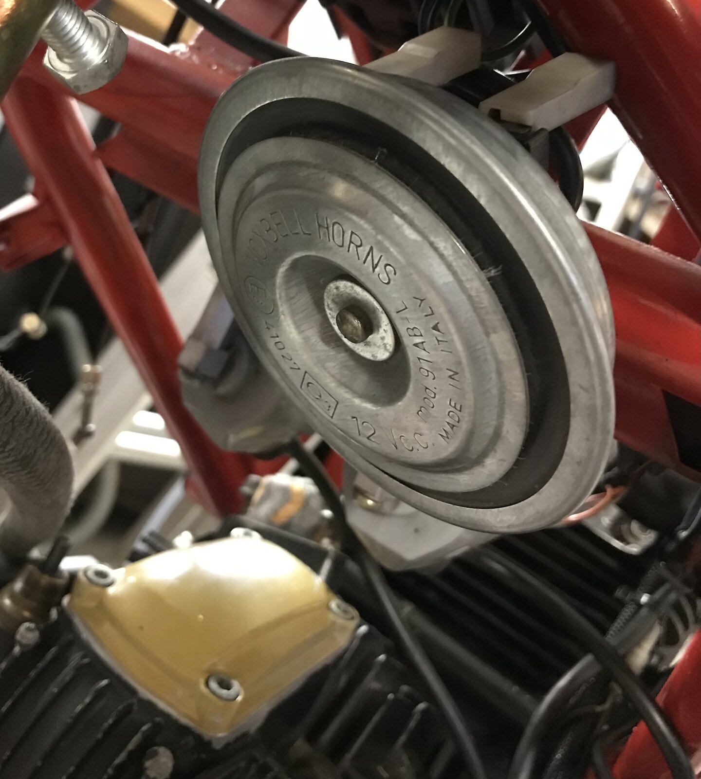

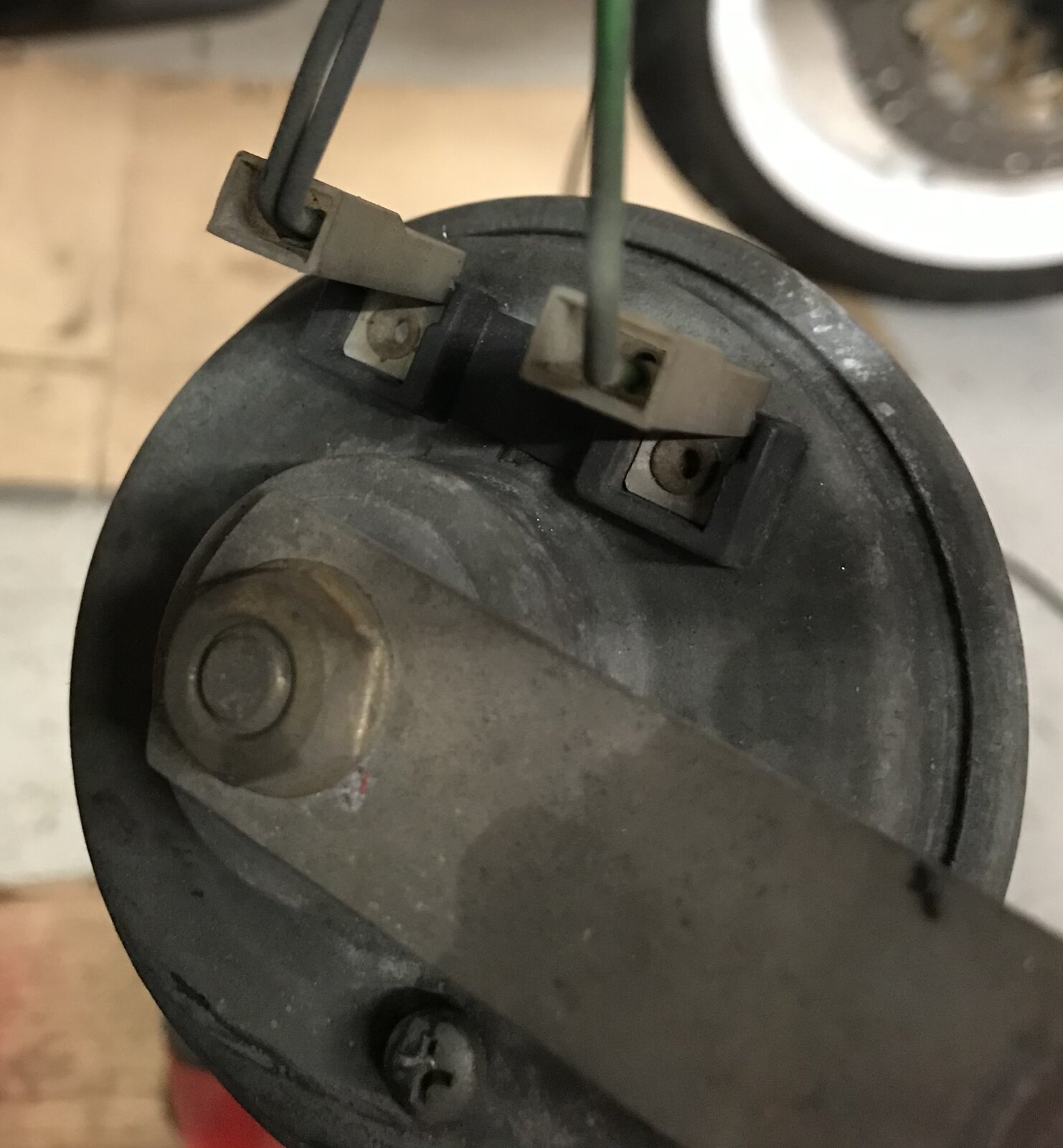

    Cleaned horn (1st pic is before):
    049A3553-19F4-46CE-B1BC-0B346C847E44.jpeg CDE68C60-35CE-49B8-AC39-07AC26B306F9.jpeg

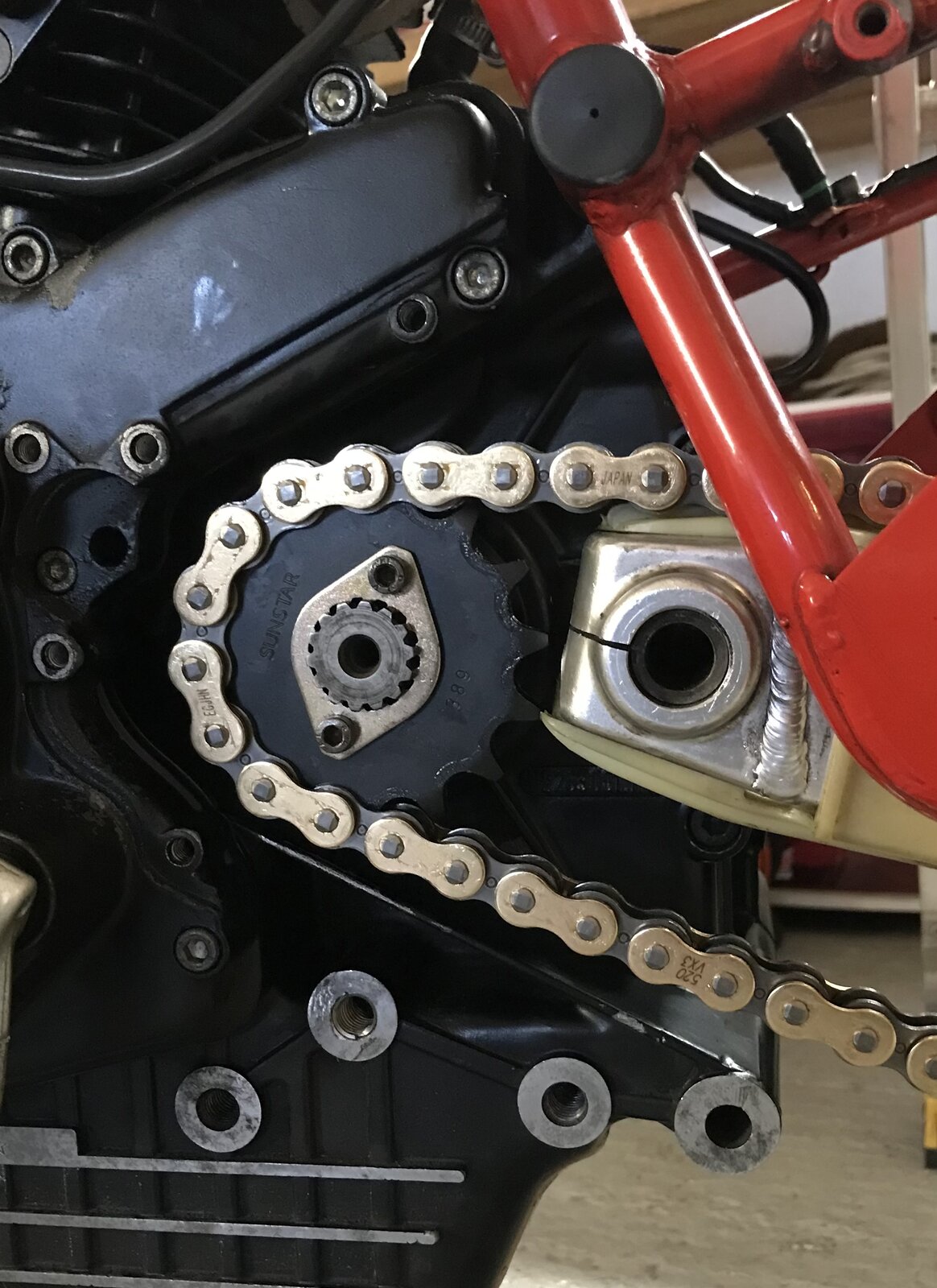

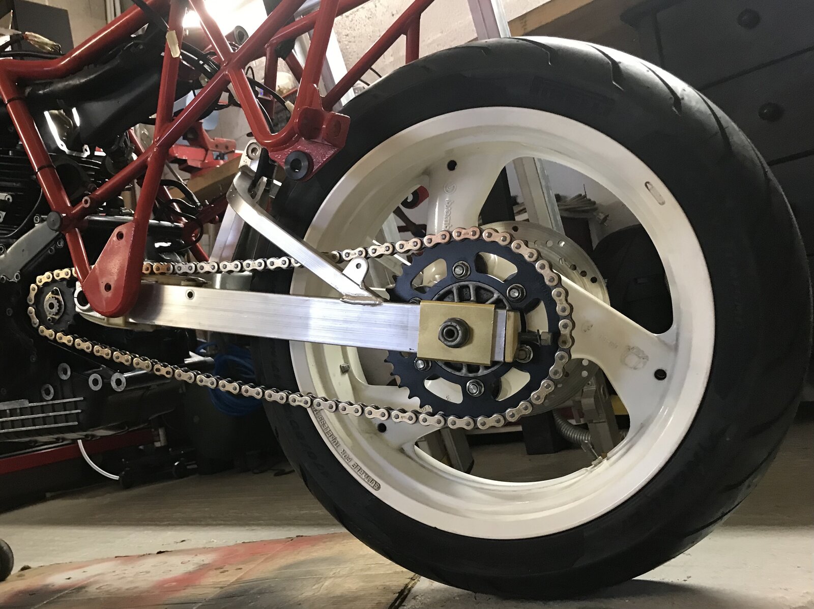

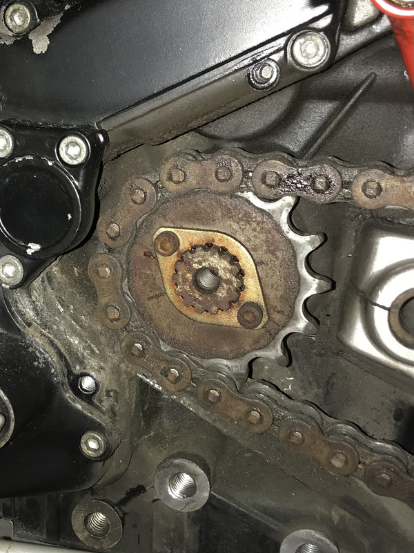

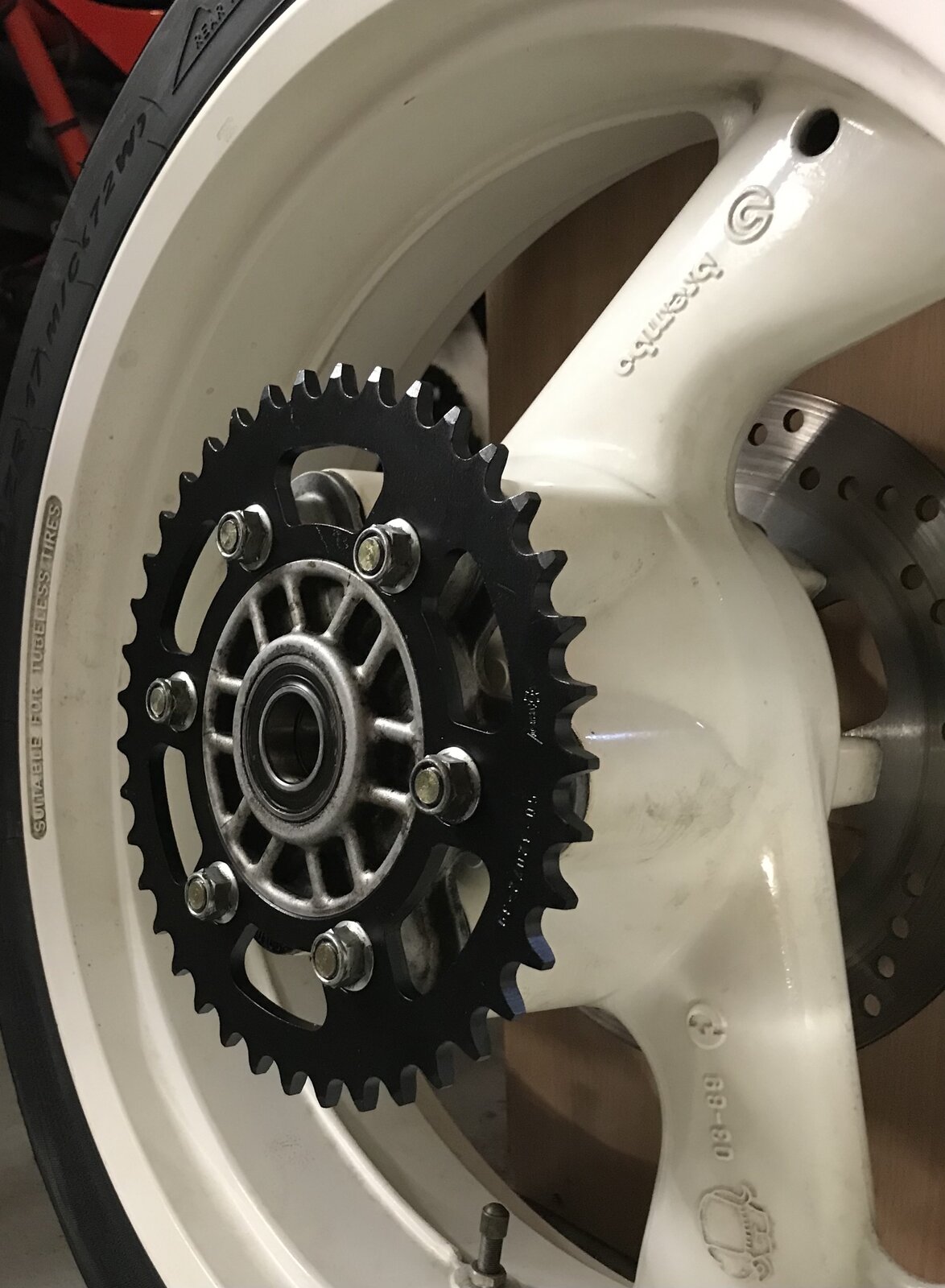

    And last but not least, new chain and sprockets: C8B37CF9-9D37-4F3F-840A-A7DDB69A06C4.jpeg 1C5B9C50-15EF-49A9-AE2F-CC05F42B27F3.jpeg C0BD5B3E-4F37-4DAE-A247-3A7C9FBCDFB5.jpeg ECE4FFF5-846F-4474-B639-F8E90D0F9916.jpeg
    Looking much better than a couple weeks ago ! 3FAC6D53-AC90-40D2-908D-D5E6110D7650.jpeg

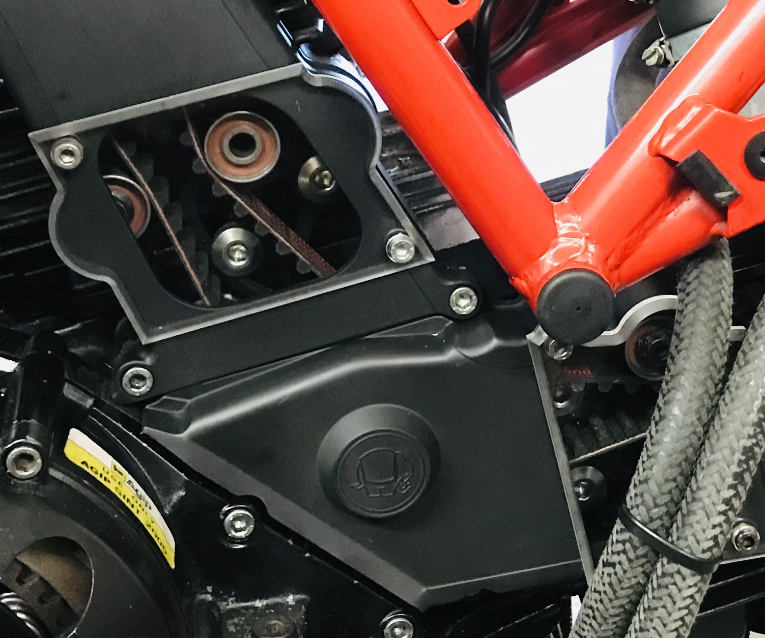

    Put new belts on, new oil + filter + pre-filter (mesh), carby back on after a good cleaning and refurb, new plugs, new battery, tidied the wiring harness, put the front end back together (front wheel and brakes to follow) and waiting for the shock to come back from reconditioning to finish up the rear. B457D5C1-DB6B-44E1-8CAF-69C584D3EF25.jpeg C59C4D2A-F293-42C8-BF5B-7610ADE938F2.jpeg FE0DF864-7018-4DB9-90FF-D6AD28268F72.jpeg

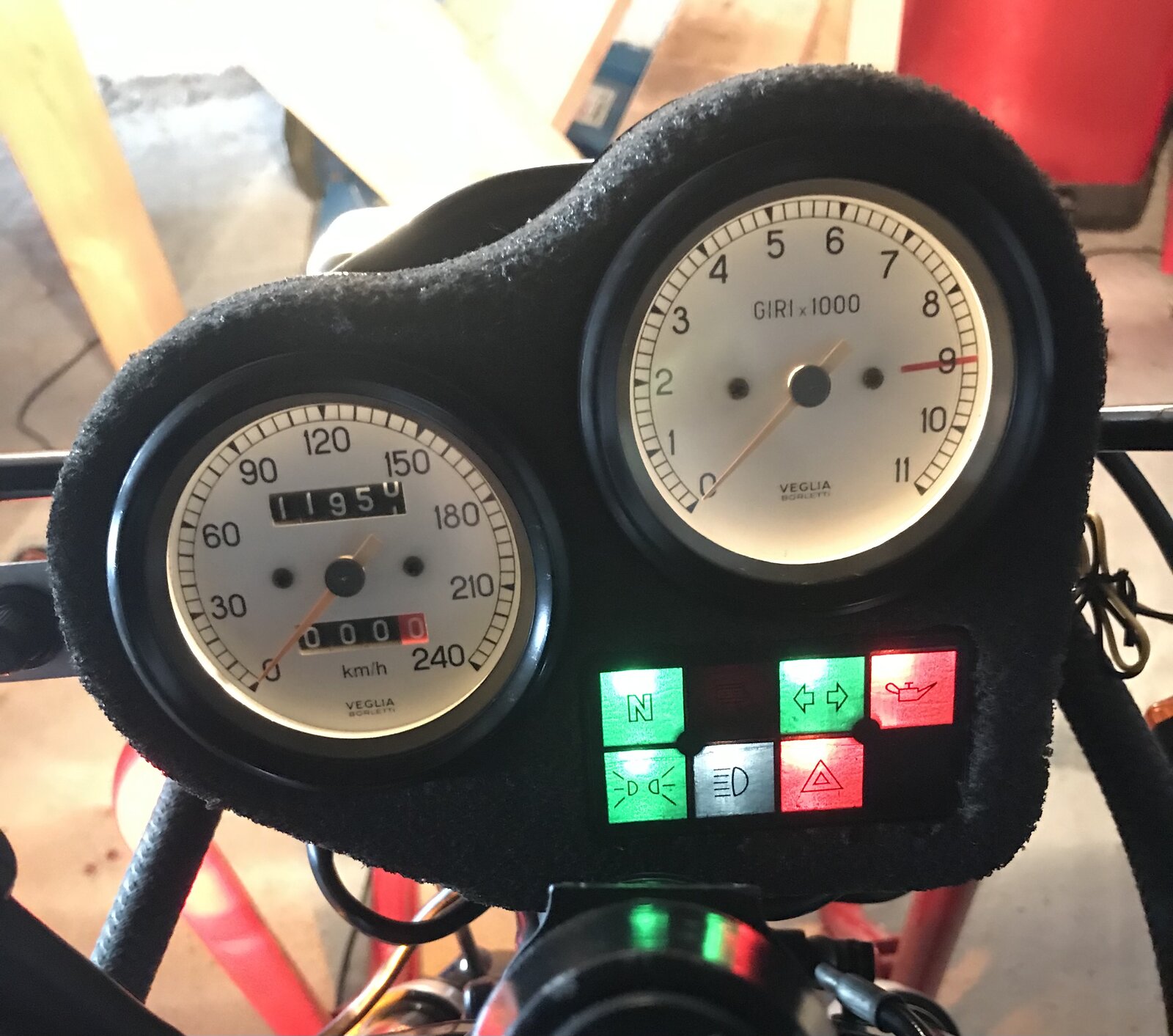

    Plugged everything electrical yesterday and briefly pressed the start button just to see if the starter would turn. Well, with new upgraded cables and LiPoFe4 battery, that thing does want to start with a passion! It’s begging for fuel now.
    Still a few things amiss:
    - Neutral switch light
    - Horn
    - Kill switch (still run on off…)

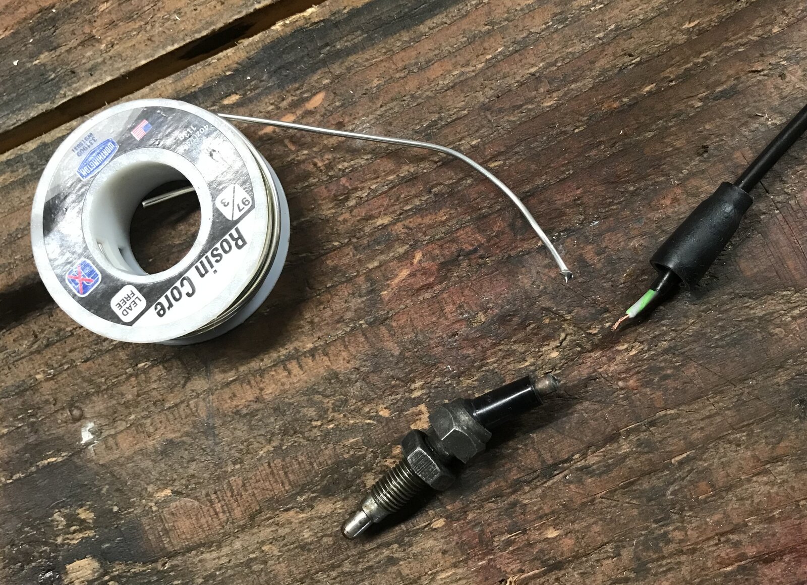

    About the latter, well, unscrewing it from the stand without unplugging the connector from the loom leads to this…
    Nothing a little soldering couldn’t fix, though. 88A81071-2B5D-4A46-9343-23652DCB9F61.jpeg
    Note: Everything works fine on the donor.:upyeah::D 72F0AEE1-FBFA-4A27-B180-285CD7486311.jpeg

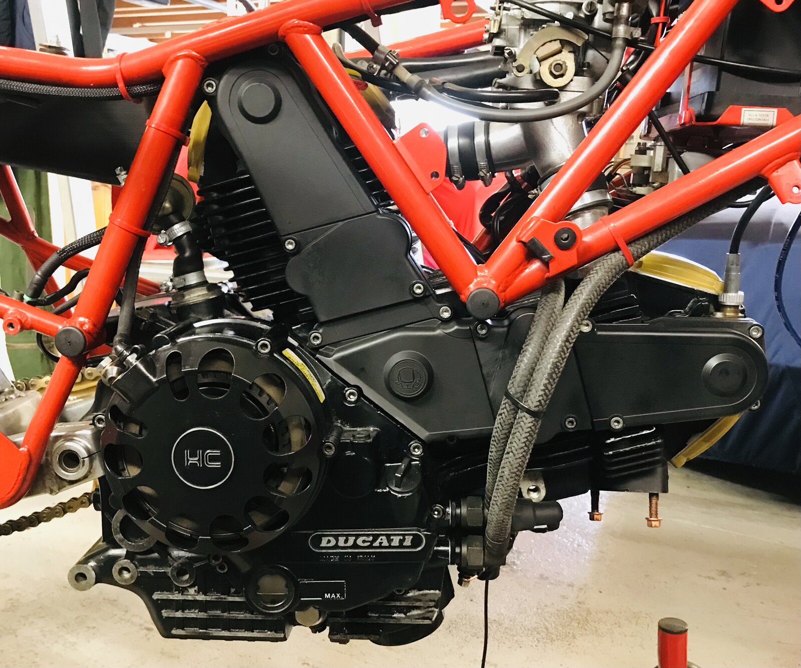

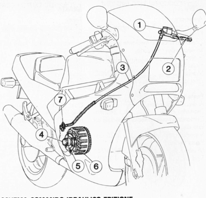

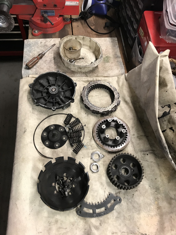

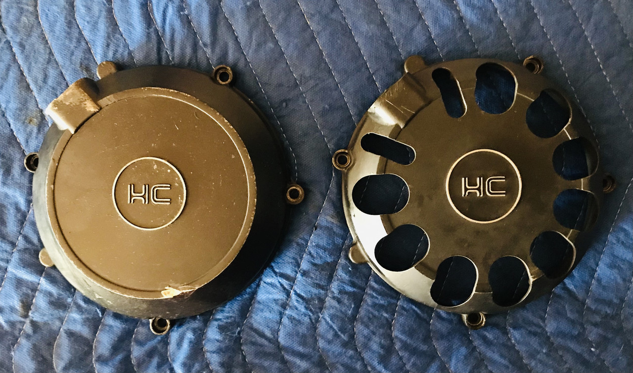

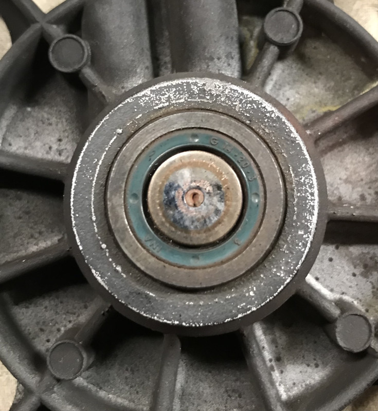

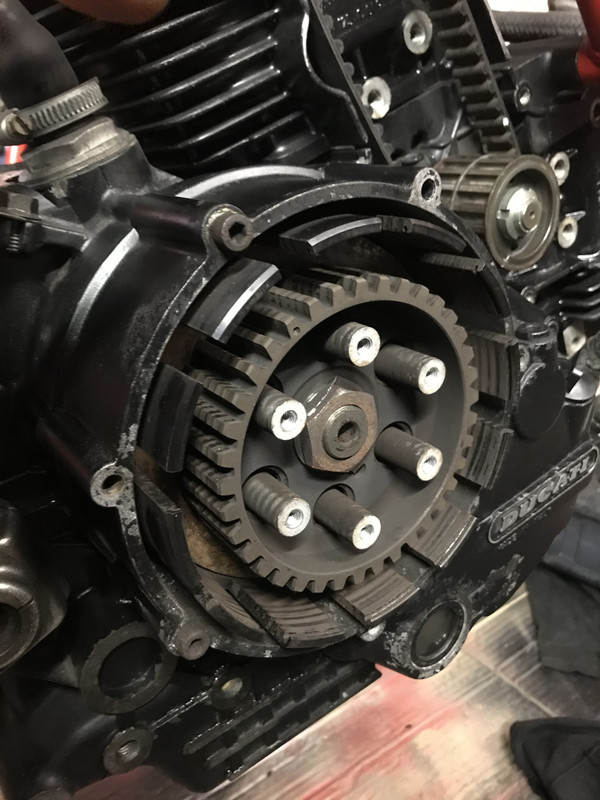

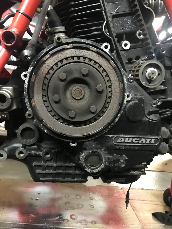

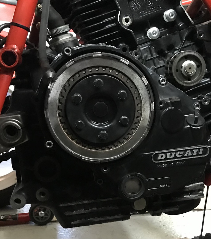

  7. Now about the the clutch.
    This is something I tackled a couple weeks ago. These still have what I believe is called an inverted clutch: the slave is on the right hand side, built in the clutch cover, with the piston right in the middle, pushing the pressure plate inward (as opposed to the more recent system with the slave on the left and a clutch rod pushing the plate outwards). 4BCC551A-4C96-4C45-AFE4-AEACDC79E39A.jpeg

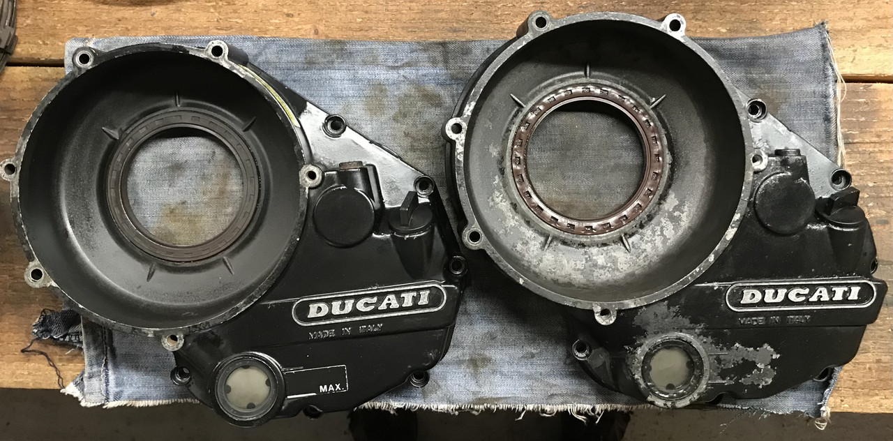

    It is simpler, conceptually, but has a few downsides. First, the cover is a bear to bleed. Second, when not used for a while, the piston tends to seize in the middle of the cover. And those covers are pretty hard to find if it needs to be replaced. Pistons can still be found new but cost a fortune. Having two bikes, I decided to overhaul both clutches at the same time to see exactly where I was starting from and get what cosmetically looks the best on the chosen bike.
    Chosen bike:
    - Closed OEM cover.
    - Clutch internals (basket, drum, discs) looking pretty good.
    - Piston looking nice and not seized.
    - Left side (oil pump) cover flaking.
    8CCE9406-C758-4189-8686-0AB61ADED87D.jpeg B70292FA-712A-4F2D-A948-E863EC7FCCA3.jpeg

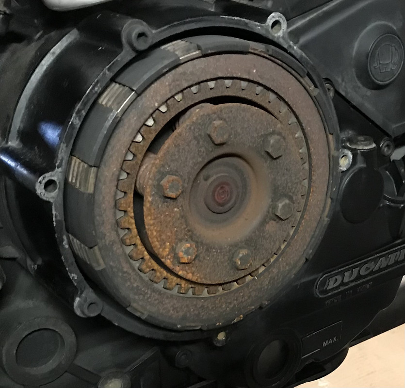

    Donor bike:
    - Machined OEM cover (pretty well done if you ask me).
    - Clutch internals (basket, drum, discs) looking dirty/rusty. Bike must have been stored outside exposed to wet weather. Basket and drum in good shape, though, but discs shot.
    - Piston seized, obviously…:rolleyes:
    - Left side (oil pump) cover looking much better. 85AC21B3-946C-4936-BF8A-E704E32E63DD.jpeg

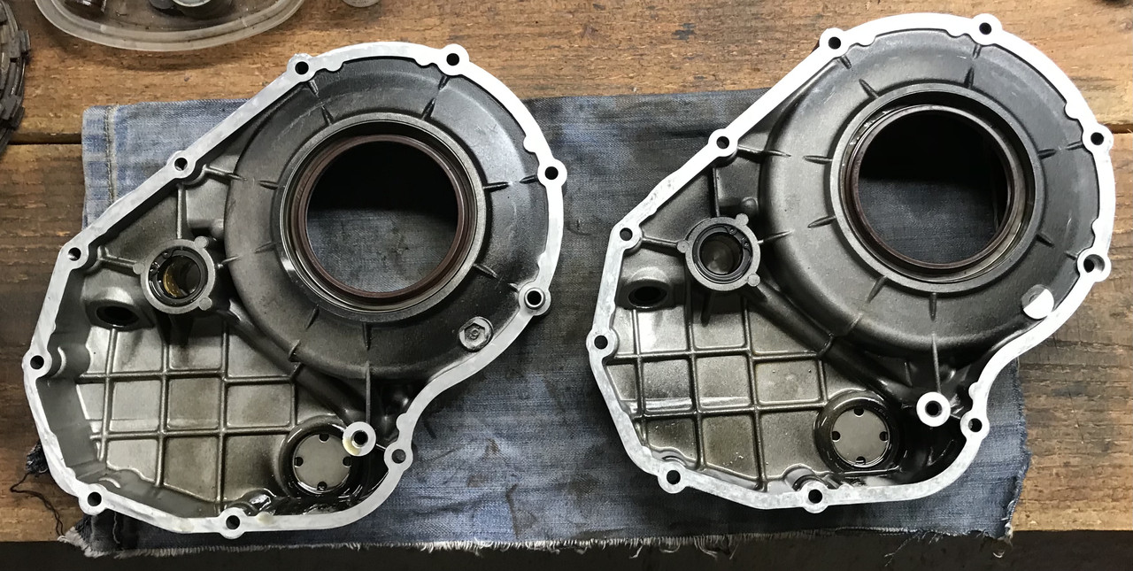

    Here are some side by side comparisons: 8A00D112-95A5-4D08-A91B-2F7A53AD45BD.jpeg FE0A4609-56EB-4A75-955C-2AECEB188F06.jpeg F9DE738F-0289-4E07-B1C6-A1E18D16F379.jpeg 9B4769D3-5498-409A-A0BE-7E4EB7CA4015.jpeg
    At this point, I decided the following :
    1/ Chosen bike gets the machined cover with new piston (that’s how I know they are expensive…), new discs and gets the donor oil pump cover.
    2/ Donor bike gets closed cover, chosen bike discs and flaking oil pump cover.
    And both get the house elbow grease based grand overhaul treatment.:D E8C5F718-8A1C-41C5-B5A2-CC2C285778AB.jpeg EBAE865E-AEB5-479D-8633-6D56F0FB44DA.jpeg BF6B9A3E-1206-4D6B-8BCC-59D31B93003A.jpeg 6491073F-E2EA-4408-AB53-E8A62308253C.jpeg
    And here’s the final result.
    Donor bike:
    Chosen bike:
    #47 Guillaume69, May 24, 2023

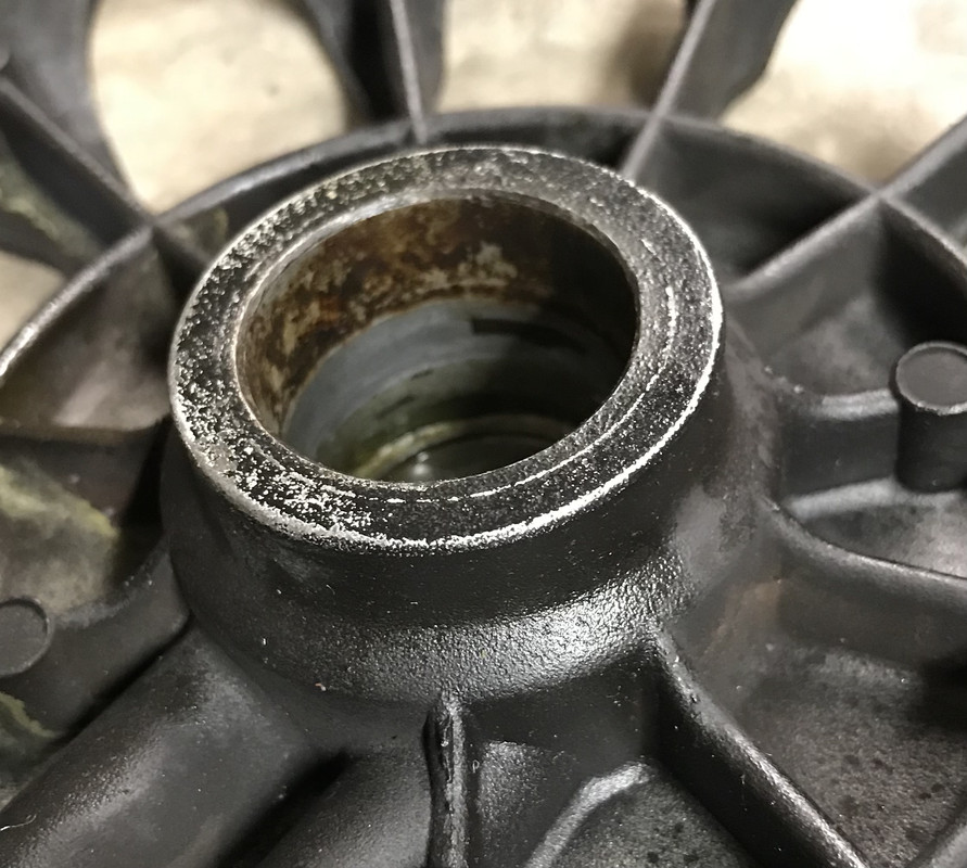

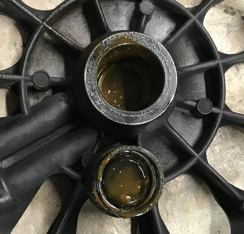

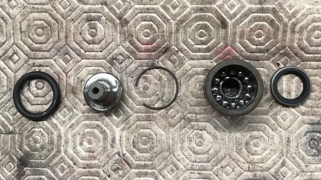

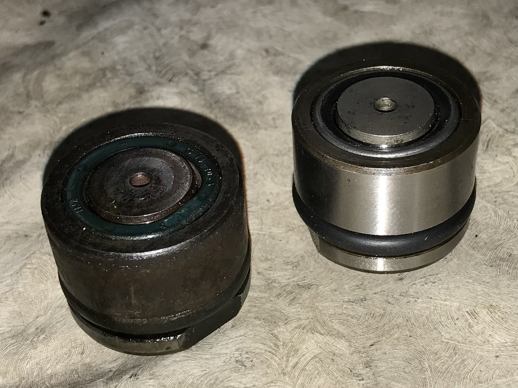

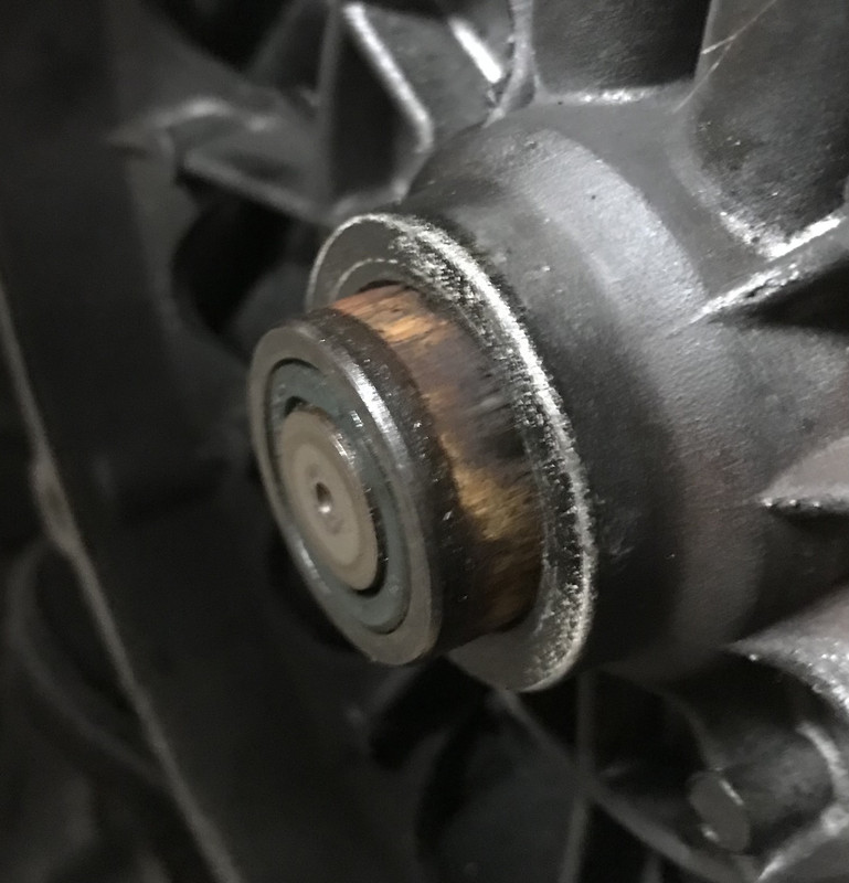

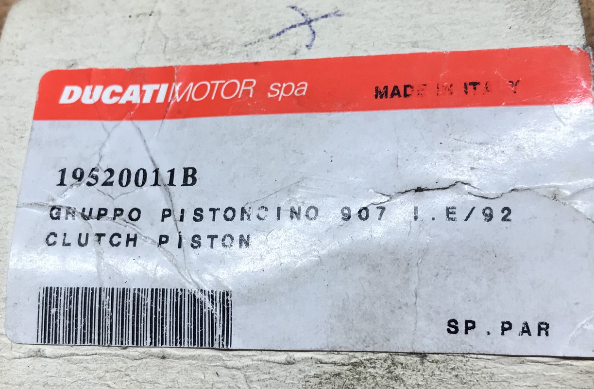

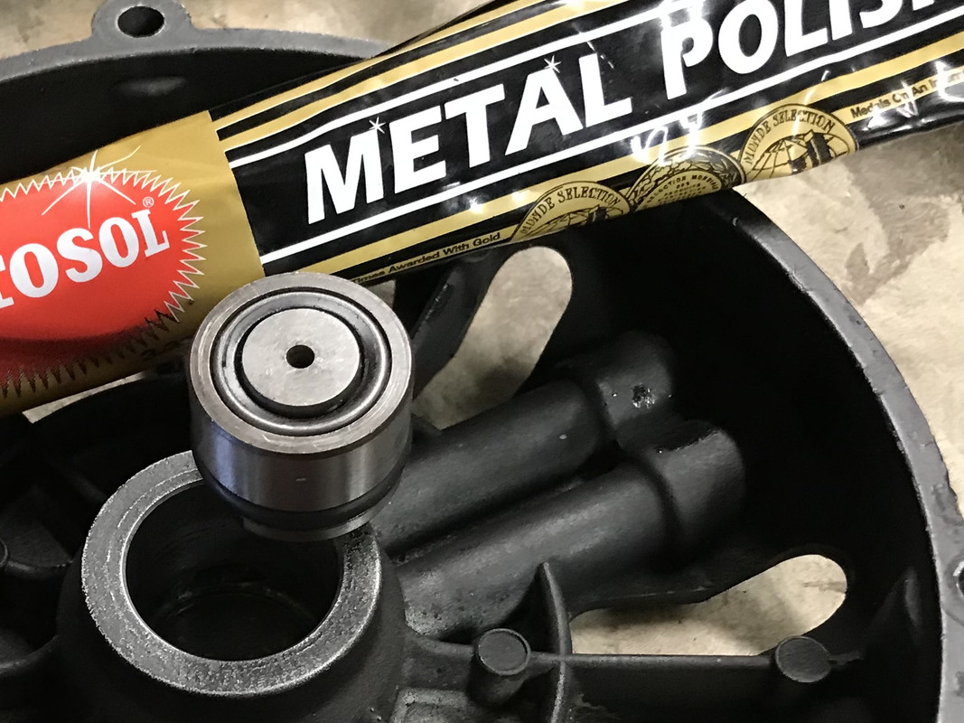

  8. Now, a few words about the seized piston. I initially thought it would nicely pop out using compressed air, like brake caliper pistons. It perfectly worked on the closed cover, but not at all on the open cover. Seized!
    I had to put it back on the bike and refill/bleed the hydraulic to get it out very slowly using the clutch lever. That took a fair amount of time… Ugly and dirty!
    E704CAF5-25F0-4779-A267-2B4831A97F4F.jpeg A55FACDB-0E1C-44FD-A151-6A8E3D1BD5D2.jpeg 1E26C307-B2A9-465F-8937-2C8150B02BF2.jpeg 49A9E6B5-4879-4437-9DB6-AAEB74F50EE4.jpeg

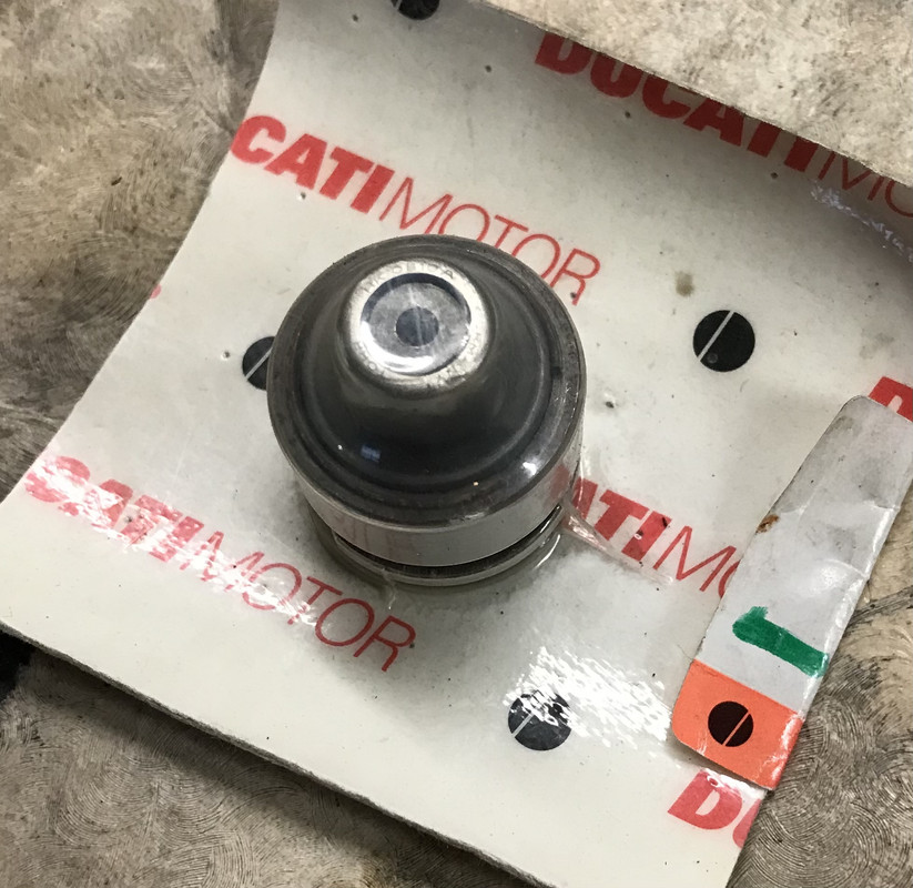

    Here comes a new piston! They come un-assembled so you have to do it yourself. Nothing complicated. Just small. And don’t lose a ball as they are not held together.
    7F02DDD0-17C9-4083-A436-CB32578318BA.jpeg 6F01885A-556E-432B-9B67-4B01F3415F69.jpeg 4ECDFD79-3269-48E7-A4D7-9DFD5635EFFE.jpeg 8FAE49AA-D0C8-4CC8-96AB-E6794F9E23CF.jpeg
    I read on the Paso forum that you can polish the cylinder with Autosol. It does works really well.
    With all this done, I expect both bikes to have a well functioning clutch. We’ll see soon enough.

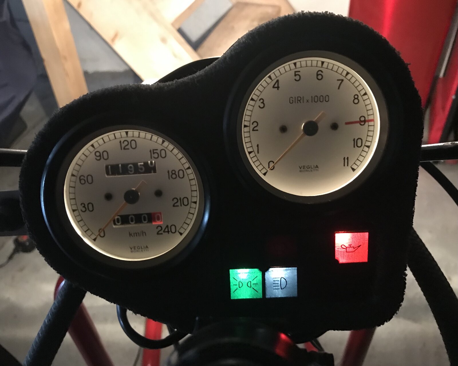

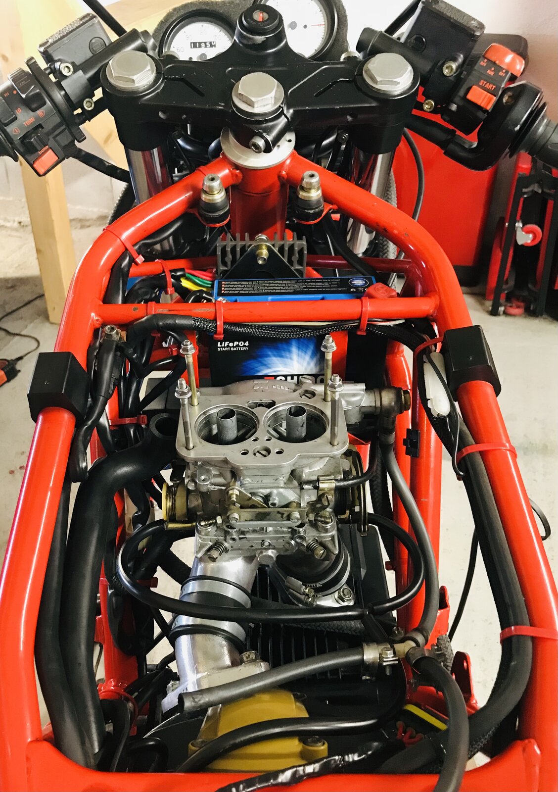

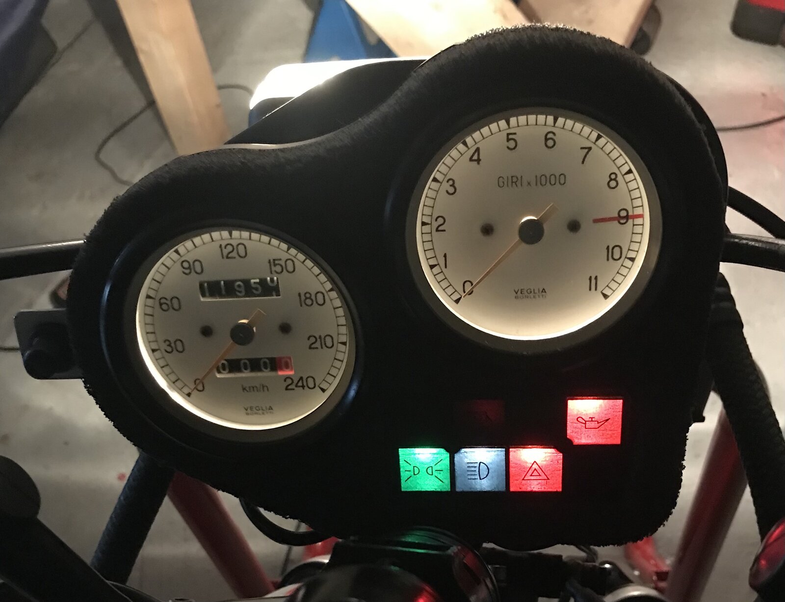

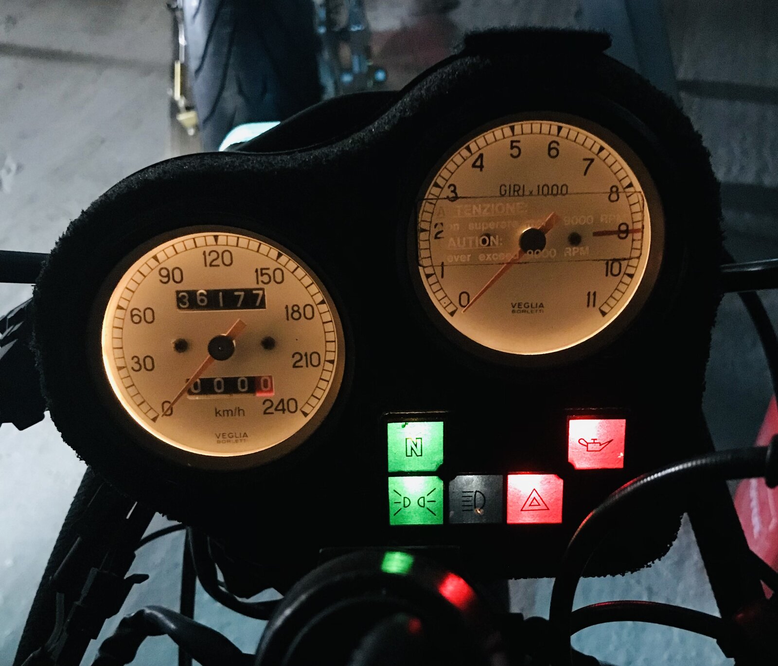

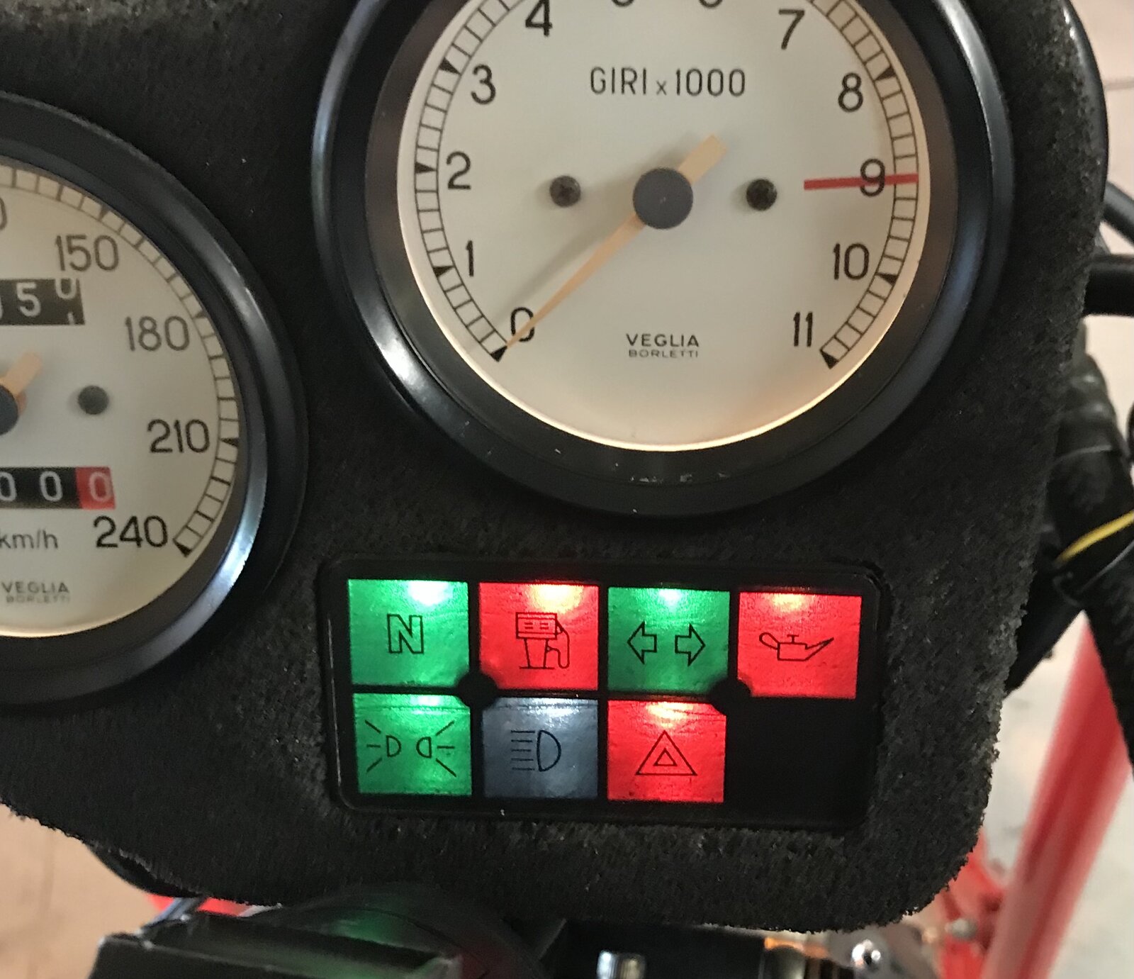

  9. More progress! Just missing the low fuel and charging lights. These will come later. 3570D93A-617A-4FA4-AE2D-950A74ED95B6.jpeg
  10. Getting there. Fuel pump priming too. 588E25FB-71AA-4D2C-B467-6AE03D90E605.jpeg

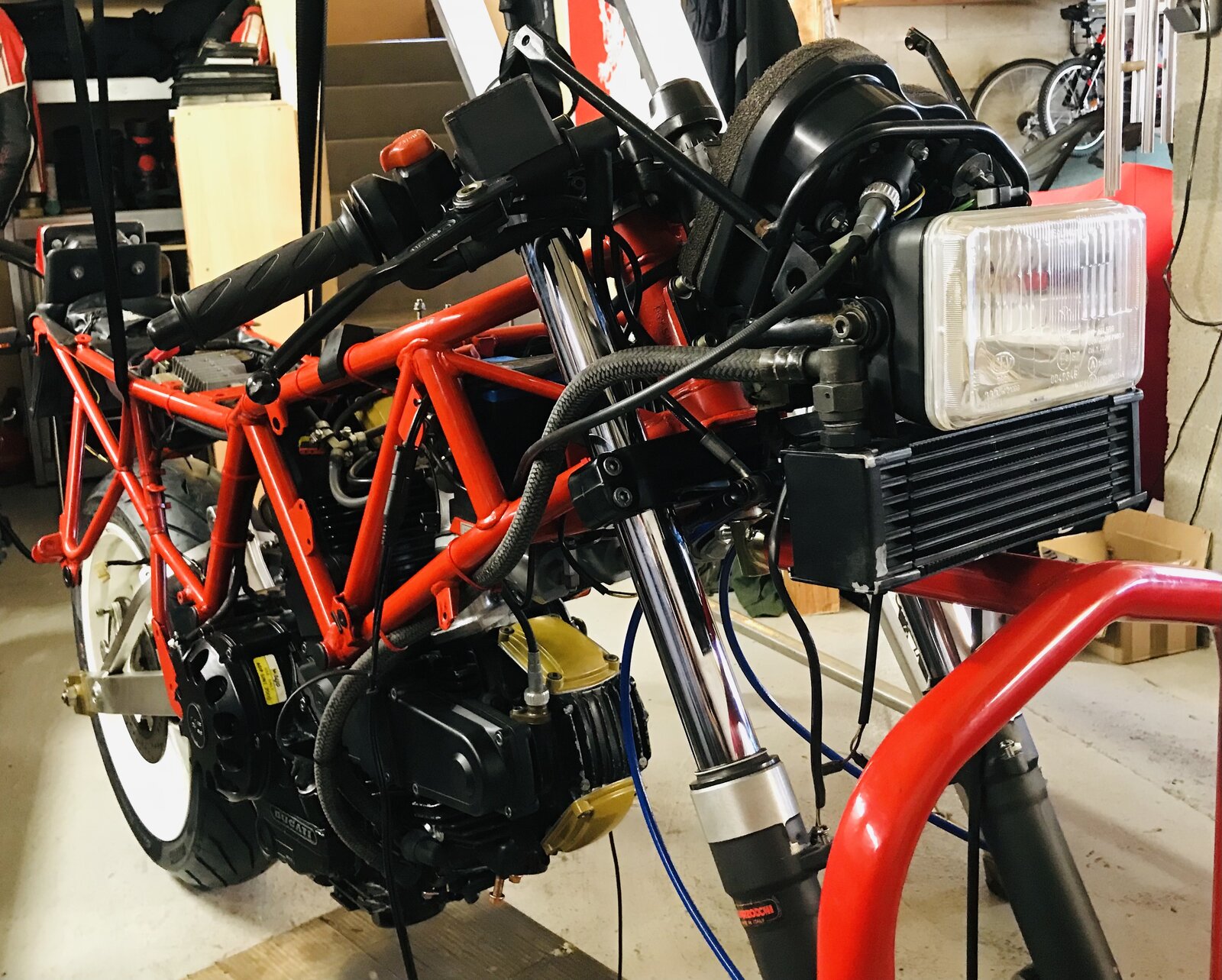

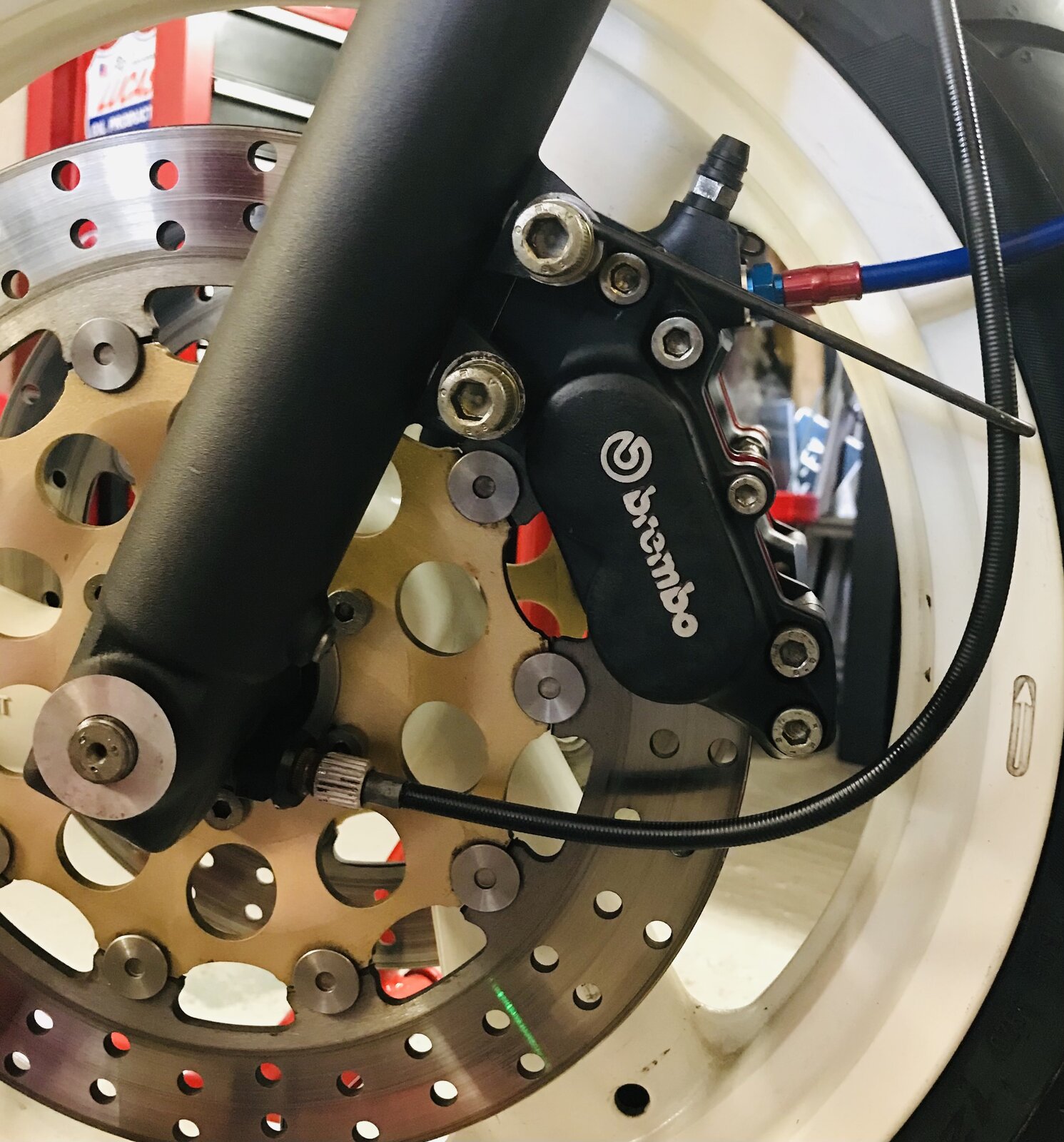

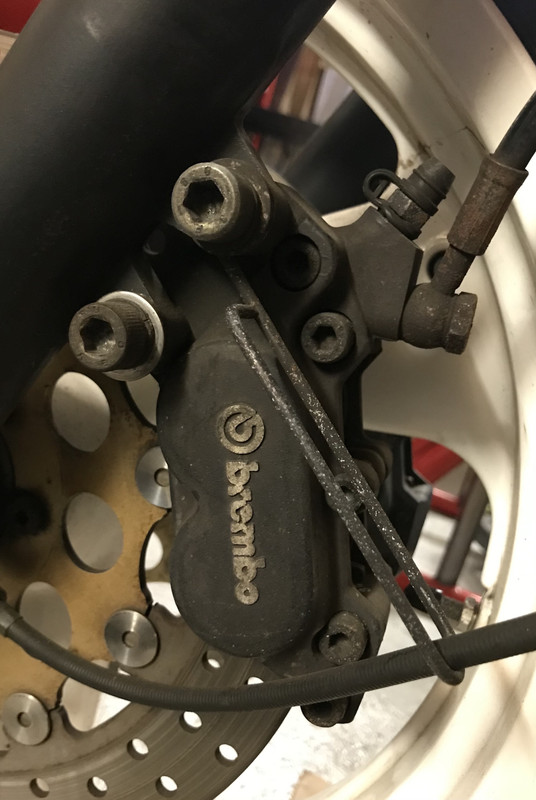

  12. Putting the front back together. Another « before/after ».
    4986267B-45B1-476D-9A93-4A2D9995C080.jpeg 8BED0970-78AC-4AB3-B9FC-1A8AFE416164.jpeg

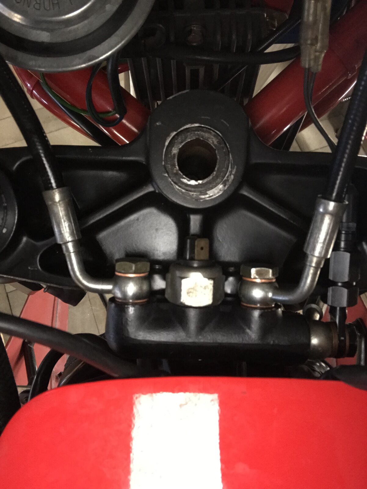

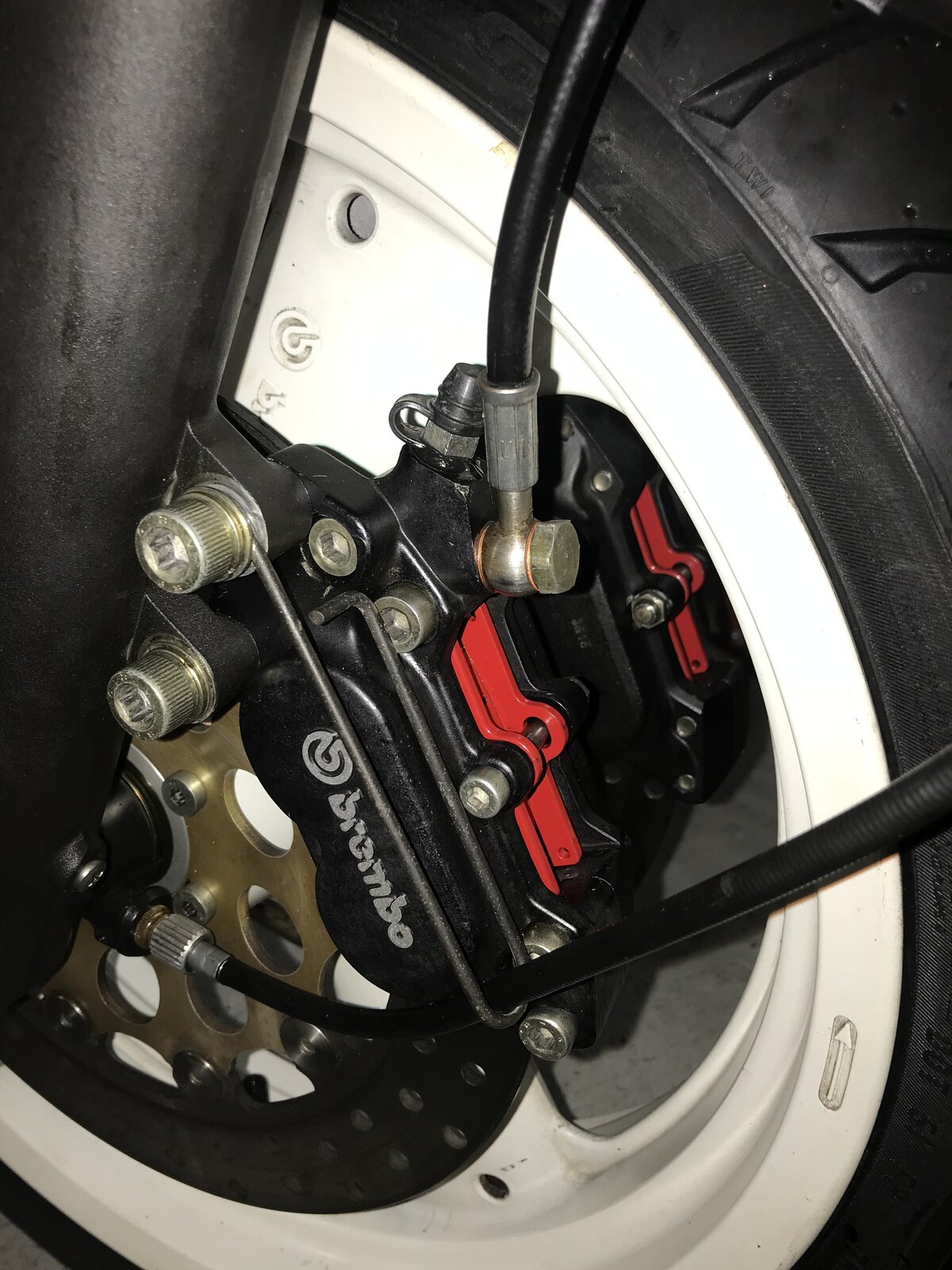

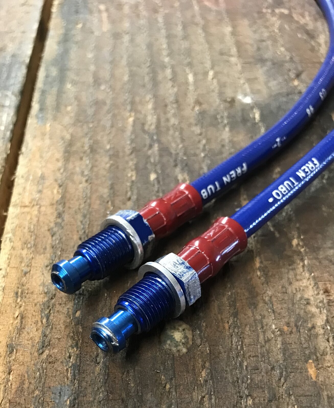

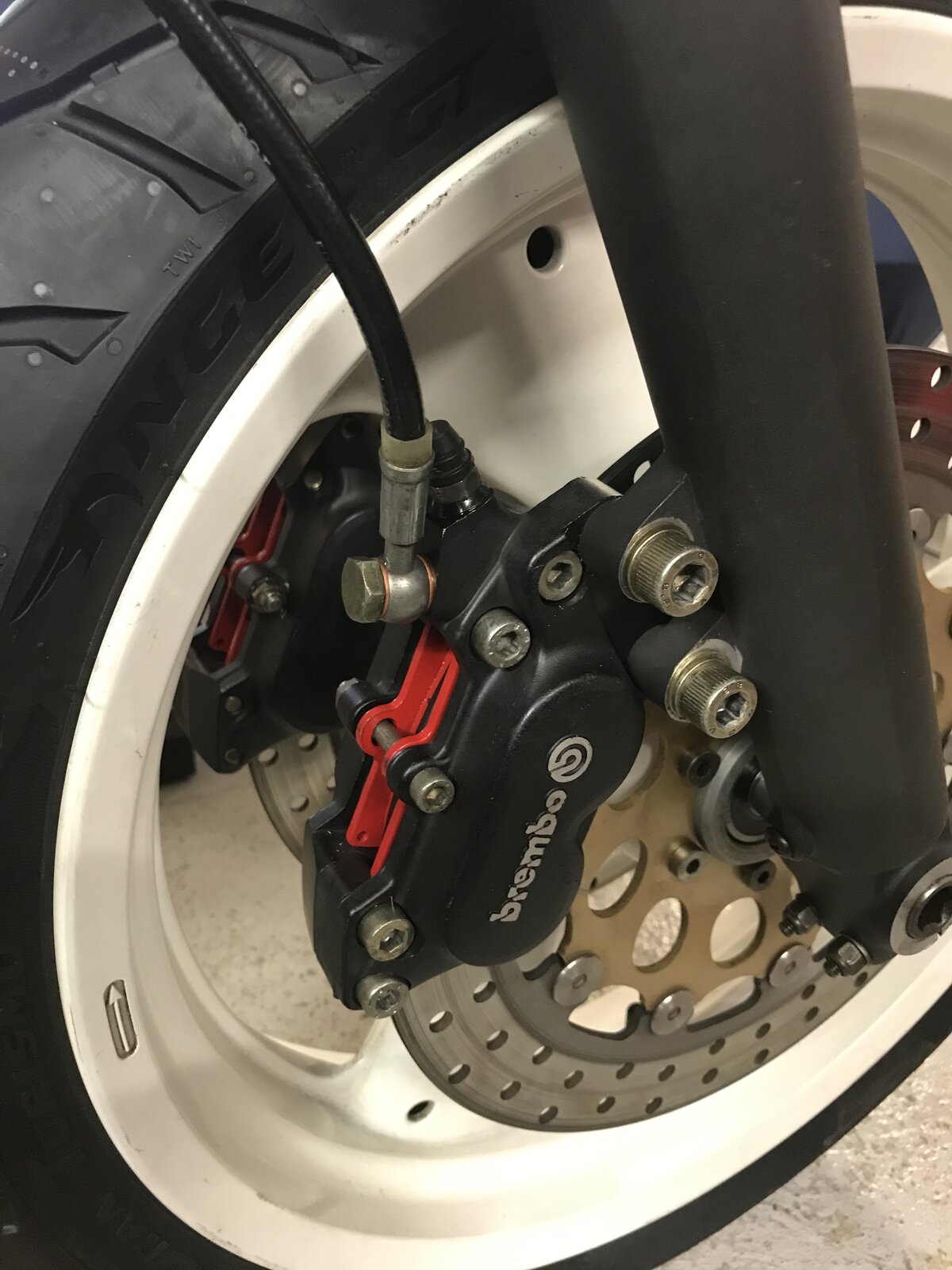

  13. Well, unfortunately, those blue/red DP brake hoses advertised as « 900SS until 1990 » are not fitting well in the front repartitor. I can’t get rid of a little drip on the right hand side. With a production date in 2005, I think these are probably suited for later SSie models… 8FDFC24A-FBA5-4FC6-9532-D1A03878A412.jpeg A35490D4-2EF3-4301-BB44-6464501E2991.jpeg
    I reverted back to the OEM hoses which are in perfect condition and no leak. Refill, bleed, and I have good brakes upfront. And good news, the rear break light pressure switch is working, so good light too. You will notice that the main switch (center of repartitor) has been replaced by a more recent side switch. As it perfectly works with no leaks, I decided to not mess up with it this time round. 1364BDEB-6E36-4229-B707-8E278F69EF93.jpeg 95C38CC1-C925-44B5-B3A6-9A624F962497.jpeg F8544DAA-906E-4CEE-A707-E897A98E2163.jpeg

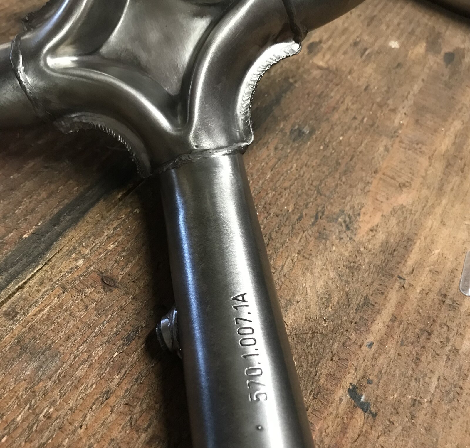

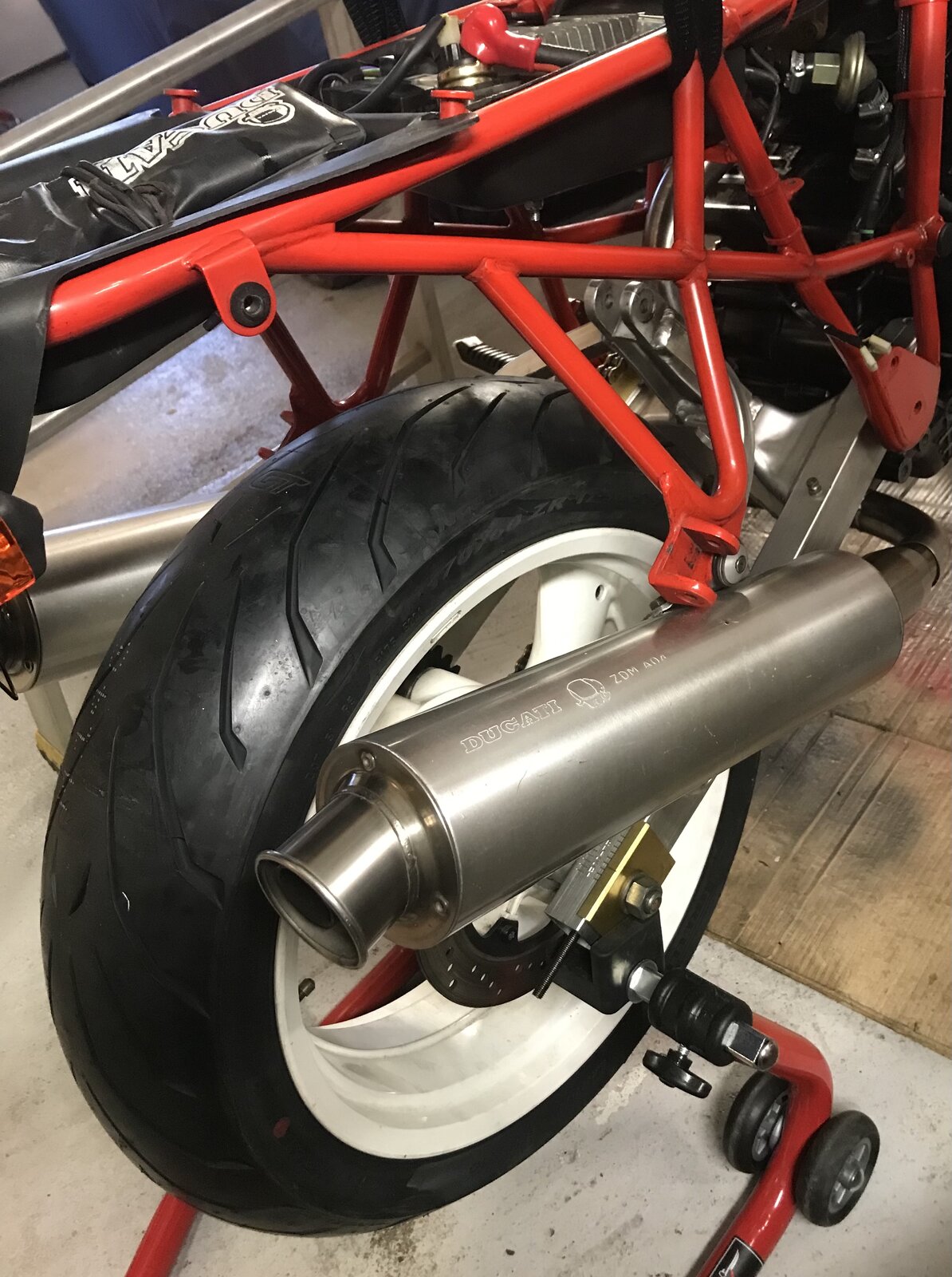

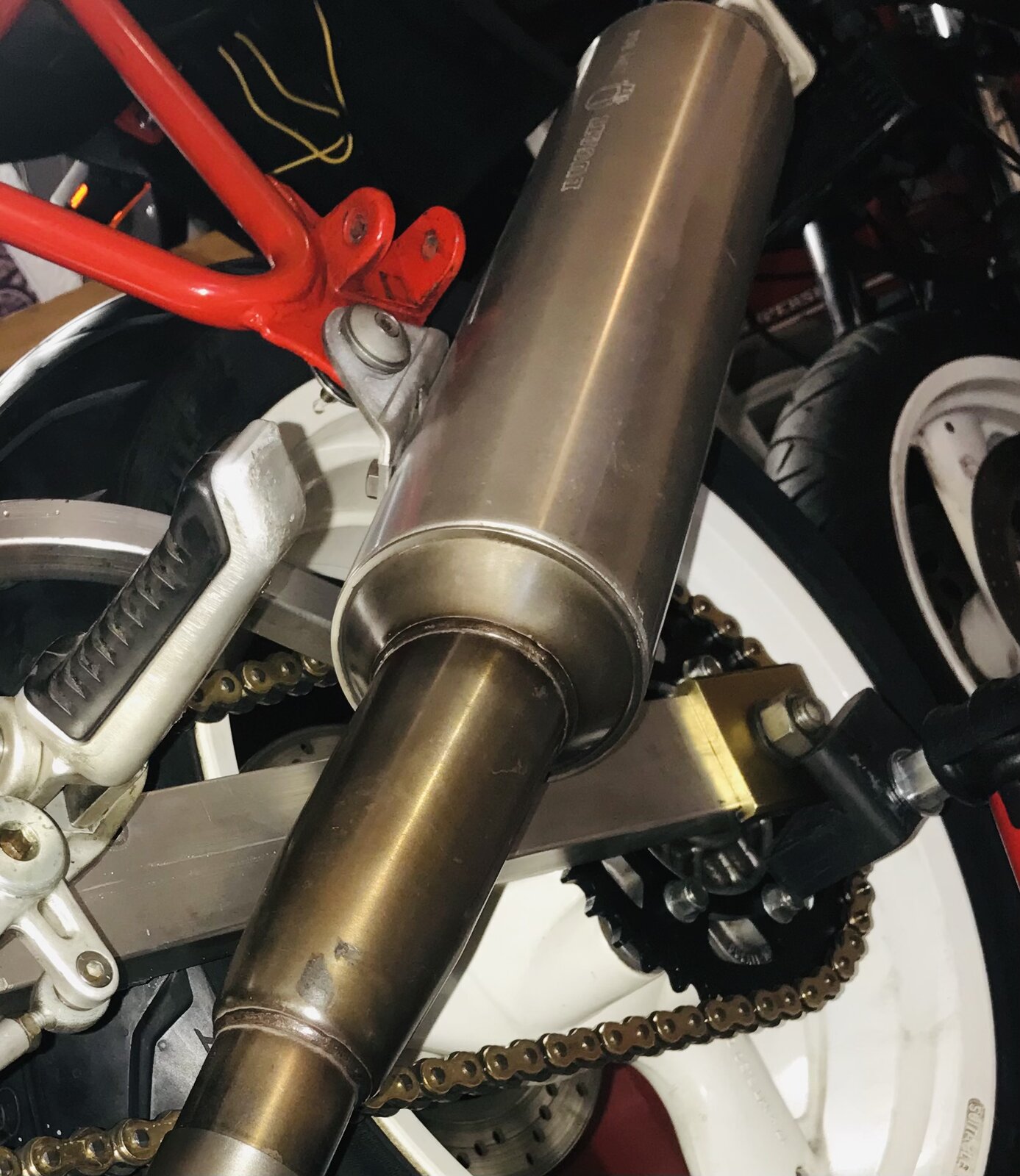

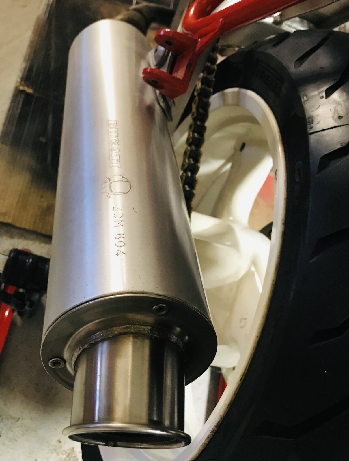

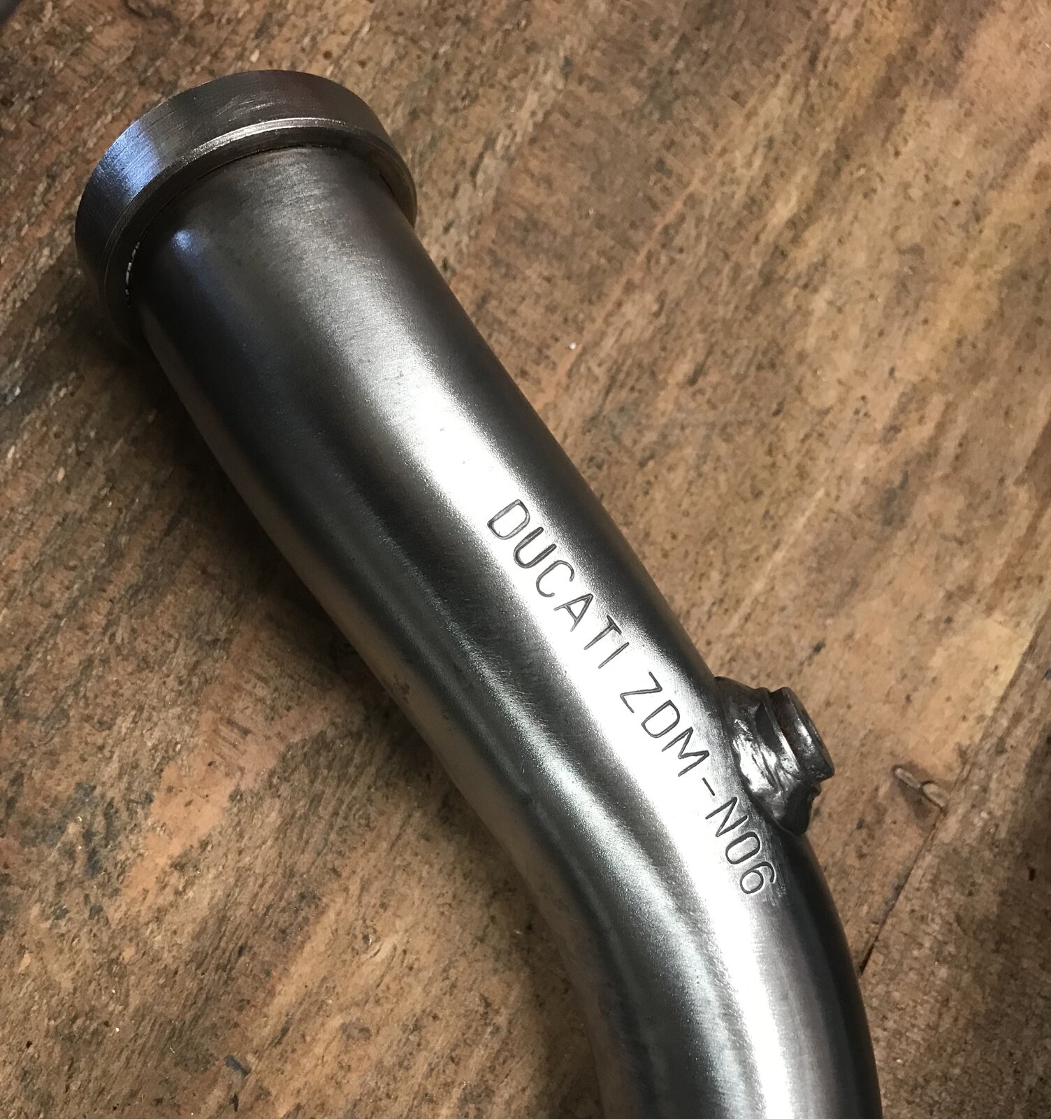

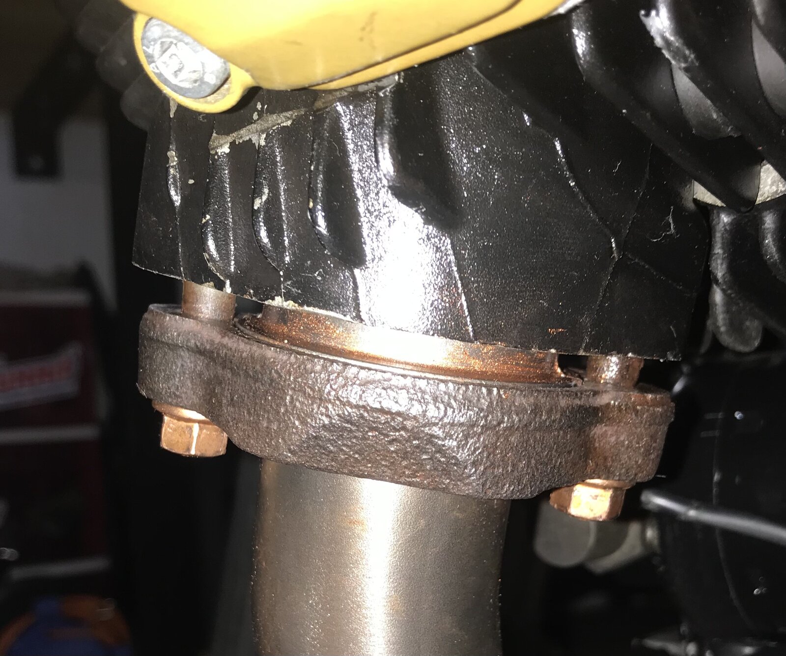

  14. One more step towards starting her up: the exhaust. Very happy with how that turned out. :)
    69A68BAA-566F-476F-960F-B996B6A27425.jpeg F9DCDF5D-89EB-4465-81A6-A2CDB0DFFE0D.jpeg A9A48ED2-BB5F-460B-840B-F04FBD3C4ACB.jpeg 002AF60D-4656-4A6D-B8E2-EB4890D17A32.jpeg 372C76D0-E2F6-4570-9839-944EE23200C4.jpeg 88B335A3-15A0-42A5-90A1-F69CEAAADCD3.jpeg
  15. It has started!!! First try, boom, she fired right up, and idles like a queen.
