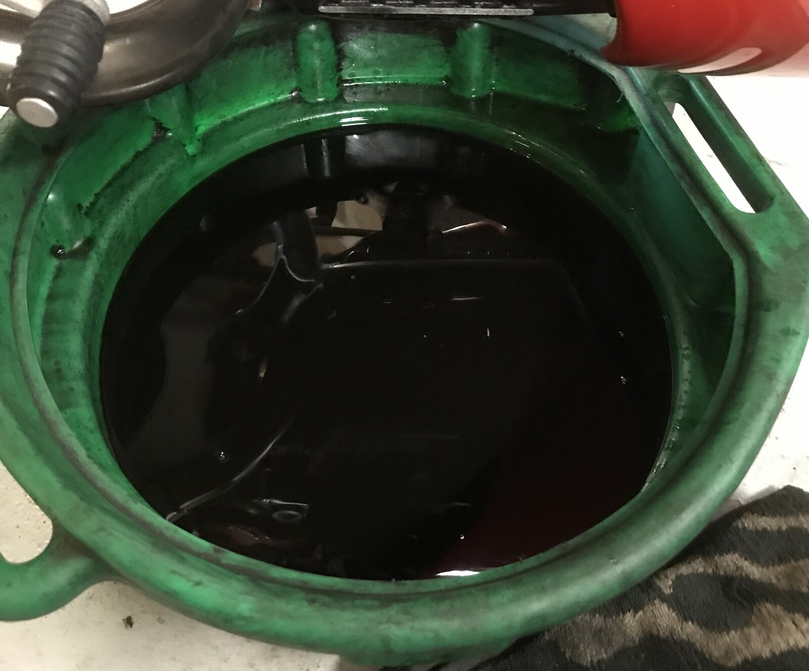

    I restarted this bike with cheap 10W40 supermarket oil, in order to “clean/rinse” the engine first. After only 100km, and a hot engine with very fluid warm oil, I flushed it. It was already black, due to detergents action. All that soot is no longer in the engine. E0903A30-F9A7-49E3-A9D4-603FAA967215.jpeg

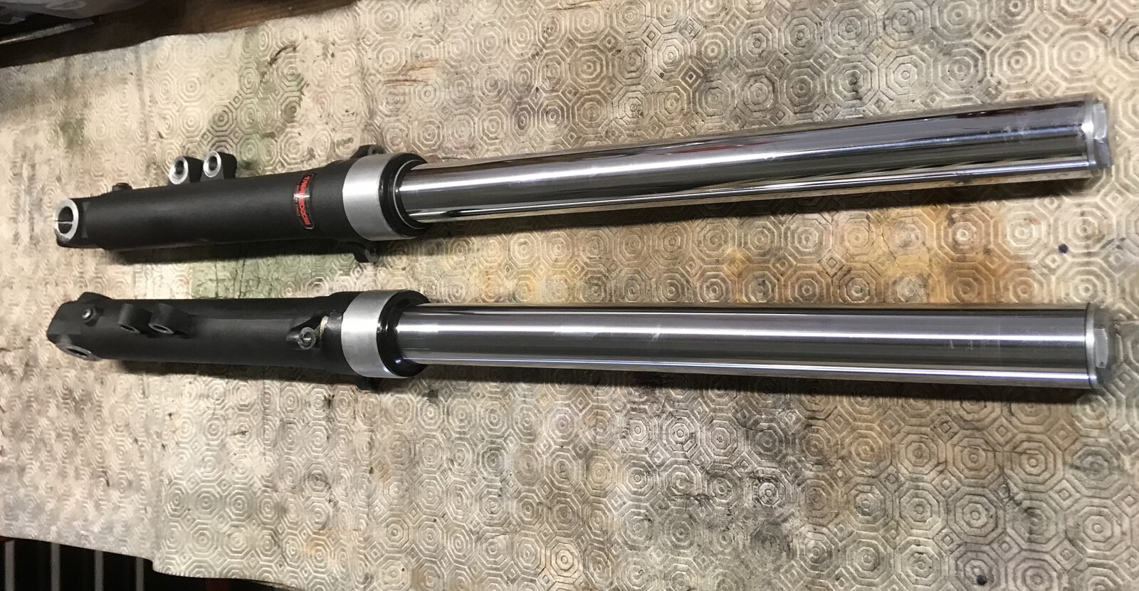

  9. On the way back from last weekend road trip, the original rear shock of the chosen bike (#0054) was waiting in the post box, fully serviced and cleaned. 7F4E2273-CF00-4A22-B514-F8ECF8E23396.jpeg
    That allowed me to swap back shocks between the two bikes, making #0054 look even prettier. 6197794B-F00A-499B-9B39-B37EB4407317.jpeg 7767E91E-847A-4F81-ADFA-6C0D0AF77CE6.jpeg 5D622AD2-017C-4C50-A64C-2ACDD2CDFF75.jpeg

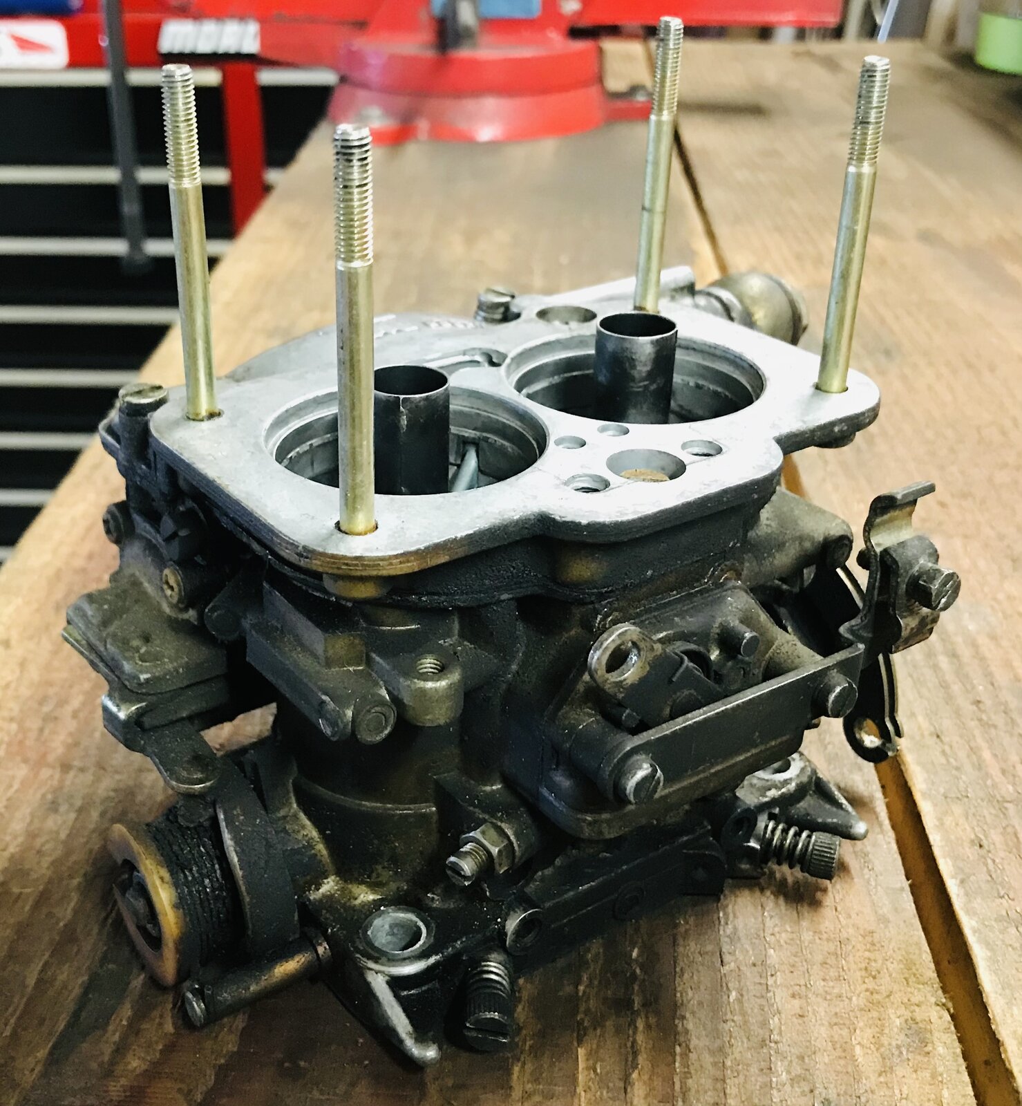

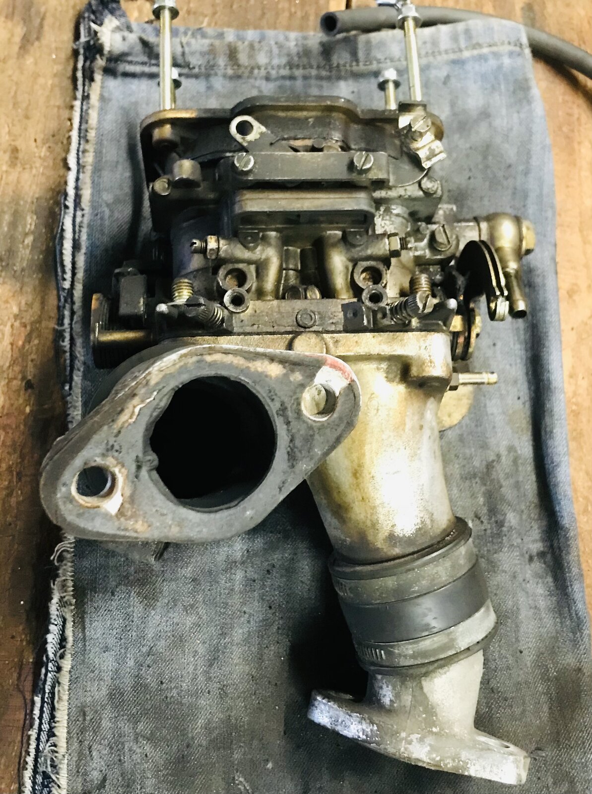

    So I started working on the donor (#1282). Initial idea was to simply prep it for an easy/trouble-free sale. Problem is this bike is just like her twin sister, maybe just a little more greasy for having been ridden more and more recently: everywhere I use a rag, it’s nice and shiny under the filth. So I keep rubbing, moving stuff out of the way, to get a better look, I just can’t stop… to the point where I am now 30 minutes away from doing the valve lashes… Why wouldn’t I do it ? I mean I have a box full of 8mm shims, it’s only time and a hobby. Same for the carby. Why wouldn’t I throw it in a nice ultrasonic bath, while I am at it? Geez, I just can’t stop…

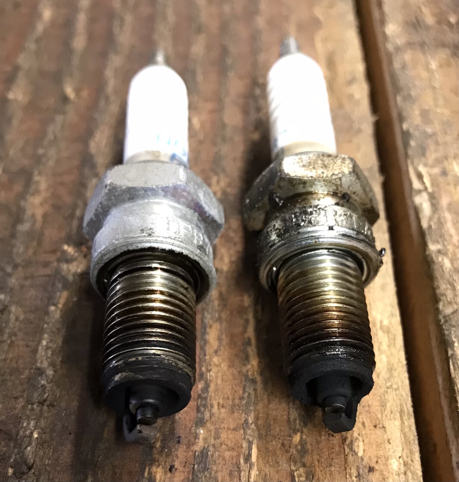

    - Spark plugs (looks like bike was running rich). 8C193ACB-8895-48D5-9FBA-BD3EEB4567FA.jpeg

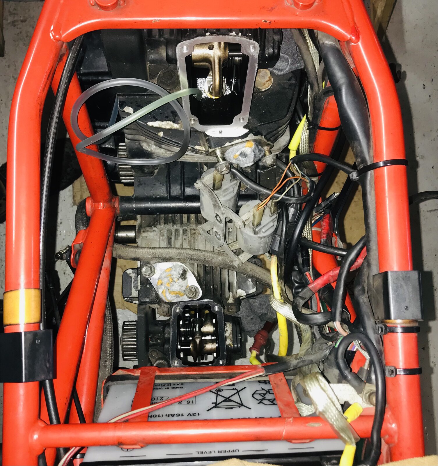

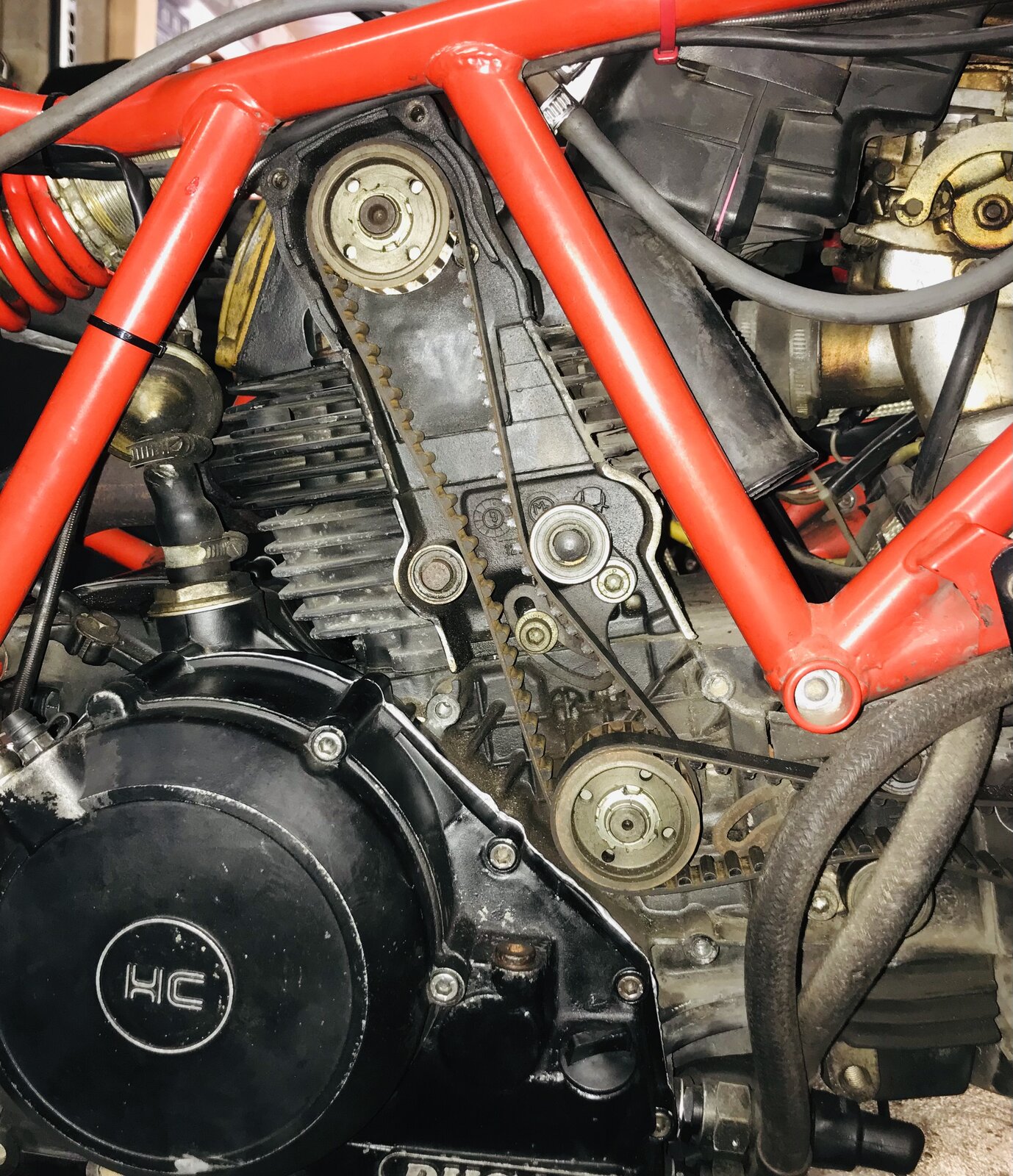

    - Removed the belts. I was very happy (but not really surprised) to find things pretty clean underneath the valve covers. 85D23E79-A091-47F3-A2AC-517BECD19030.jpeg 2D007395-3072-47F9-8CAF-AC47259219FA.jpeg

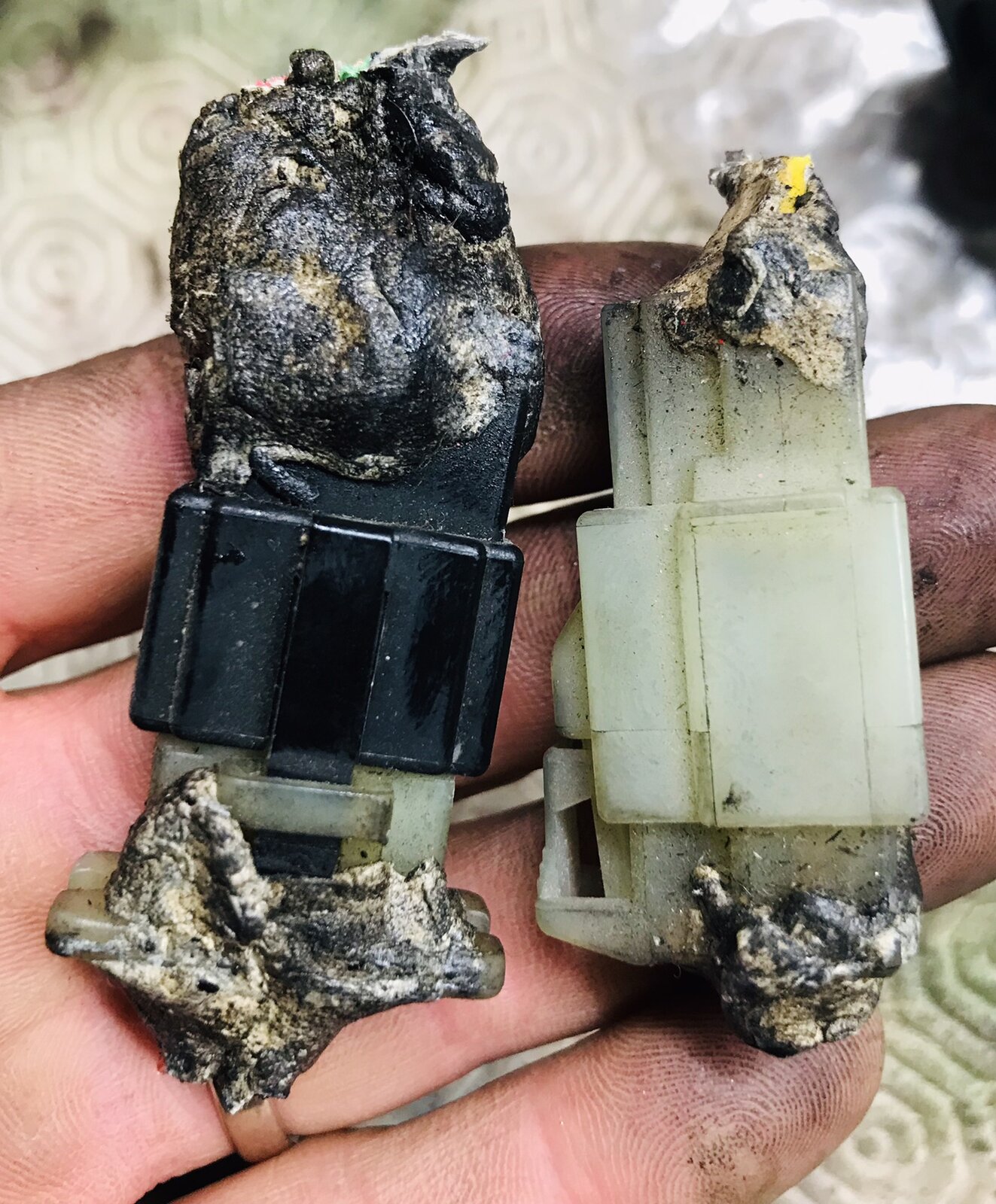

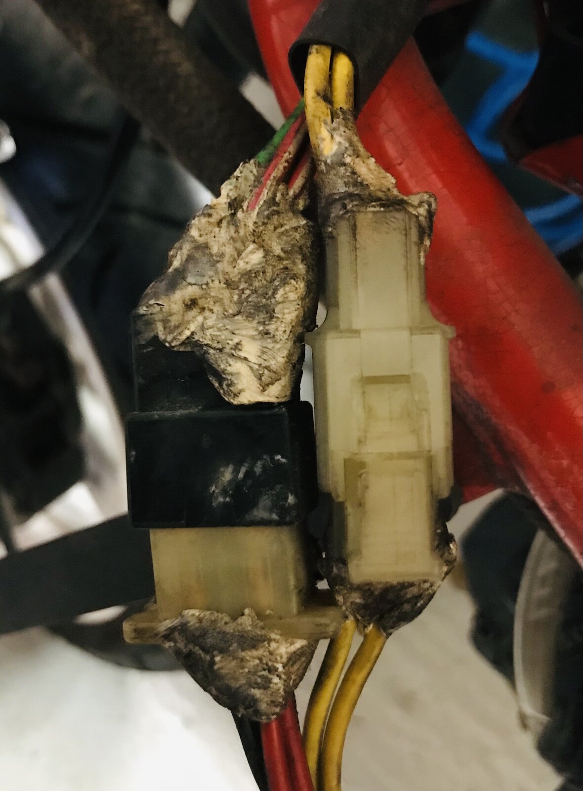

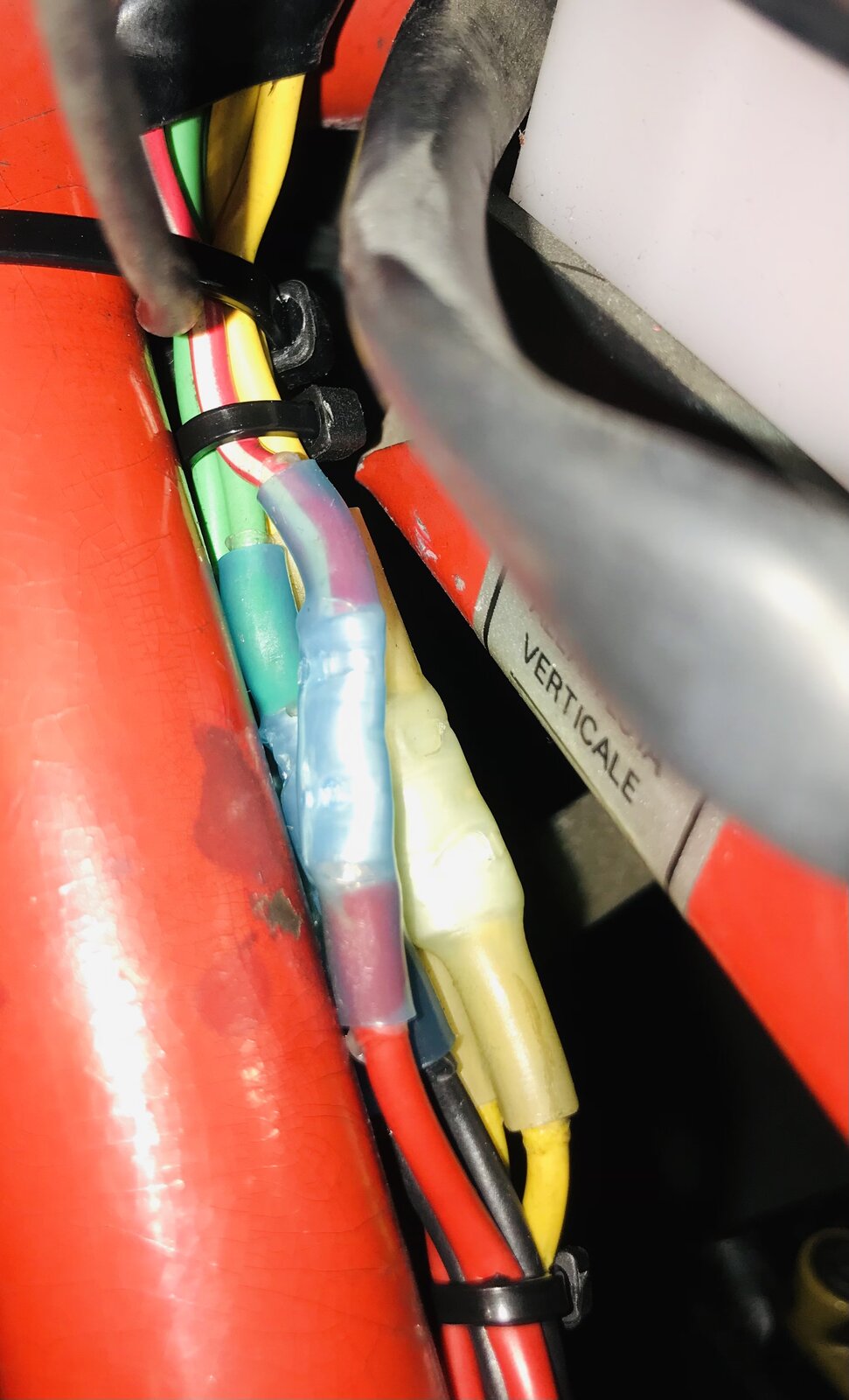

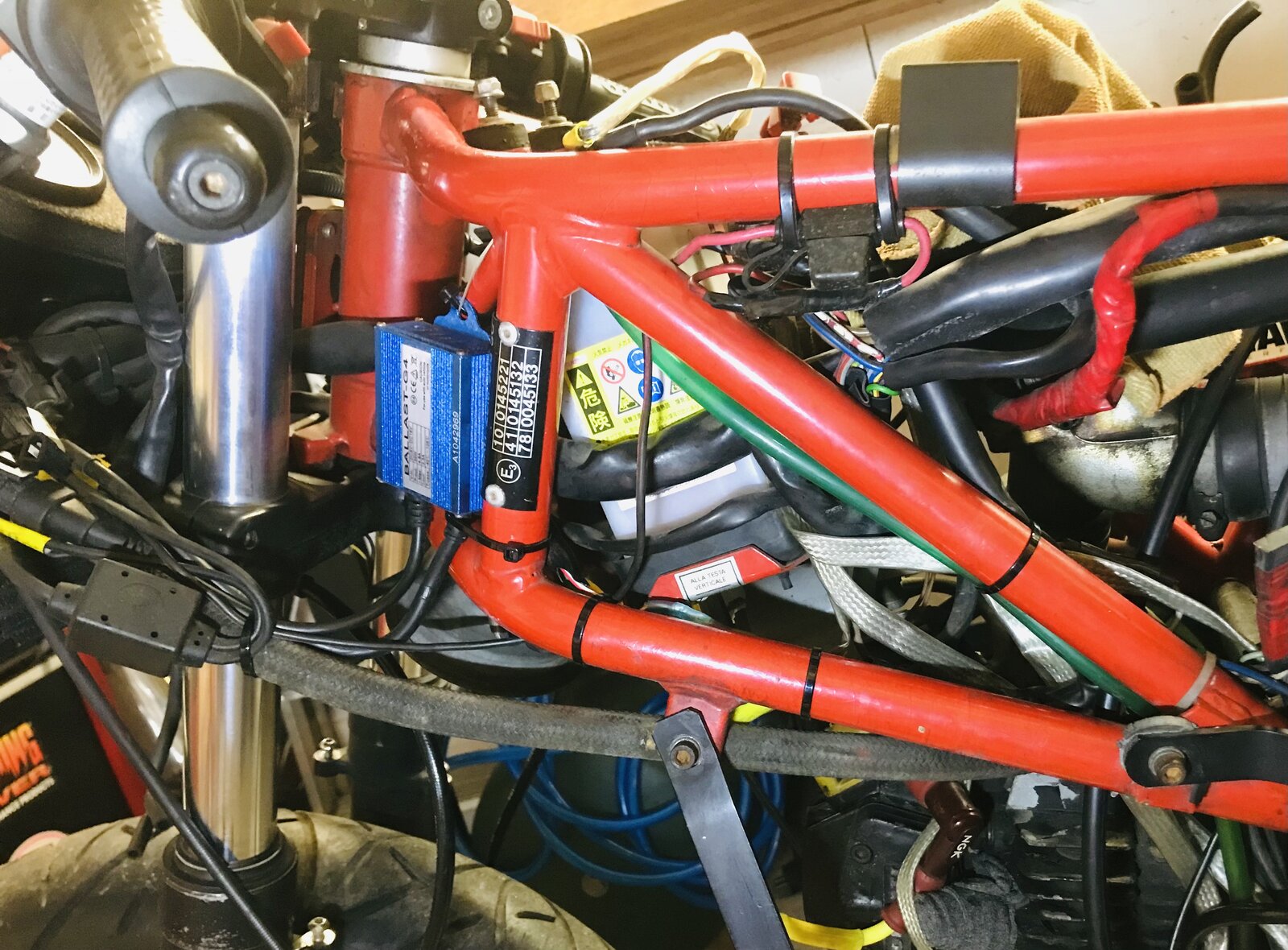

    -Started tidying up the wiring a bit. I had an interesting chat with the r/r connectors. Ended up with dirty sticky fingers but now it’s clean and the charging system won’t be a problem anymore, as it seems to have been… 423A6643-AB19-40A3-A888-A056CF0EECDC.jpeg 8A7D6E8F-B27C-4CBA-BF9B-987C1E7EF0B8.jpeg 40FD6683-93DF-49B8-B92E-543FD66197AF.jpeg 04420425-946B-4971-B5AB-6679EF30D2C1.jpeg

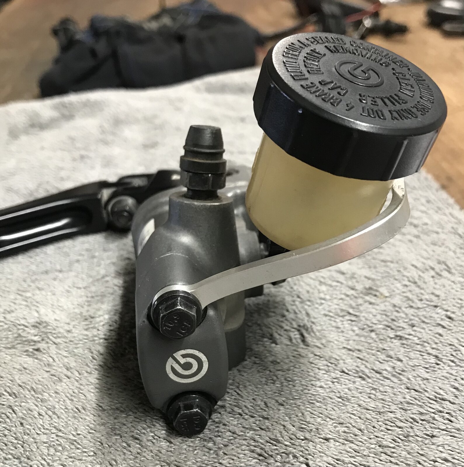

    I also decided to return the clutch master cylinder to OEM, which will in turn allow to also return the choke switch to OEM. All these can still be easily ordered. Simple.
    I removed this PR16 RCS which looks pristine. It is now for sale if someone’s interested, don’t hesitate to PM me about it if that’s something you need. 4FF71911-BA66-4257-8388-FCA7ECEBB2BC.jpeg 25B52726-8B99-46E0-B373-15A6E34CEF75.jpeg 89F3C2F2-AC75-42DB-BD43-D65BD016884F.jpeg

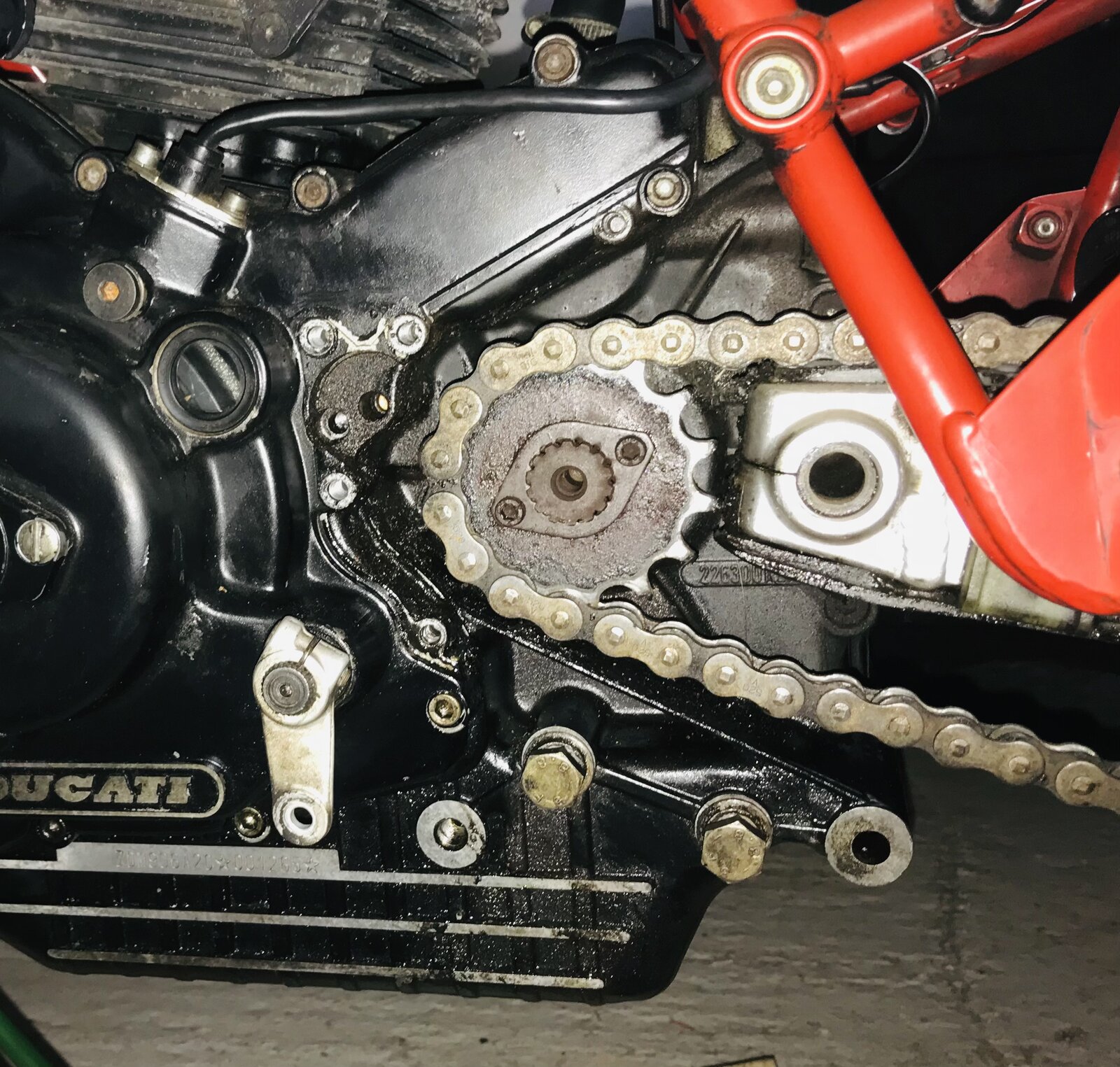

  12. Well, that’s exactly what I did this morning. :upyeah: Getting the rear a check-up and a good clean. I found things oily/greasy but zero rust. Everything came out like it was dipped in melted butter. Messy but nice! 849991F7-B6E2-4BE2-8EA3-0D8B5E2FC476.jpeg AC32A080-3DC1-480F-8DD5-109631636133.jpeg D14BBA59-0EA5-4C31-9C3A-48E81CF5E2A5.jpeg
    And dipping the chain in diesel (that’s a first for me but apparently it’s working like magic…) to get it back to clean and shinny. 282526DB-8C31-43EE-A19C-2AE2291ECAE1.jpeg

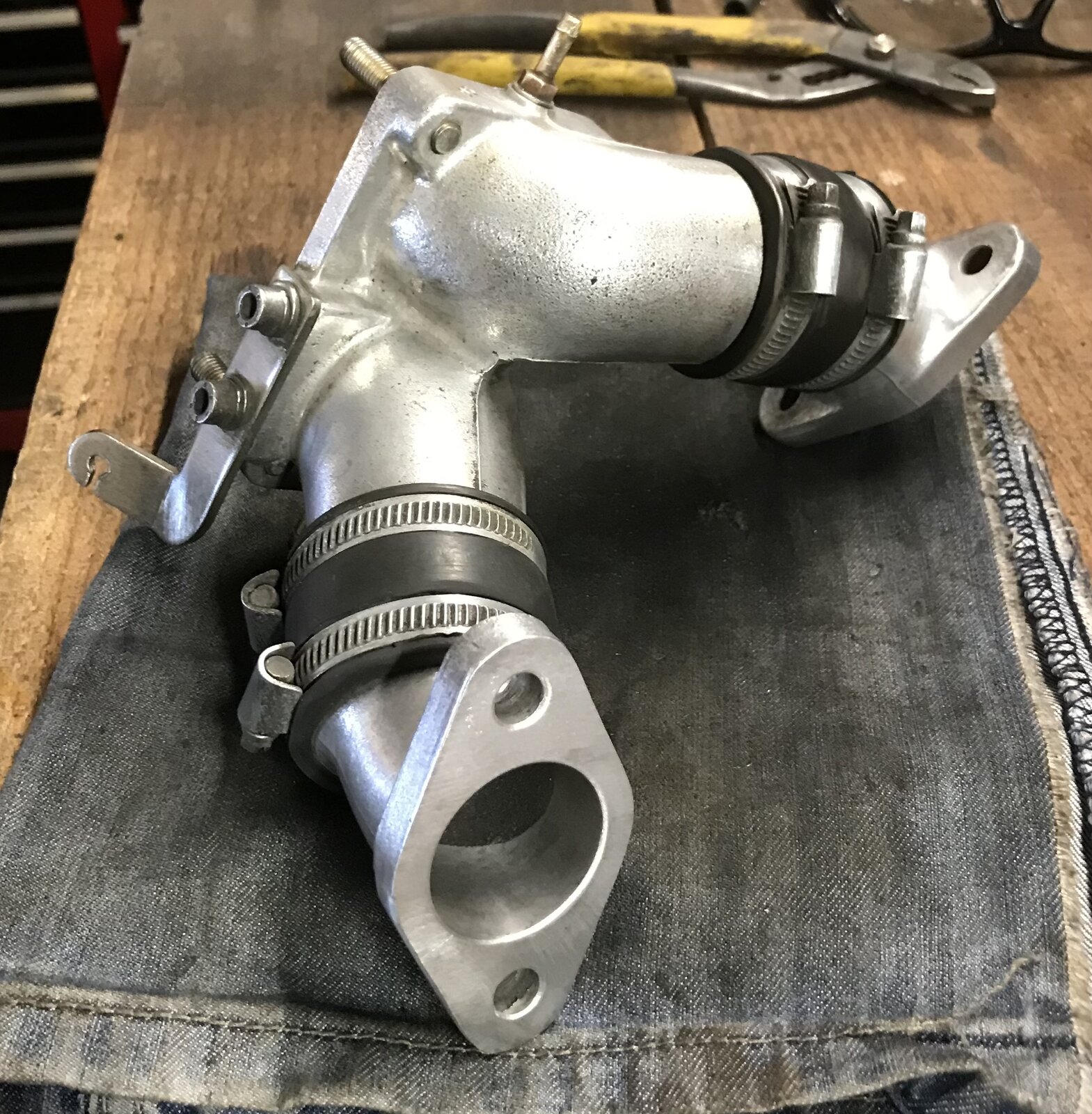

  13. I also removed the heart to access the intake valves. Now that’s dirty! 5512D51B-A04C-4FA8-9461-1E75E26D28B9.jpeg
    Nothing can beat a bit of elbow grease. FA6F3E9F-FC02-43F2-83CD-71746B3AF618.jpeg
    Ultrasonic bath time!

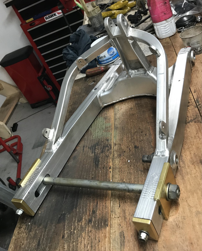

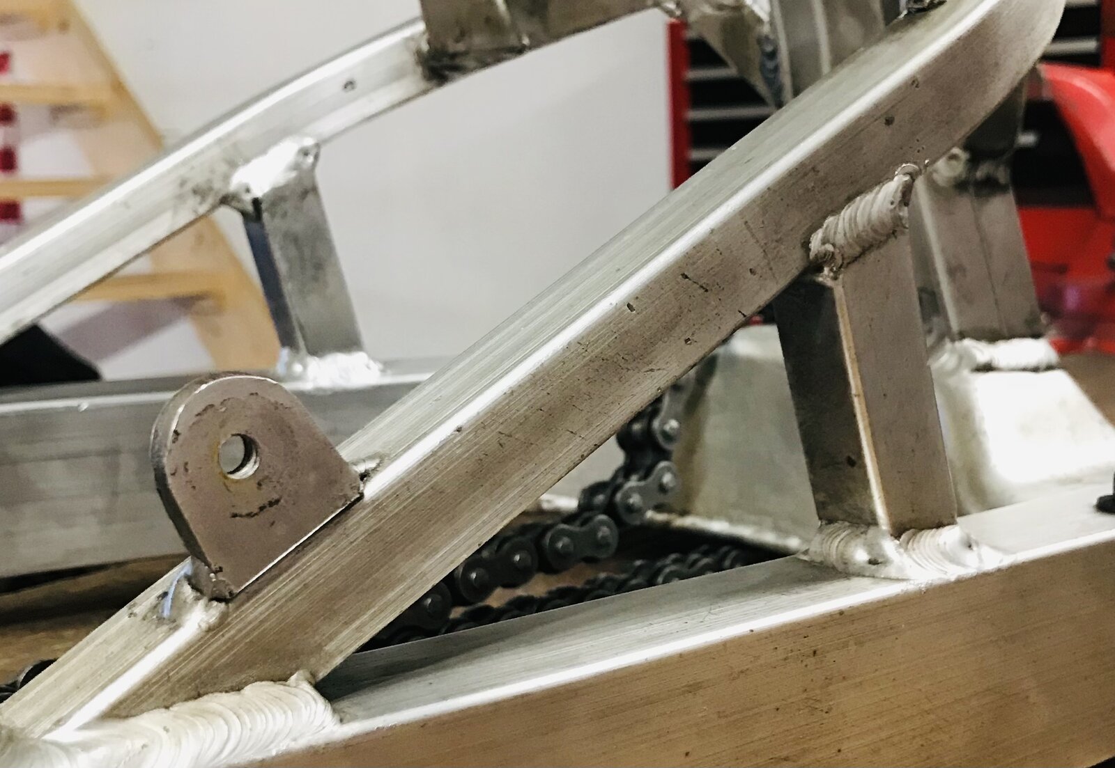

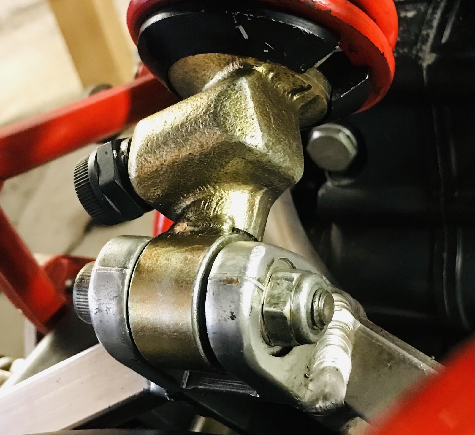

  14. Something happened. Something I completely missed, until tonight when somebody on our French forum wrote : « You’re lucky, your second bike has a reinforced swing arm ».
    « What the hell is he talking about? » was my first reaction. Until I went and checked…
    A3C519F5-37B8-4879-93AF-DF421843C6D9.jpeg 939D1331-429A-4375-B7B6-A90AA985C9D4.jpeg
    Now how in the name of the Lord did I miss that?! :astonished:
    Well, aside from feeling like I have just been diagnosed with early Alzheimer, I guess this is good news. Swing arm swap next! :D

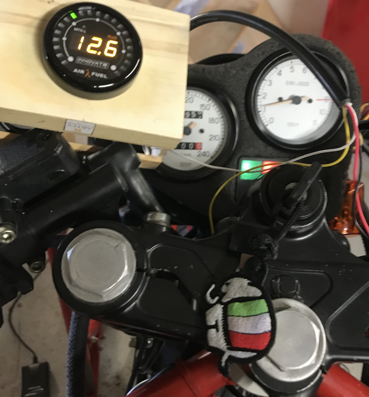

    Can you tell more about the AFR reader please? Make, source? TIA

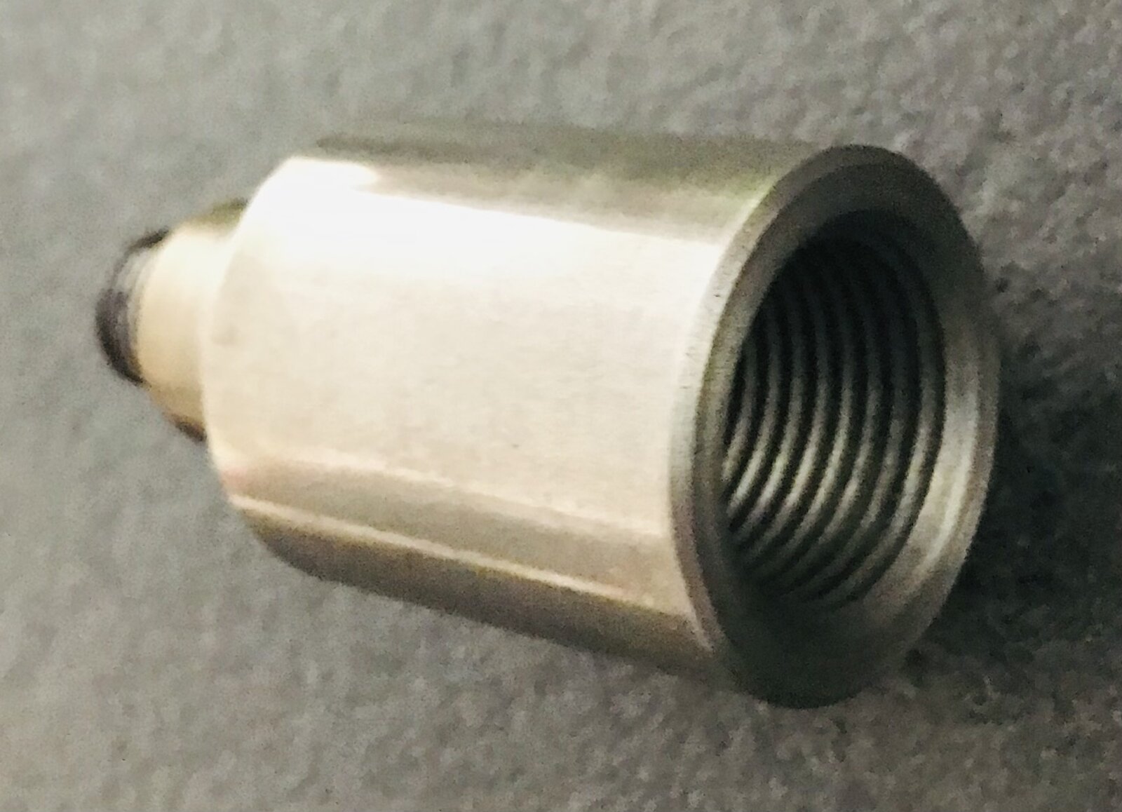

  17. I use a « MTX-L Plus » wide band AFR gauge from Innovate like this one:
    https://www.amazon.co.uk/Innovate-Motorsports-3918-MTX-L-Black/dp/B071RSKR4Z

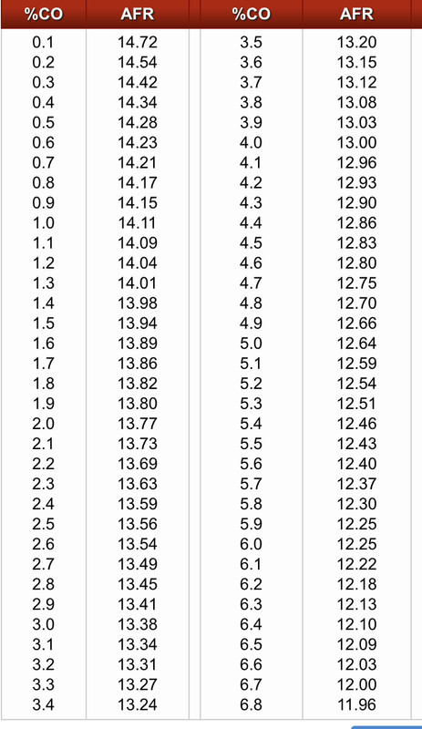

    I use it to tune both my injected and carbed bikes. It’s absolutely brilliant. You set the AFR to get the desired %CO using a table like this one, for exemple:

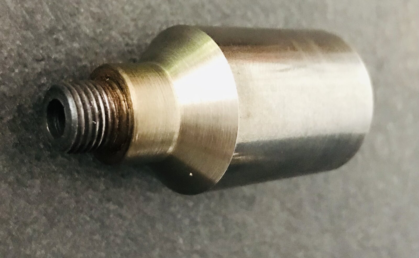

    The main challenge will be to find a M18x1.5 to gas1/8 bung in order to plug the cable (M18x1.5) to the exhaust headers (Gas 1/8). It’s actually impossible to find. I mean we looked everywhere but to no avail. We ended up drawing a plan and getting some made professionally. A series of 5 made locally ended up at 52€ a piece. I can send you the million $$ plan by email if you guys want to group to get bungs done over there in UK. 29FC1CB4-23AF-4164-9457-E4053ECB8FC3.jpeg 23D0A738-0CDD-4C6A-BA90-582F6BE39381.jpeg

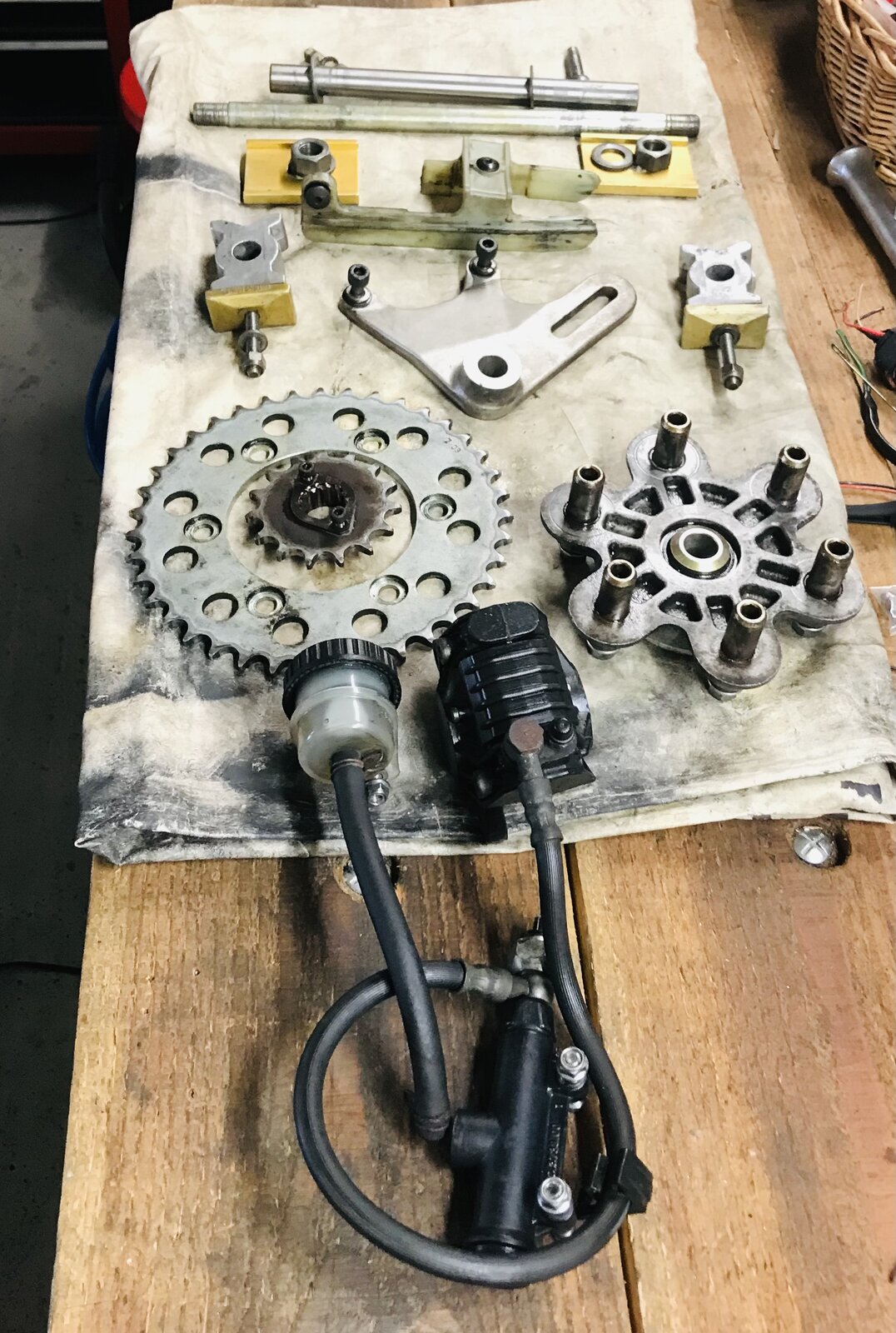

  20. I swapped swing arms this morning. The chosen bike is now equipped with a 36.000km reinforced swing arm and the donor with a 13.000km OEM one. I made this choice as I really intend to ride a bunch around country. 11591821-1E4D-4F7A-8856-8C36CB917773.jpeg 5547DF27-2ABB-47E6-B240-A03C44298BA5.jpeg
    Here’s a good comparison of the two swing arms side by side. 5376DDE9-0F58-415D-A940-21A82E2A8162.jpeg 8CD7299B-1C90-4889-BAA0-0C1F7CB95163.jpeg
