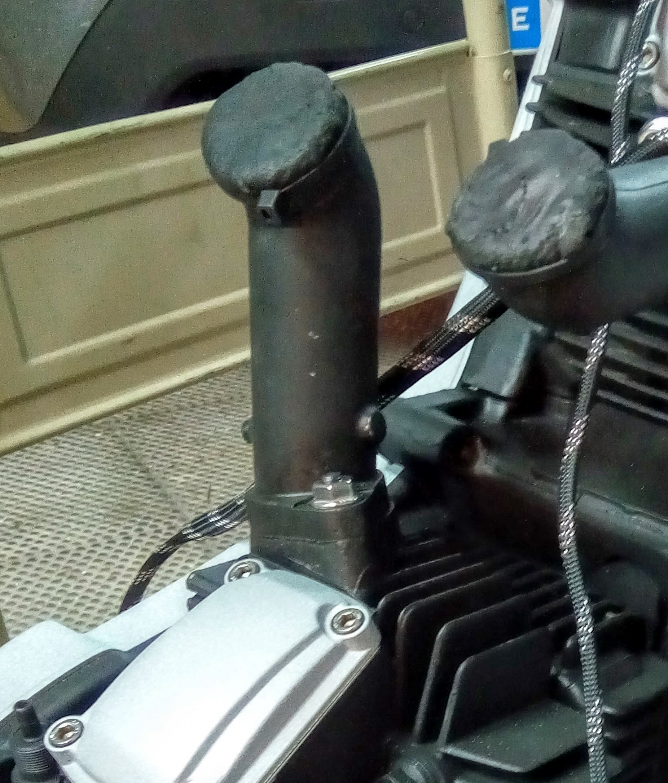

  4. Realised that those screws in the inlet manifolds need to be undone if you want to balance the carbs. So i decided to replace them with A2 stainless allan screw-cap M5 x 8mm bolts. Didb't have any so I cut some 20mm down.

  5. Certainly is! Carb balancing is quite straighforward although the screw is tricky to get to as its right in the middle between carbs, accessed from the front
  6. There are two screws in each of the manifolds on mine, so on each manifold, one faces outwards, the other inwards.
  7. On mine (also a 750) there is only one on each manifold pointing outwards. The inner one is blanked
    I think you can notice it in this picture (quality is not very good)
  8. On my 900 its just one

    I do like your alternator wiring!
  11. perhaps they were used on other models that required different set up?
