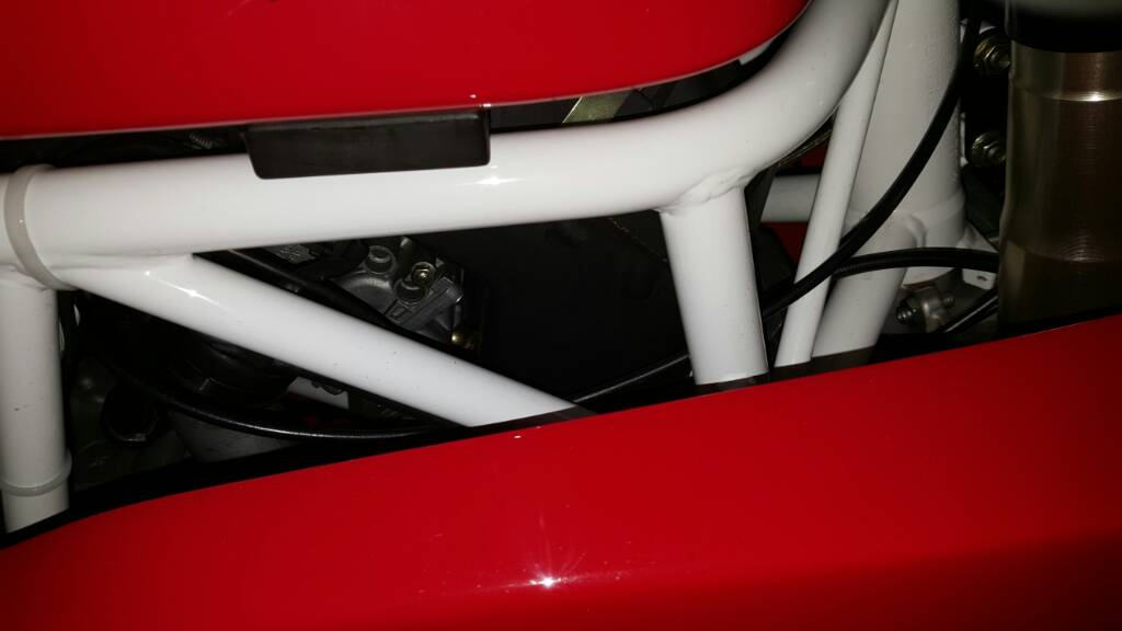

  12. I've had mine off and on a few times and don't remember it being too tricky. It does go in front of the headstock then inside the frame. Here's mine
  13. When ain't you my huckleberry............mine is still at as near as dammit 90 degrees.........

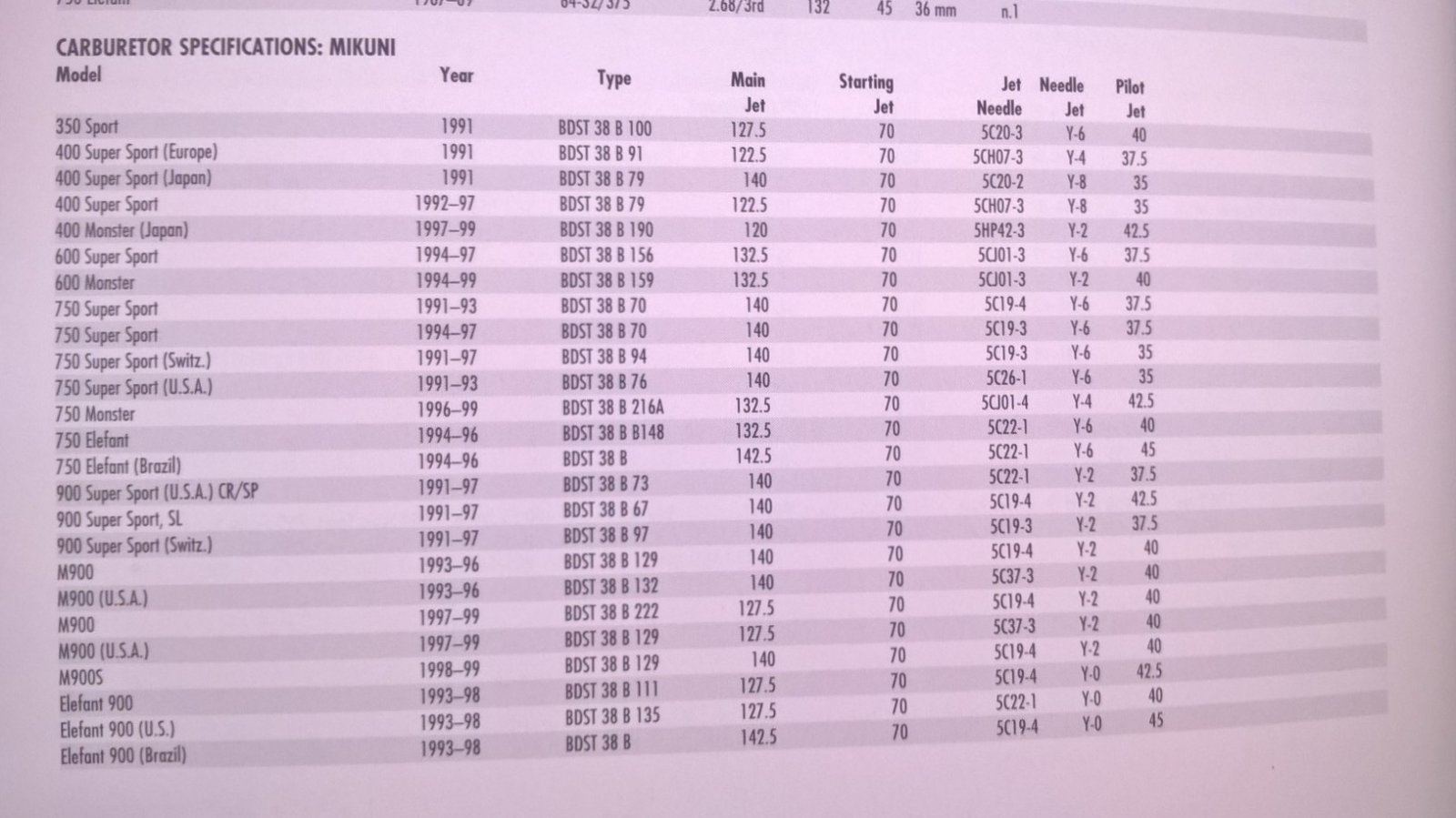

  14. Thanks for all the help on the carbs - I have the following table:
    anyone fill in any blanks? also - which of these is called the 'emulsion tube'? very confused with all the different names for things. I will post on the monster forum as well

  15. 'Needle Jet' has the reference number of the Needle, so I guess that should read Needle.
    Needle Valve Jet is the Emulsion Tube,
    14mm for the float height is purely a starting point and should probably be less...........there is no set dimension by Ducati for the the fuel / float height..........which by the way, are opposing....the float height is measured 'upside down', so the greater the dimension, the lower the fuel height in the float bowl.
