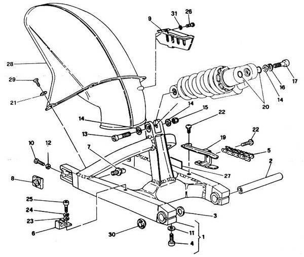

    once upon a time the "O" rings were fitted to the top shock mount, one each side, to protect the bearing from muck ingress, tis an awful faff trying to get them on, then one day upon collecting old ss from Baines service, I noticed they were missing, "yeah we don't bother with those anymore" :Arghh:
    EDIT: for the avoidance of doubt I was referring to item#20 on parts diagram.

  20. The O rings on the Showa shock..... (not the Sachs Boge one).......in the eyes there are two top hat bushes that push into the bearing, one from each side..........the O rings fit one on each bush before they are pushed in.
    There may be some in the Sachs shock, but I never found any evidence of any.......that's despite a main dealer sending me some which are definitely larger than the Showa ones.....but they still didn't appear to fit anywhere sensible.
