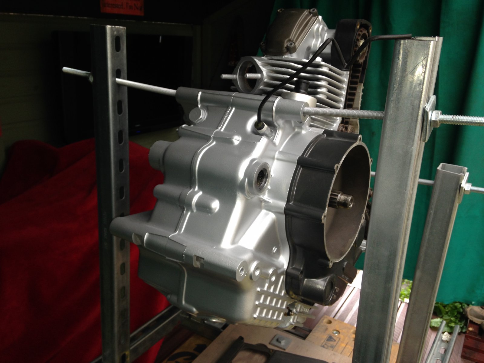

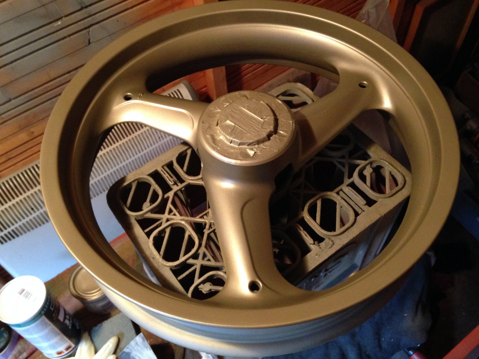

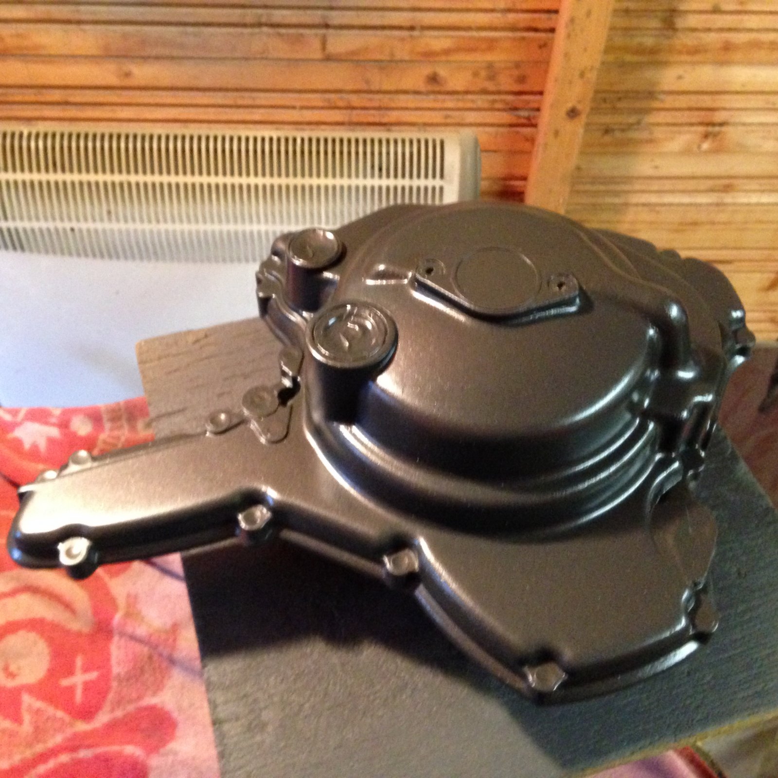

  14. IMG_0348.JPG IMG_0149.JPG IMG_0657.JPG Just completed an IE model 1999.
    Highly recommend Hycote engine spray paint. Bought from a road and rally type shop for cars. It actually hardens off enough when engine cold so takes away worry of damaging the paint putting engine back in frame. Fully hardens when engine runs hot.
    For engine side casings RS Motorcycle spray paint. All details on their web site. Get back to bare metal and use the primer, paint and lacquer they recommend and it is good for high temperatures. Also used this combination for wheels. Finished bike is on the for sale forum.

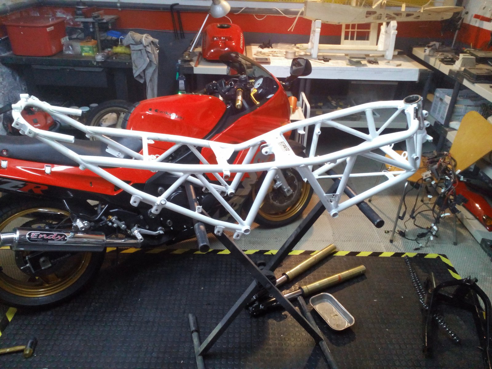

    this is how mine looks now
