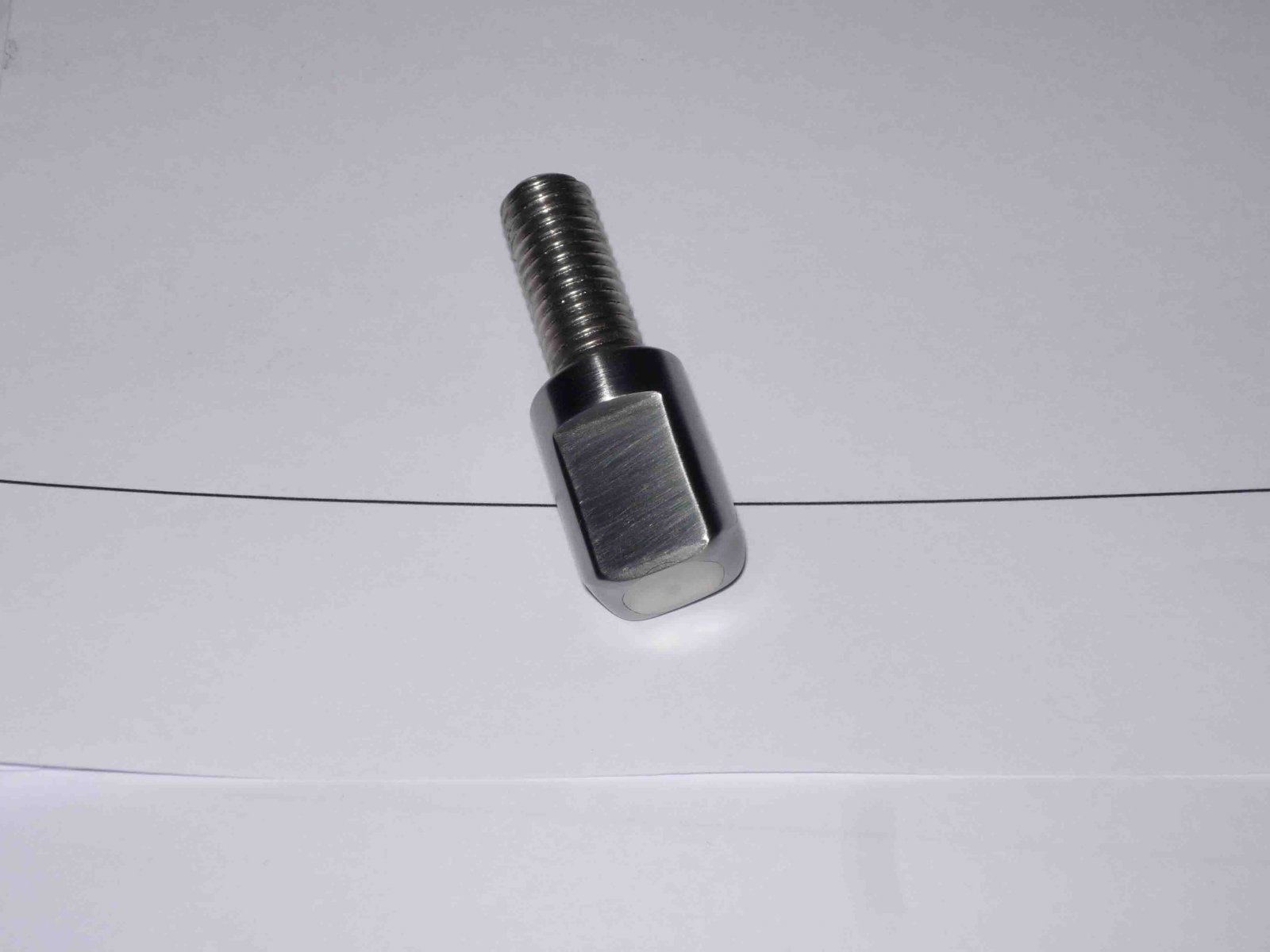

  2. So easy to do this yourself.
    Just stick the threaded end in a drill chuck and spin the bolt-head up on some sandpaper.
    If you want to get a mirror finish, you can go up through the grades of sand and emery paper and finish with metal polish on a cloth - or stop at any point in the process that takes your fancy

  5. Still go rusty after a while though.....:wink:
    I didn't use button heads on the sidestand bracket......used ordinary stainless socket heads and wired them.
  6. Why would decent stainless bolts go rusty ?
  7. Quite, but I couldn't see how your post related to Wolfram's bolt post - unless you were saying turn the bolt head from socket cap to domed head.........so, I thought you had seen the post about the rusty oil line bolts in the other thread.
  8. I was referring to the fact that he had got Stig fasteners to turn the stainless button bolt heads for him, presumably on a lathe, and wished to point out that it's perfectly possible to do it yourself in a drill chuck, using sandpaper.
  9. That's how I do most of my stuff......one ally swingarm brake plate stop below.
