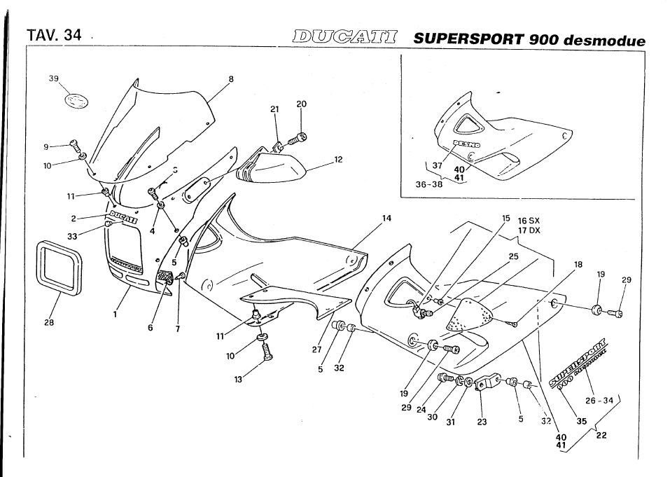

  3. Frankenstein bike - just a mock up for now - anyone got any experience of fitting half fairings permanently? I don't have fixing points at the rear.

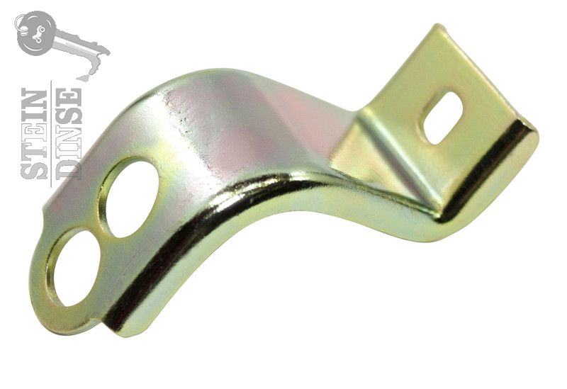

  4. You remove the two sticky out black tube mounts which support the full fairing lowers.......
    You need two sort of S shaped (or Z shaped) brackets which bolt onto the frame from the inside...........Item 23 below.....
    The mounting point is dead vertical above where the sticky out tubes are in your pic.......just under the top bar of the frame.
    One M6 bolt holds each of the brackets on and a wellnut goes in the outer hole of the bracket for fixing the fairing.
    If you have the low mounted oil cooler, there is also a bottom piece that fits between the fairings underneath....Item 27.
  5. PS.....Use a hex head M6 to fix the brackets........it's a pig to get anything else in there to do the bolts up, other than an open end spanner.
    If you can't get any brackets they would be simple enough to make......I can measure mine if you need the dimensions.
  6. i have most of this - but not no23. i also dont have nos5 and 32. any clue of size of these components? will be ringing round to find a supplyer.
  7. No 5 is a wellnut............I'm going to be away for a while today, but I will measure the brackets when I get back.....in fact I may have already got a photo with dims on it somewhere on my PC.
    The bracket IIRC is say, two lugs approx 40mm long offset by approx 25mm.......they are something like 2mm thick pressed steel with folded edges for strength.

    11.60 euro in stock! They also stock new starter motors, choice of two.

  18. Are you buying the half fairing brackets or am I measuring them?
  19. Buying, but thanks for the offer Al
