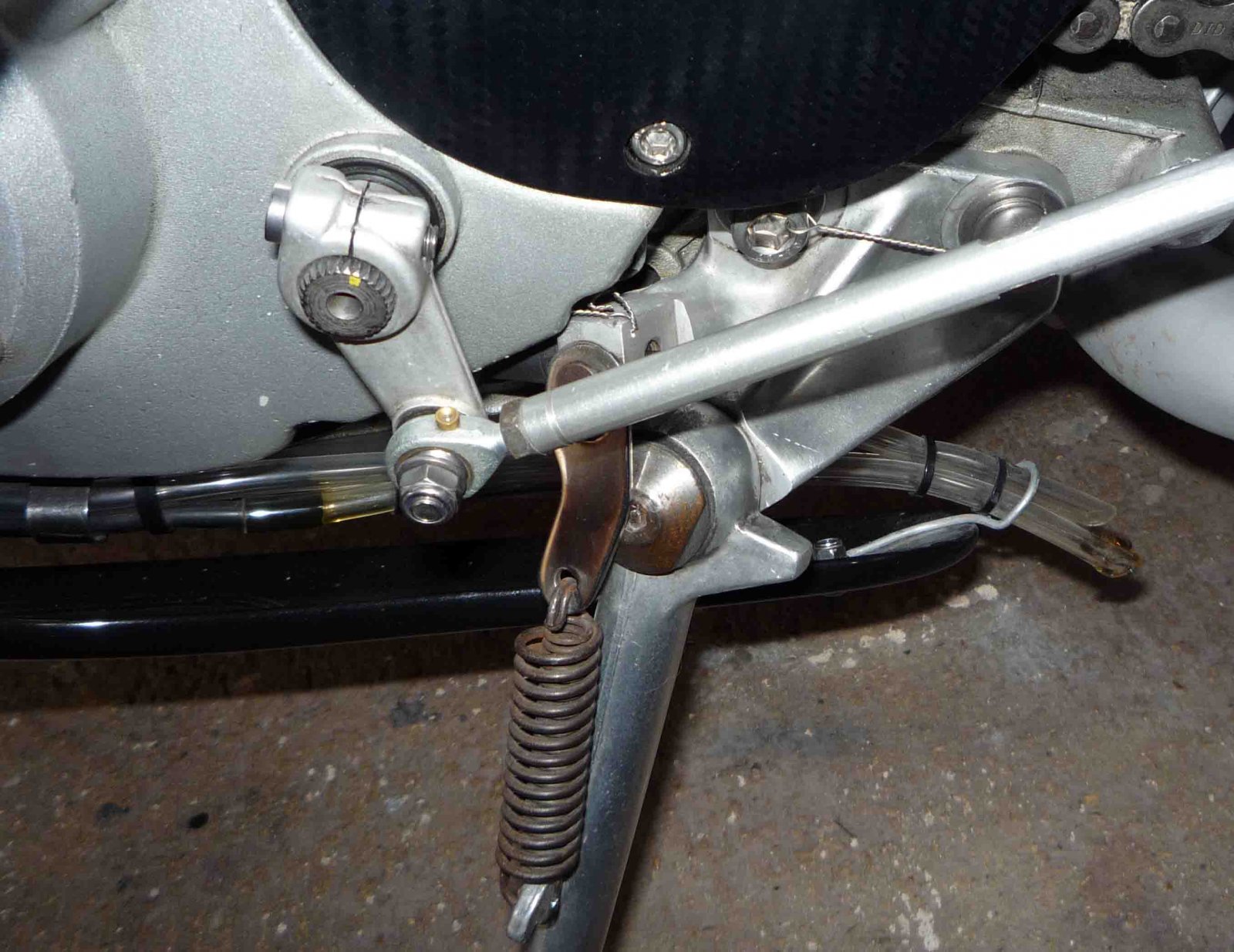

    New problems arising from today include a) the seat chafing on the rear bodywork - apparently this was sorted on later models. I think i need to move the seat catch across a bit. b) the side stand bolts vibrating loose (ok, probable not helped by me riding off with it down at least once!). c) seems to be using a bit of oil - will have to look for any leaks. d) the tank breather does actually drip fuel - i had it cut short for ease of removal, but i dont like the mess on the engine - so going to replacd with a full length one
  17. Seat chafing..........Are there rubber bungs underneath the seat mid-way which sit on the frame......? Later carbed SS models had them.
    Sise stand mounting bracket bolts..........Drill and lockwire them.
    Side stand pivot nut/bolt thingy.........You can actually lockwire it rather than use Loctite.
    Can't help with the oil usage...........Maybe it was just the oil cooler and hoses filling completely?
    Tank breather dripping.......Is it through the ally valve on top of the tank? Have you got it the right way around.......Little arrow points to the front of the bike / away from the tank.............but they can also be faulty or stick and leak........carb cleaner inside a couple of times might help (mind your eyes).
    Plus you can extend the drain pipes from the carbs and the tank overflow/ breather pipes.......I did my carb and battery ones with a wire loop fixed to the fairing.
