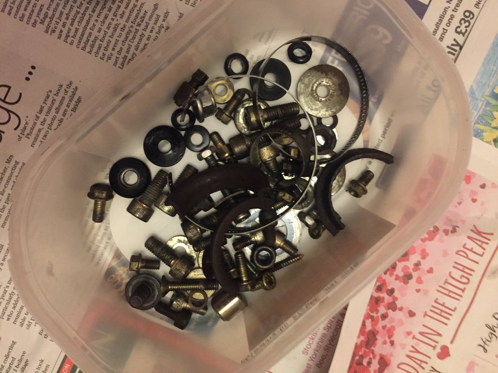

  17. Wolfram - this is an extremely useful list to me, particularly as I have a tub of fasteners and no clue where they came from or even if they came from the bike (most do, but there's some oddities in there for sure!). It must have taken you ages. I've copied it off and will use it to sort out what I do and don't have.
    One question you might be able to answer immediately though: is the top shock mount bolt threaded along its length? There is a bolt in the collection which is the right length and diameter pitch to fit that role, but it's threaded, whereas I would it expect to have a plan shank and threaded end only where it meets the captive nut in the frame. I think it probably is, from some of the comments I've read, but if you could confirm that would be helpful. Can't immediately post a photo as I'm not at home right now. The photo is the tub of fasteners I've received and cleaned up so far. There are a few more to come...
  18. Good question, I am not 100% but think they are both shanked
  19. IRCC the shock bolts are partially shanked - on my OEM ones and the replacements I used, there was some threaded (other than what was required to tighten the nut up) but I think there was enough to have mostly shank through the eyes of the shock.
  20. Hmm. Well, that's what I would have expected, so perhaps the bolt I have is not the top shock mount bolt after all. In which case I have no clue what it's for, or where the correct bolt has gone. Never mind! I would have been surprised if it had been fully threaded, but I'm sure I read a comment somewhere (possibly in wolfram's thread, but maybe not) about the bolt being that way and being changed for a shanked bolt as the writer wasn't happy about it. As I wouldn't be either!
