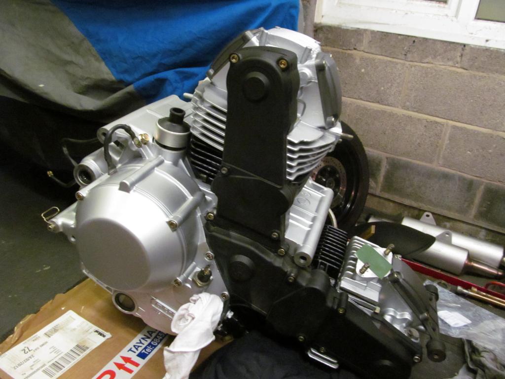

  20. OK - I have been off this thread far too long. First day of my holiday - so I finished the primary casing and alternator cover off in gloss black (Vauxhall Diamond Black - Halfords). The valve covers and camshaft holding caps are now silver (Halfords again). These were first acid etch primed.
    #120 wolfram, Dec 23, 2015
