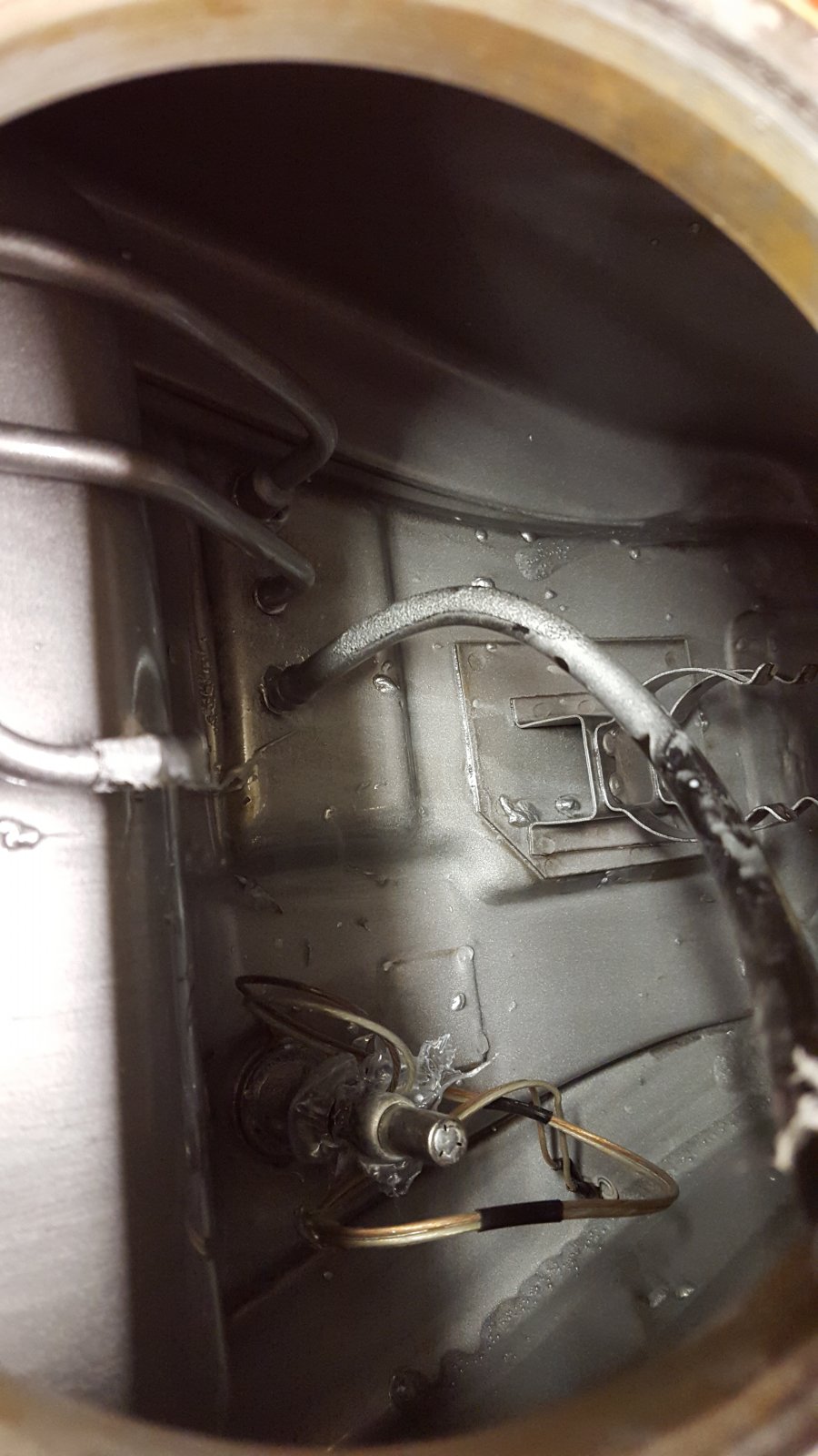

  2. I popped in to Clearflow to find out how work on my leaking black petrol tank was progressing. The rust was pretty bad apparently. First they had to pull out the badly applied fiberglass patched on the inside. They have only done half of the silver soldering so far. I will get it back next week.
    I would recommend them if anyone else needs radiator, petrol tank welding. They also dipped my heads to remove paint. They do powder coating, but I used another firm in Darlington before I knew that.

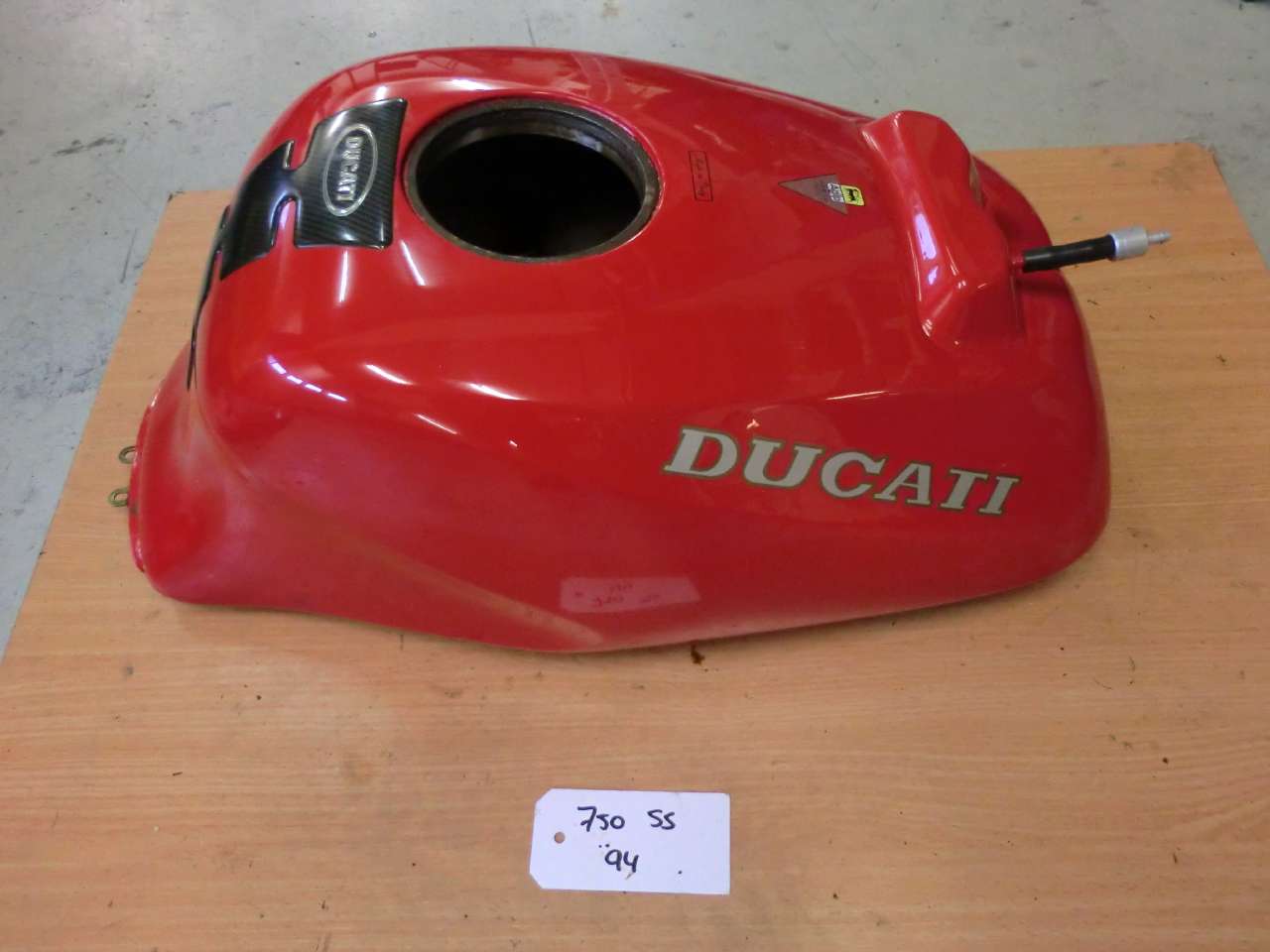

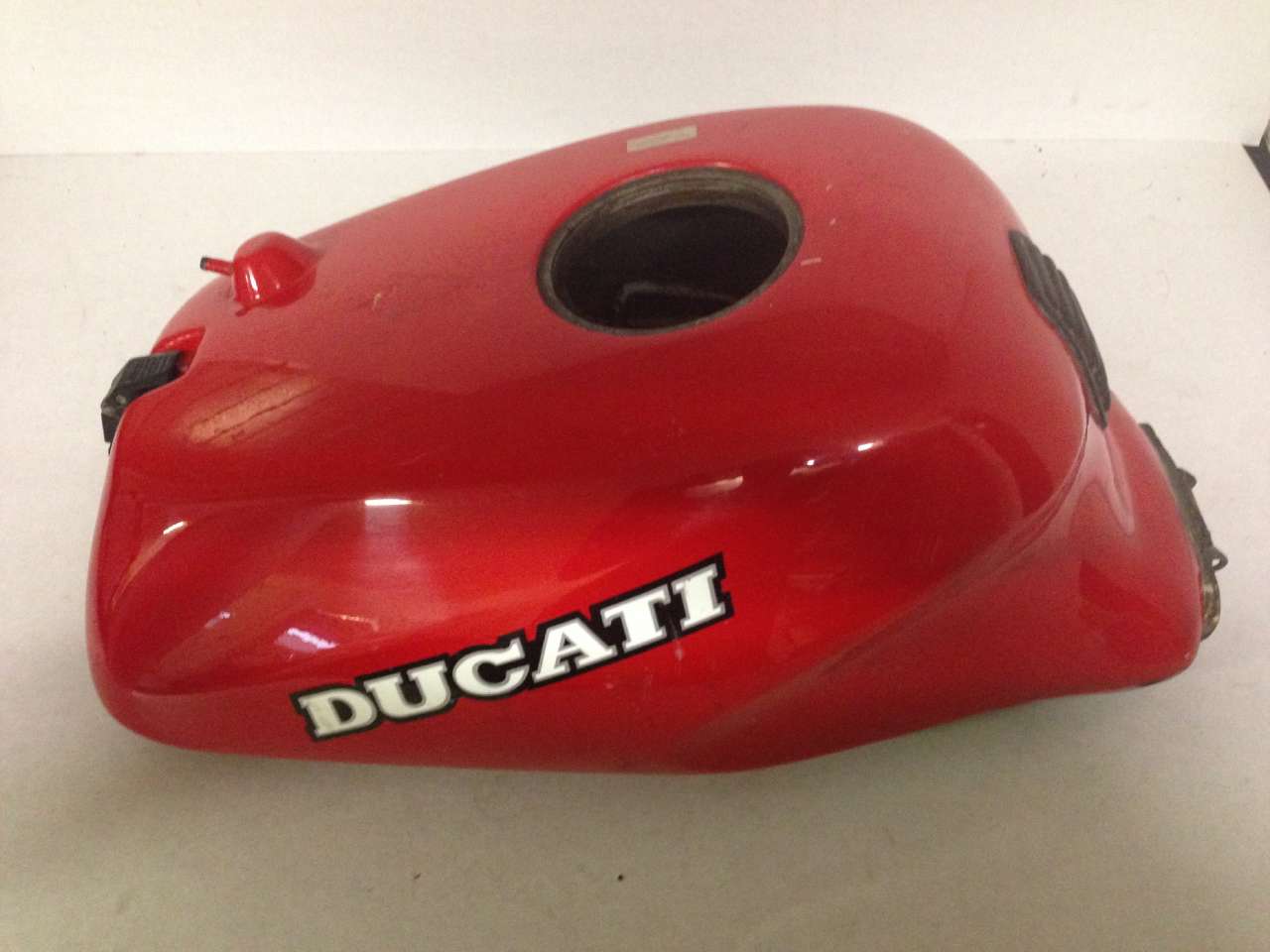

  3. I wonder how much a used tank would cost? i have one in red, might not even need paint.
  4. Is it small breather? I guess they are much rarer. As the rust is a continual problem, a good one will continue to appreciate in value.
    I wonder if there is a way to remove water from the tank? How does it get in?
  5. Not sure on either of those questions. How to identify a small breather tank?
  6. The breather pipe is attached to a circular bulge to the right of the midline. The later tanks have a rectangular bulge across the whole of the tank.
  7. and the rare one is the circular one?
  8. They changed the tank design for the '93 models, they also moved from white wheels and frames to gold at the same time and used the new gold graphics.
    The tanks rust from the inside out, water content in your fuel sinks to the bottom of your tank and sits in the two channels (lowest point) and just rots the metal. The earlier model tanks are rarer because most of them have rotted through by now. A few years back you could pick up an old SS tank up for about 50 quid, they go for considerably more now...

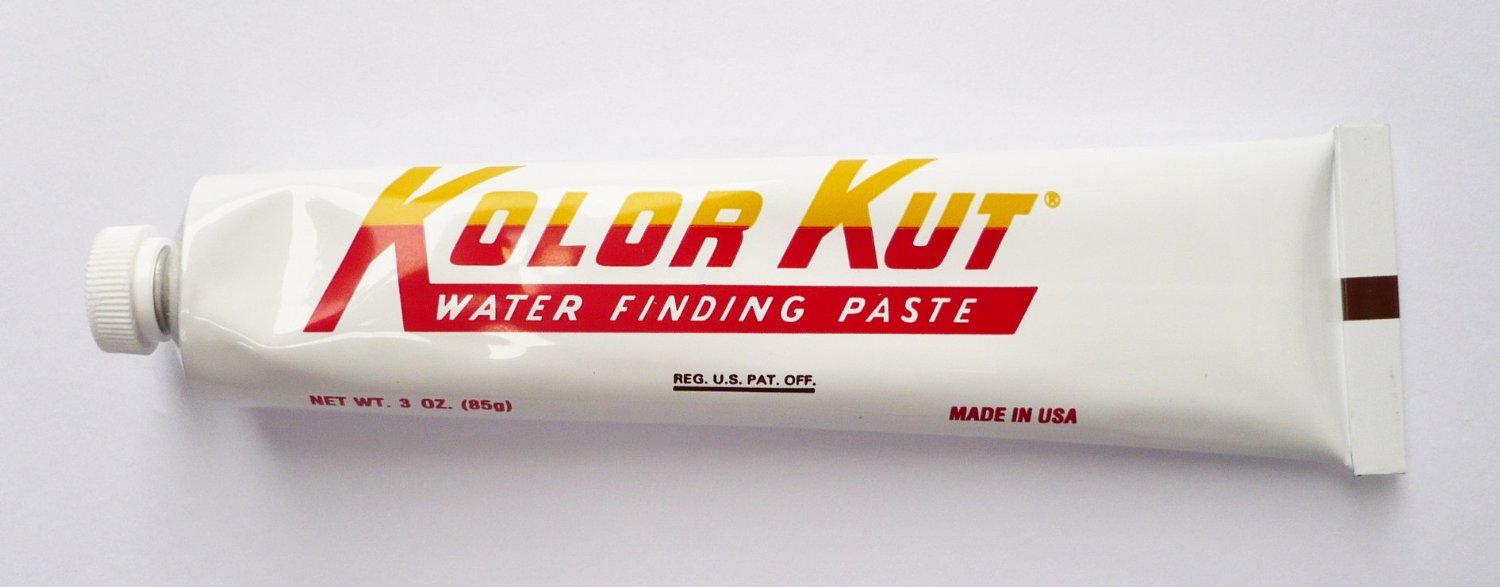

  17. If you want to know if there is water in your petrol tank, pop into your plumbing supplies depot and buy a tube of this for about £10.
    Smear some on a long enough probe and shove it to the bottom of the tank..........the yellow paste will turn red instantly if there is water in there.
    Note that an opened tube will go hard quite quickly if not sealed well.
