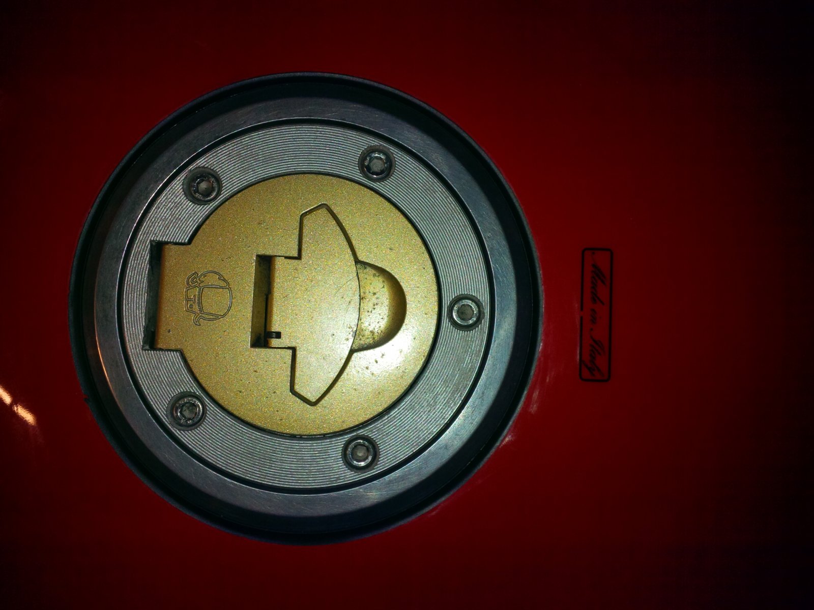

  2. Tank decals...
    Just ordered a set from the image works - they said i would need an 'Agip formula moto' and a 'made in italy' for the top of the tank. This s interesting, as my red 1991 tank has the 'Agip' sticker only and the black 1992 tank has only the 'Made in italy'.
    Who has these stickers? (ignore the tank protector - i'm not a fan!)
    a) both
    b) made in italy only
    c) Agip formula moto only
    d) none
    Black tank being sprayed next week

  3. 1993 larger breather, Agip only
  4. 1991. Neither and I think the paintwork is original
  5. 1997 Wide breather (which I assume is 'large') and the Agip Formula Moto arrowy thing plus a small rectangular gold outline, gold script 'Made In Italy'.
    I believe the tank is newer than the bike, could be wrong though.
  6. 1996 large breather - "Made in Italy" only.
  7. this vid has both and its a 1992
    this is a 1993 with both
  8. Go on................be a devil and stick both on...........
  9. do you think i dare?
  10. Yeah, who FFS would know the difference......??
    We don't appear to.....
  11. 1995 900. Made in Italy only. I've had the holes in the bottom plated and full respray but the decals are as per original.
  12. Mines a 95 with the "Made in Italy" plus the AGIP, but the AGIP is a later addition as its not lacquered in.
  13. As with a lot of stuff, Ducati were not consistent but I've never seen an original that has the AGIP sticker under the lacquer and never seen a made in italy sticker that's not under the lacquer. I don't think the AGIP stickers were universal, maybe just for some markets, some also had them on the fairings from new..
    Or something! :)
