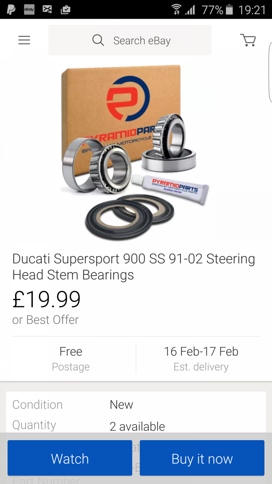

  13. OK - head bearings. I have got the old set off. They did not have any seals - just straight flush to the bottom triple tree. The new bearings do have a seal. Do i use it? it seems to me that the rubber would either foul the bearing, or compress and rebound, making it difficult to get the tightness right.
    Advice?
  14. Dont think there is a seal, I certainly havent got one and I have new steering bearings with no seal.
  15. Seals?
    Balls..........
    ....or taper rollers?................taper rollers don't have seals............or at least I have never seen any.
  16. Is it a kit like this?
    If so, cant see how the seals would help anyway as its all sealed when its all together, no dust or grit should get in there.
  17. yes just like that - the 'seals' are the two washers with rubber outercovering in the foreground
  18. As I thought.
    Theres no seals like this on my bike
  19. Great support on the forum! Thanks for all the replies! They are going on in the morning.
  20. Those seals will do SFA to keep crap out of the steering head bearings...........Trust me I'm a doctor.
