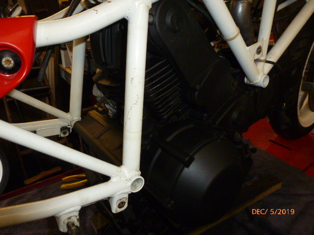

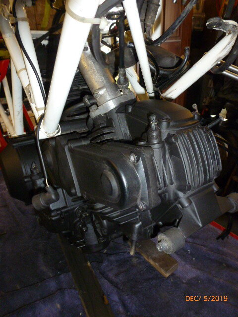

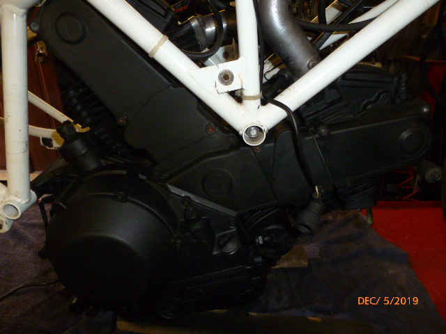

  2. After a little struggle on my own managed to get the engine back in, sometimes that extra pair of hands means all the difference. The wife is out doing her voluntary admin work, she is not well herself but has a care home job a couple days a week and this voluntary work on a Thursday never around when you want them.

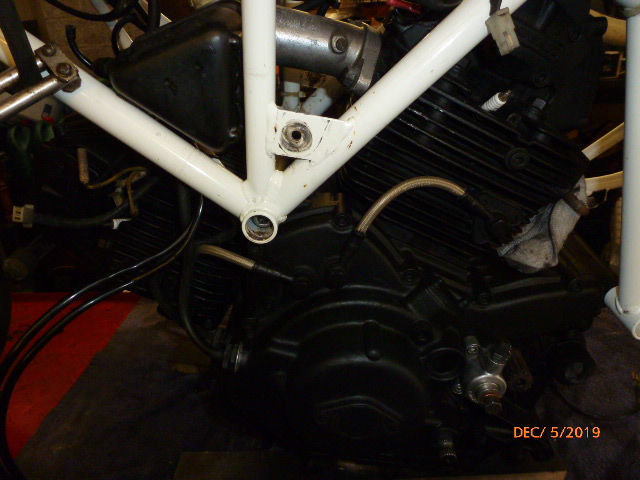

  13. Headers are back on they are in a sound condition so haven't painted them or tried to polish them. Rear wheel back in with a new thrust bearing fitted in the rear brake hanger. Awaiting a clutch master repair kit it was blocked up with contaminated fluid. Oil and new filter changed 10-40 Castrol synthetic, cleaned the oil screen as well. New air filter to fit as well, then cable tie up the wiring whilst re fitting the Exy cable set.

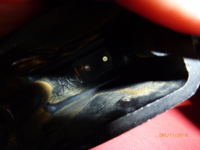

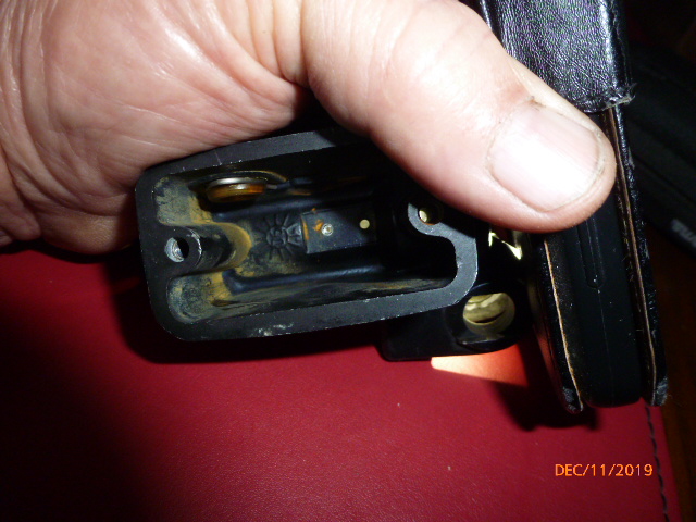

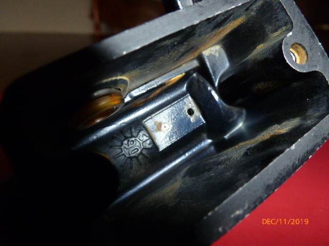

  14. The Brembo clutch master cylinder kit arrived, cleaned and assembled, attempted to bleed the system every way possible not even a dribble from the M/cyl . Removed for further inspection bearing in mind the reservoir was bunged up with rust and contaminated fluid. Cleaned the supply hole at the base of the reservoir and noted another hole which appeared as a blank, further probing revealed a pin hole which i cleared with a darning needle, hoping this was the reason for non function . Too cold will enter the cave tomorrow and re-assemble. Anyone else confronted this problem ? Here's a few shots of the reservoir the shiny hole was the offending hole.
  15. I can't remember if you have one or two galleries Tony but if you have cleared it/them, and you are happy that the bore is not worn or corroded badly then it should be straight forward. It's a genuine kit i'm sure? The only problem that regularly occurs is a "dry" cylinder:- sometimes it's hard to get all the chambers immersed in fluid which is enough to stop the whole hydraulic action. The only way is to persevere with entering fluid into the bore through the outlet and bleed junctions as well as the feed until moving the piston starts to eject fluid. If really stubborn then best done "on the bench" as it can get messy. When you are happy that the bore is partly immersed then you can connect everything up and a lot of air can be expelled just from keep moving the lever through it's full stroke, not too quickly though before starting to bleed conventionally. There are many tricks here also which I can p.m. you with but hopefully others will add info.

  19. Back to the drawing board the new kit fitted, pissing fluid through the push rod. The bore looked in good condition. I may have nicked the main seal, at nearly £30 a pop i am loathed to try another. I am tempted to try the chinese copies Brake and clutch less than £30, any thoughts ? It would mean choke operation would have to be changed as it fitted to the reservoir. Bummer all for 13mm rubber seal.
  20. Have you got a KTM dealer nearby? Many Brembo brake and clutch parts are on KTM......much lower cost.
