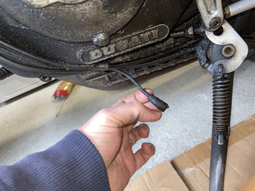

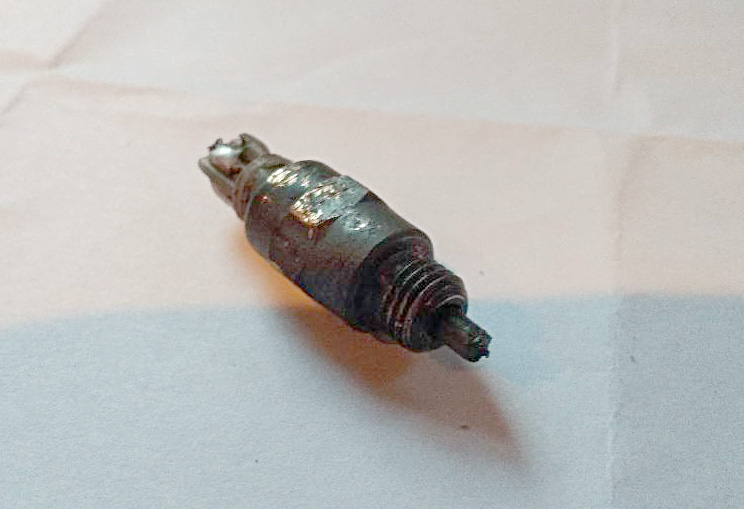

  15. Hi, I have a 1994 900SS so very similar or maybe identical to yours. The wire on the attached pic looks like the side stand switch, but as far as I remember it doesn't plug in as you may have thought, it comes as a swtich (threaded to screw into the side stand assenbly) and a length of wire attached by the manufacturer. On mine it only lights up on the dash, doesn't stop the engine running whether the side stand is up or down (a bit dangerous and that's why some people do a mod to enable the stand to kill the engine). Let me know if you want me to dig out the part number for the correct side stand switch or if there are any photos of my bike which may help you at some point. Cheers Pete
  16. This was my old knackered side stand switch (after the attached wiring 'broke off' of course!). Pete

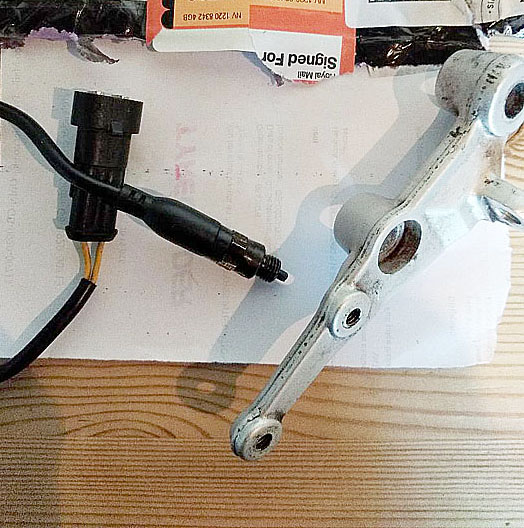

  17. It doubles up as the rear brake light switch. The same one was used on the Ducati 748 (see attached pic for one I picked up used on ebay). I removed the switch from the 748 metal mounting bracket which is obviously different, (maybe someone on here may want the 748 bracket?). Pete

  20. Thanks everyone for your responses regarding the side stand switch. I did briefly take a look at it after a previous response but there appeared to be no connector just the end of a wire inside a rubber housing. If the switch has gone missing that would make sense.
