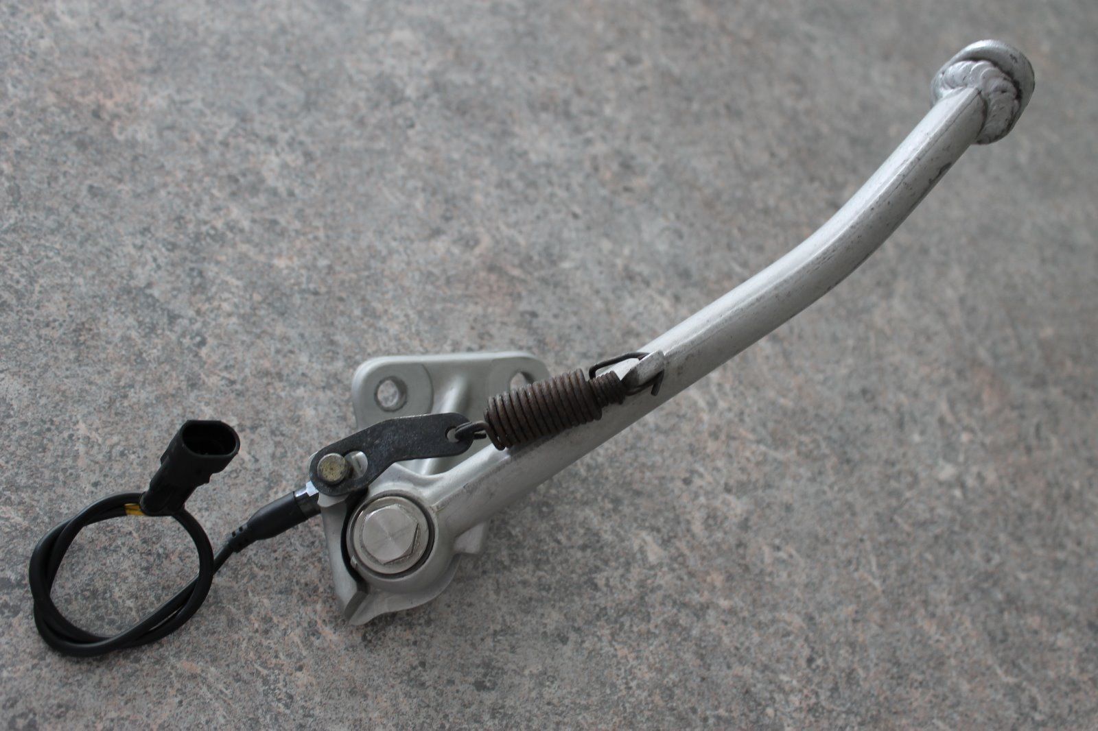

  1. looks like there is a mod on the side stand to stop the stand automatically going up when bike is taken off stand common problem people dropping bikes when stationary not realising stand had flipped up
    the plate that the spring attaches to goes around the bolt head the original plate does not if i remember correctly
    ahh found pic
  2. Mine has definitely had that done. I was expecting it to have the spring loaded stand and wasn't looking forward to it!
  3. Finally on the side stand switch thing - in your original photo it looks like the swtich might still be there screwed into the side stand assenbly, but the wire has clearly broken off. You'll need to replace it as repairing it won't usually work in my experience.

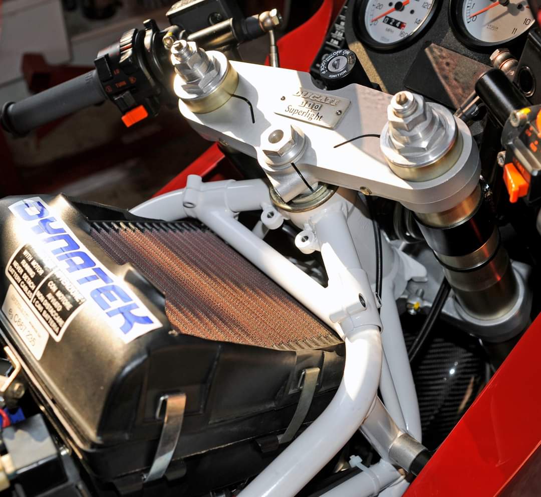

  4. The frame cracking was a serious problem with the 900ss, I think a welding mod was available to strengthen the frame. If you're going to keep the bike it's a must-do. All the oil on the engine looks like a cylinder head gasket has failed. Apart from that the bike is mostly awful, but bikes were that way in the 90's.

  5. I had two now with no cracking to the frame, I thinks it’s down to how they were treated in a previous life.
    Constantly popping wheelies certainly increases the probability.
    Now fork seals, that’s another story.

  7. I see that BBB have a frame reinforcing bracket that clamps on. I was considering getting one of them along with their hi level pipes and brackets. I hope 'mostly awful' is a typo.
  8. yes the clamp on bracket is good
    i believe some have welded a brace in before but you cannot remove or fit airbox hence clamp on brace
    think a few people on here have fitted them

  11. Mine has a BBB brace fitted, was on there when I bought it.
