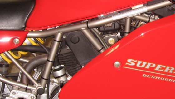

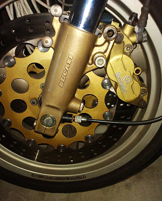

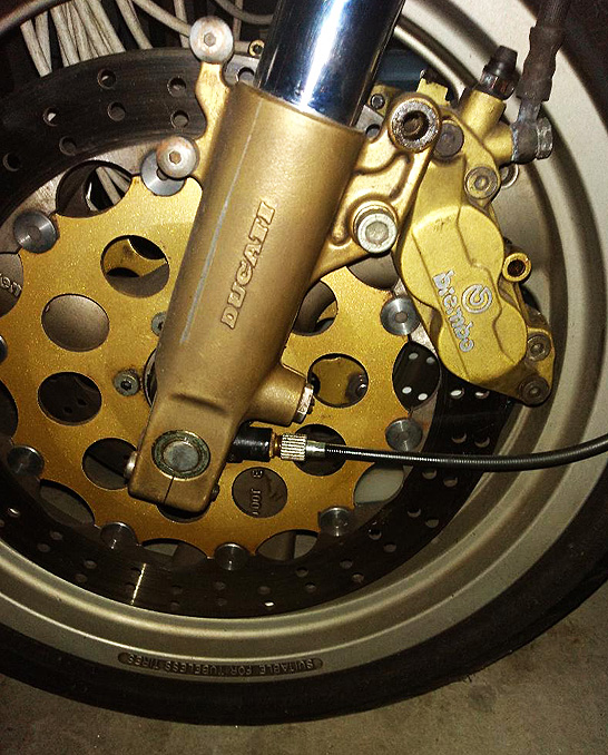

  3. It's a personal choice of course but I always thought the frame and wheels look "classier" in the dark silver colour rather than white or black. Just my opinion naturally. These pics show the colour of my frame & fork bottoms (wheels same as frame, kind of dark silver). Cheers

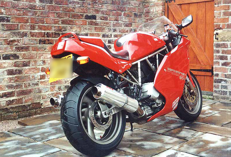

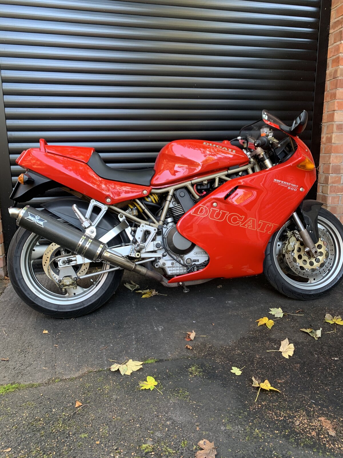

  7. Very nice. My 1994 UK model has different fairing decals and the rear caliper sits on top of the disc, other than that it seems pretty similar. I think the frame colour and wheels look the same as yours. I have some cheap (and loud, non road legal) 'ART' slip on cans but currently have the original Ducati cans fitted while I fettle the bike after a longish time off the road. Cheers Ducati.jpg

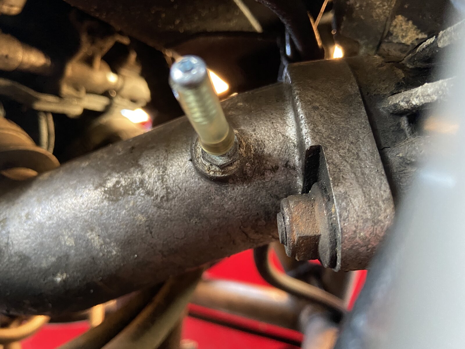

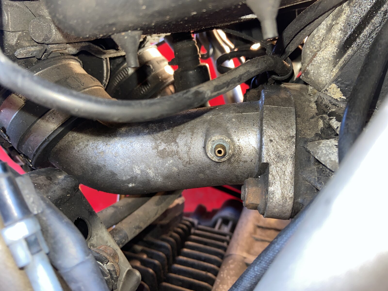

  17. So I blocked off the 'nipple' I removed the scottoiler pipe from using a small section of the pipe I removed with a small screw in it. All I have right now. Here's where the scottoiler was attached to:
    And how I have temporarily blocked it. This certainly seems to have stopped the popping/backfire. Anyone have suggestions for a better permanent solution?
    Is this a standard connection on the manifold or has a previous owner added it?
    On further inspection it appears I have two disconnected hoses under the carbs which look to just drain under the bike. I wonder where they used to connect?

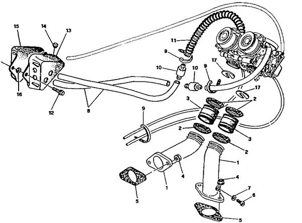

  18. check out stein dinse website for parts there diagrams are really useful for identifying where and what
    plus also useful as same diagrams as dealers use so when ordering parts makes it easy
    2 pipes could be overflow pipes from the float bowls they would go under the engine or there abouts
    as for the blanking plug a rubber cap is what is normally on such a thing as that
    something like these
    https://www.ebay.co.uk/itm/40282198...60lj8mYKJgCrSNr%2FXefSefGcUxbQhfqjEL13r6TzKQ0
  19. It is a standard hole in the pipe, that is normally blocked off. Obviously Scott oilers make use of the vacuum that this hole provides.
    The parts 6 & 7, are what you need. You just need to remove the pipe that looks like it has a nut holding it place (or part of the pipe fixing) and then blank off the hole with a washer and screw.
