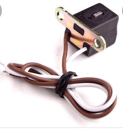

  4. One of these fellas? As said, might be the wiring if you’re lucky, I’ve used the Electrex unit many times and they’ve been reliable and worked as well as the originals.

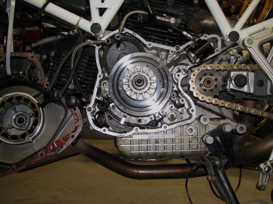

  5. I have an engine with the sidecover pulled off that still has the pickup coils. The resistance checked out on them, so I took a closer look to see how hard it would be to switch one out.
    I didn't see any way I'd be able to pull the wiring for the stock part let alone feed wiring from a new one back in. It was all or nothing if I wanted to replace anything outside of the cases. That means $200-$300 and who knows how long of a wait.
    But looking at the used one, I thought if the right side was the bad one I'd have room to splice it inside the case and not have to disturb the wiring running through the case seal. If it was the other one, things would get more crowded. But, as luck would have it, the bad one was the easier pickup to change out. Woo Hoo! I was about due for a win.
    No reason not to give it a shot, it's not like the stock part would be any more non-working if I screwed it up even more.
    So I pulled off the sidecover. I hate going backwards this late in the game but I had no choice.
    Notice the brown gasket on the sidecover. I'm not sure how it was attached to the cover but if the goal was to weld paper to aluminum, they did it. What a PITA to clean off. But anyway, that's how it looked before I started pulling the pickup out.
    And here's how it looked after the splicing in the "new" one.
    No different? That was the goal, I was happy with how it worked out. I checked to see if there was spark on that cylinder now. Vertical cylinder - spark. Horizontal cylinder - No spark. Son of a bitch. I thought I should check the resistance at the ignitor connector and remembered I never plugged it back in. Oops. Resistance was 99.5 ohms. Perfect. Plugged it in, turned the crank, Tah dah! Spark on horizontal cylinder.

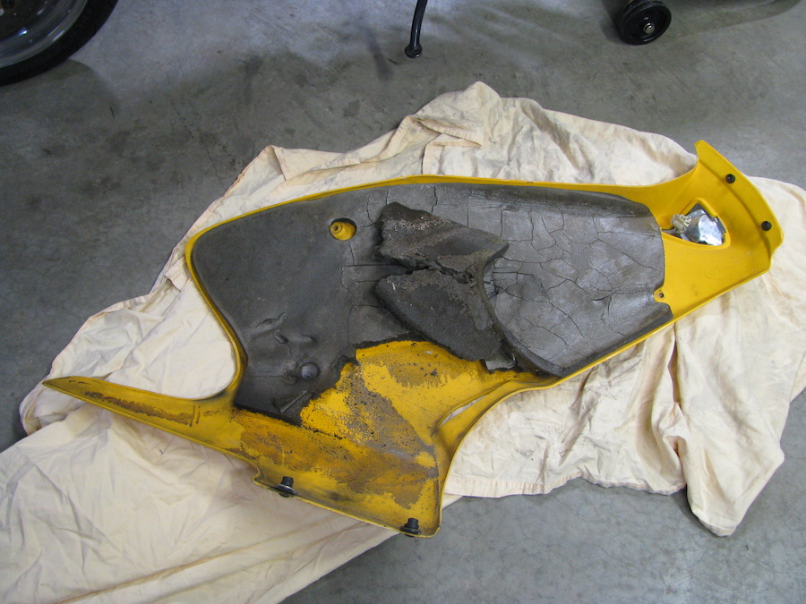

    This was probably one of the last Superlights in the US to still have the foam on the fairings, but it's too far gone and had to go. So what are guys using to clean off the crap left over when the foam is pulled off?

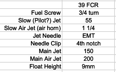

    Right now it's set up like this:
    This is different than what it was when I got it. I pulled the plugs back then and they were both black/rich, so I changed things... but not by THAT much. I got these initial settings from something Brad Black has on his site BTW, so it wasn't just a wild guess... but can I blame him for everything since it didn't run perfectly right off the bat? Yeah, that's it.. it's all Brad's fault! :D
    It's been a while since I've messed with carbs, but looking at another handy internet find it would seem the needles are the likely suspect here? But this is the most common size used in this application. Again I find it hard to believe they're that far off.
    Which all points to me screwing something up when I rebuilt the carbs I suppose.

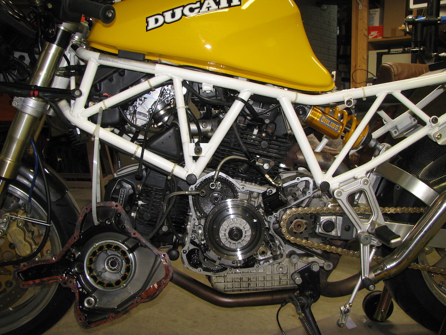

    So I have a plan. Back into the shop and drain the oil (again) and pull the sidecover (again) and screw with the timing (again, sort of).
    Since I'll have the cover off, and I bought a new bolt for my engine turing/degree wheel tool, I may as well dial the timing in as best I can. Just like I should have done when I had the cover off last time!

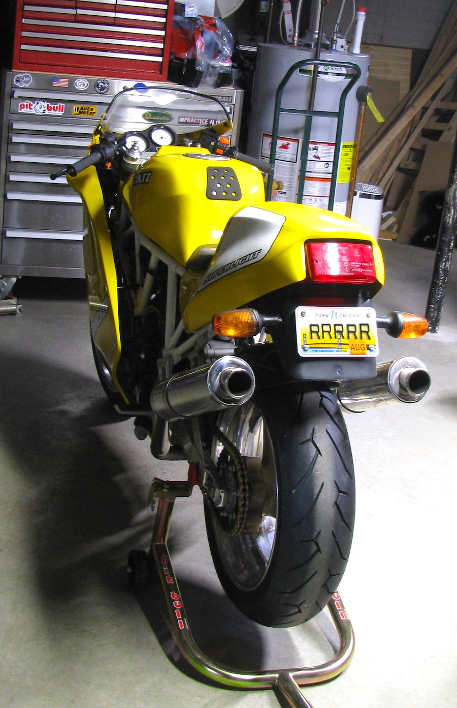

    And the obligatory picture. A buddy has an 888 that get's ridden even less often than my SL, but I convinced him to take it out late this season. This is from a break we took mid ride. He thinks the SL is much more comfortable than his 888. I think it's a better streetbike than my 851 was, so I'm feeling ok about selling the 851 to get it.
