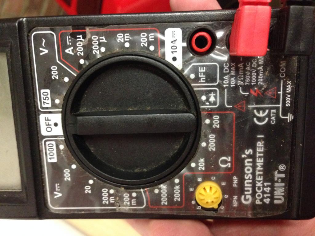

  2. Phil Set your multimeter to read AC volts in the appropriate range that will enable it to read the highest voltage that you should generate.
    for example: 0 to 250v if you could take a photo of your multimeter and post it up here I could advice you how to set it!
    Yes, across yellow and yellow.
  3. Here it is, sorry iPhone having a mo!
  4. Phil Just turn the knob 2 clicks anti-clockwise, so that it's set to read from 0 to 200 volts.
    It's a Digital meter, so what you will inevitably see is a constant flurry of numbers as the meter try's to display something that is quickly changing. Not the best meter for this task, but it should suffice to give an indication that the voltage is increasing up to it's maximum level in a linear fashion.
    Best meter to use for this kind of task is non -digital meter,doesn't need to be an expensive on either, you can find one for less that a fiver that will be o.k .
  5. Did you spot the deliberate error , Just to see how on the ball you were.:wink:
    Turn the knob 2 clicks clockwise, so as it's set to read ~ ac volts, the other direction ,2 clicks anti-clock wise would be to read dc volts.
  6. Yep, I did wonder! Haha thanks for that, I thought it was there and we had it set there but were measuring from each yellow charging wire to the battery so not the correct task. We are going to try as u have mentioned on Friday with the alternator leads disconnected and see what output we get, if it's correct we will look at reg/rec.
