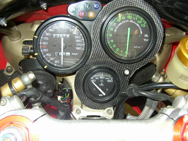

  1. gives more info than a charge light and peace of mind. Steve
