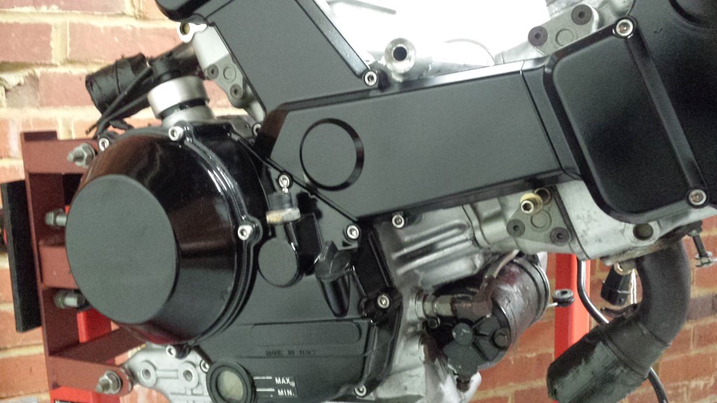

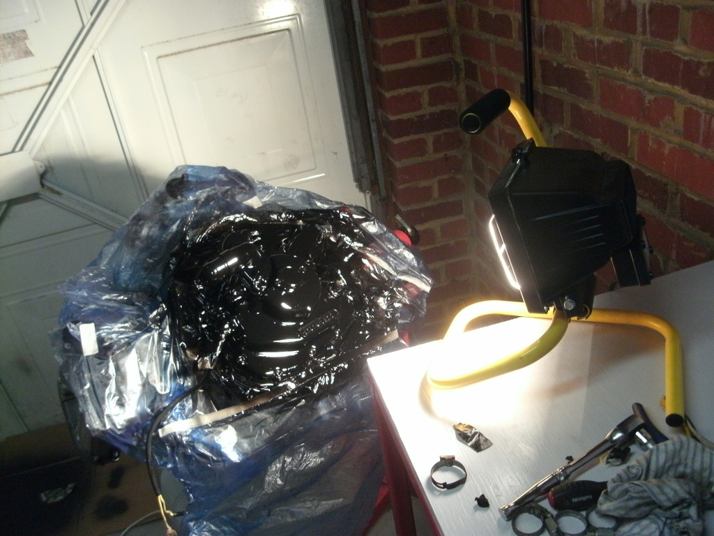

  3. I did start to mask off the areas for spraying but I was having a bit of a nightmare so decided to paint the engine by hand.
    Massively impressed with the results.
    This is what i used.
    This is how it came out like.
    Thoughts?[/QUOTE]
    Hi Jamiej
    You’ve done a great job with the engine refurb, fair play!
    I’m currently undergoing the very same project on my 748; hoping to start prepping for paint very soon. What was the ETECH Engine paint you used like? How much did you use in the end? Did brushing the paint on give an even finish?
    Any advice you can give from your experience would be very much appreciated.
    Thanks
    Rob
  4. Rob,
    The e-tech paint was great, and gave a good finish. Not as good as a rattle can, but less waste and much easier.
    I have noticed some paint lift from masking tape so I am going to give it another coat and then cure with a heat gun. I have bought some more e-tech in black to do the parts I cannot spray.
    Didn't end up using much at all. I would imagine a tin will be sufficient.

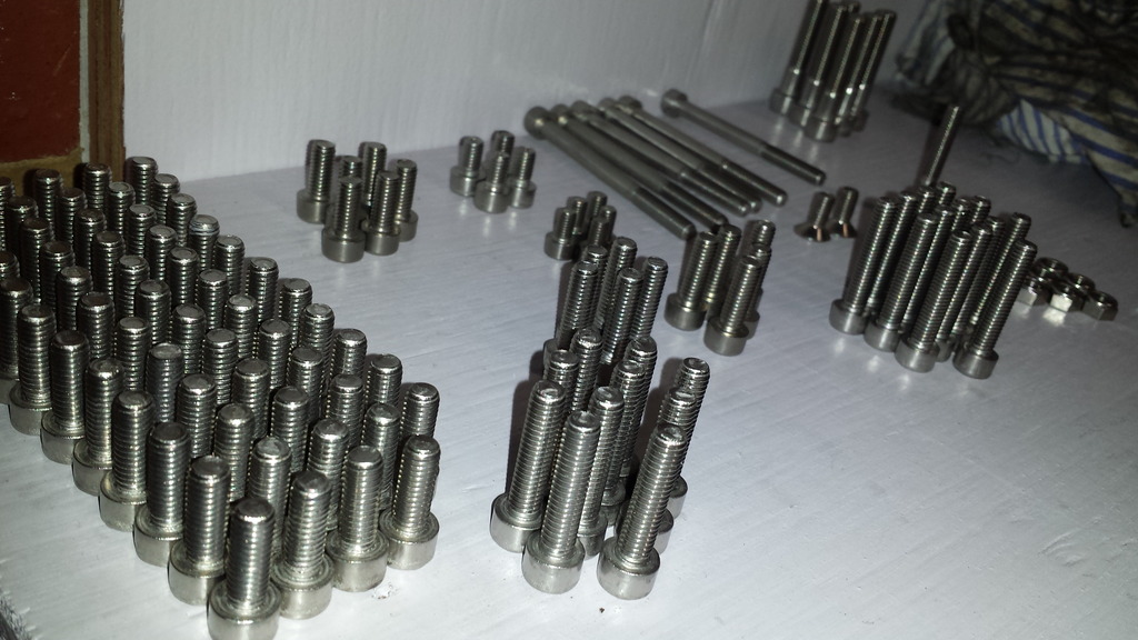

  6. Some more painting today and bolt replacement.
    Bolts are from Stig Fasteners (bought via ebay in the end as slightly cheaper)
    All the covers now back in place.
    My painting rig!
    Found these amongst the parts, looks like my dad has many of the fasteners freshly plated
    Need to purchase the gaskets for the side covers, then I think I can say that the engine is pretty much there apart from some small tidying.

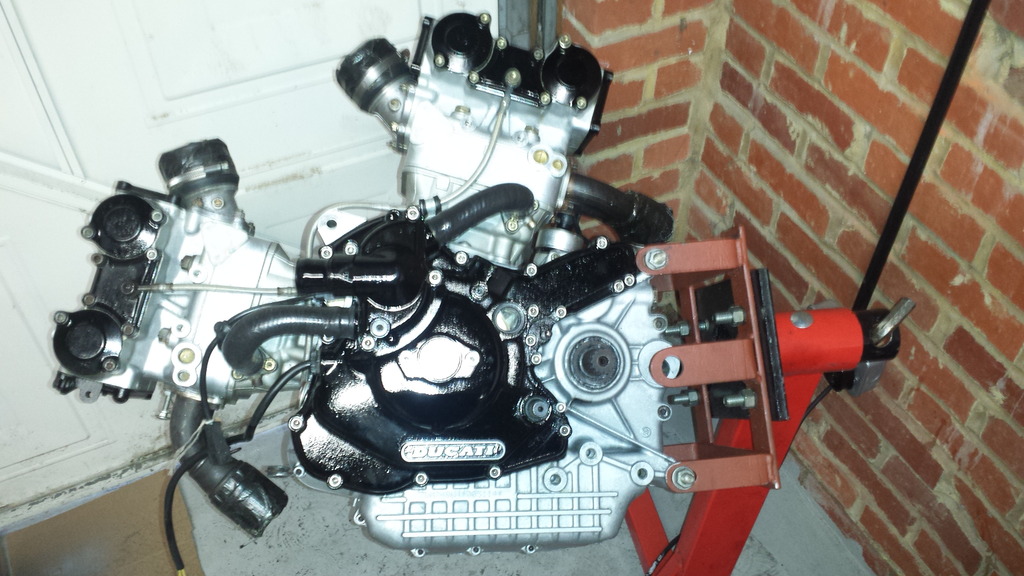

  10. Some better photos of the engine.
    [​IMG][​IMG][​IMG]
  11. Washhand,
    Thanks for your comments. I'll have a look into this and see how I get on.
  12. Much easier to check the valve clearances with the engine out, especially the rear cylinder exhaust.
    Looking good. :upyeah:

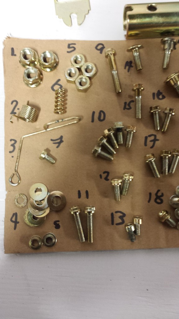

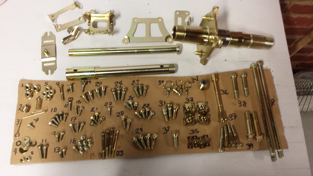

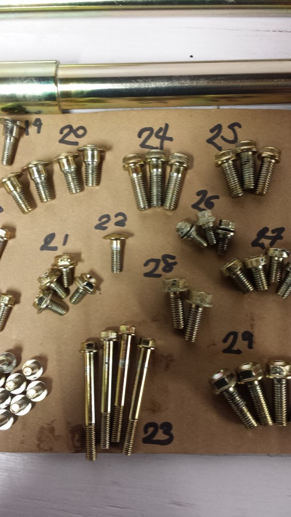

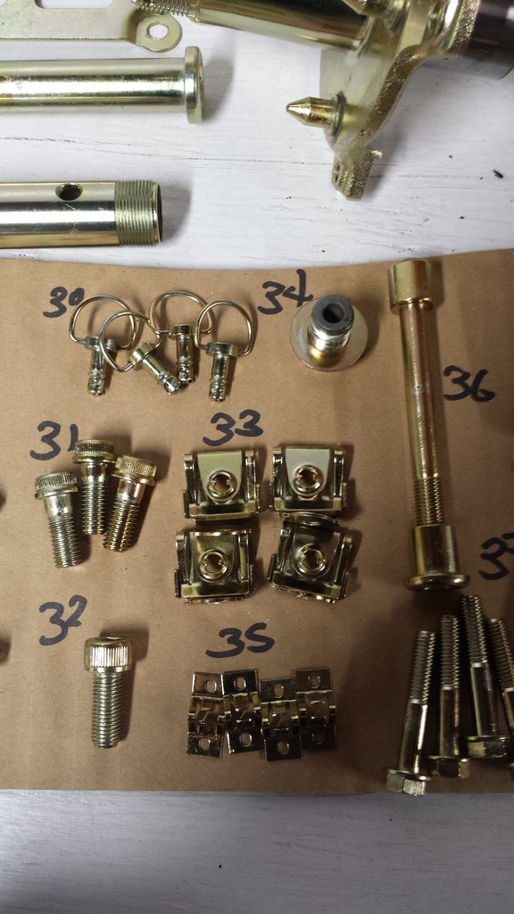

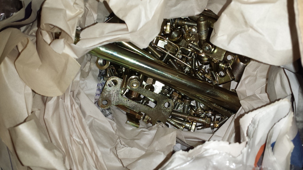

  17. Hi all,
    Purchased the belts from Exige, the distributor for CA Cycleworks, excellent item and super rapid delivery. Would recommend!
    Assembly starting soon!
    Wheels are with the local bike shop to remove the tyres and front bearing ready for painting.
    Has a good look at the box of bolts and fixings, see below picture. There were all separately sorted and labelled by my dad but the plater mixed them all up :(
    Any one lend any help as to what may go where. I'm sure it will start to come together once the bike is being constructed, but any help would be greatly appreciated!
    Thanks all,
    Jamie
  18. Looks like virtually every part of the bike?!, which is going to be difficult to sort out without a comparison. The dzus fasteners for example you don't have enough of for the full fairing as you only have some of the side fasteners and not the rest nor the under belly, you need four more, it seems.
    Do the bolts that have been replated include the engine as well?
    Some parts you can figure out using the original Ducati workshop manual others will be more difficult. It also looks like you may have some parts missing. You seem to have two front seat hinge plates when only one is used.
    I have an engine on a stand and I can measure each bolt for you if that helps, that will then leave the rest as being frame bolts assumedly, but it does look like you have certain bolts missing, it's hard to tell size from just the photos in isolation.
    To be fully certain of what goes where you really need a fully completed bike to compare bolt lengths to, I think it might take some time to work through it all. Go through each part and PM me when you want to know a specific bolt and I can check no doubt against one of the several bikes I have in my workshop.
    It's hard to tell from your photos as they won't increase in size on my PC, I am sure we can get there though.
